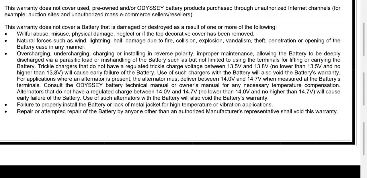

You do not have to do anything to run an Odyssey. Just put it in and drive it. I talked to Odyssey about this concern on the forum and posted this info in another thread. Odyssey said there has never been a problem with 4runners and the lower voltage would not be a warranty issue. I am going on 2 years on my Odyssey with no modifications and it works great.
False. Read your warranty and specs, the factory charging system will void your warranty because the voltage is too low.
Odyssey requires 14.0 to 14.7V, the factory charging system is not sufficient for an AGM battery, the voltage is too low.

I have two 4Runner both have odyssey batteries. Both work great and have for two years. Buy and don’t look back. People that complain don’t own them. Real experience wins on this one.
A lead battery, AGM or other, will slowly sulfate internally if you can’t provide it with the correct charge voltages. It’s a slow death and you might not notice it is happening at all.
If you actually capacity test your battery, as in run the cell from 100% to 0% state of charge by voltage and measure power out consumed, you would basically see a greater loss of capacity over time vs a unit that was maintained correctly. Both will have capacity loss, but one will be at an expedited rate.
In addition to the capacity loss, it's ability to delivery higher currents will also be reduced.
It will continue to degrade and its ability to hold a charge will reduce. Ultimately forcing you to remove it from service. By that time, its ready to replace and probably too far gone to recover properly. At the end of the day, all you are doing is reducing its potential service life. It just wont last as long as one that was maintained correctly.
Actually, Enersys says otherwise. [MENTION=336]03_4x4Runner[/MENTION] talked to them and I have my info from them in writing from last week.
The fine print on everything is normally made to make things look scarier than they are in order to prevent abuse. Write them an email and see what they say for yourself.
