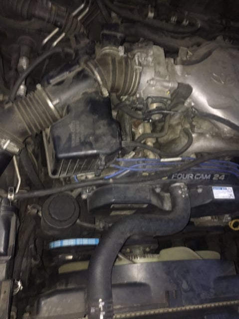

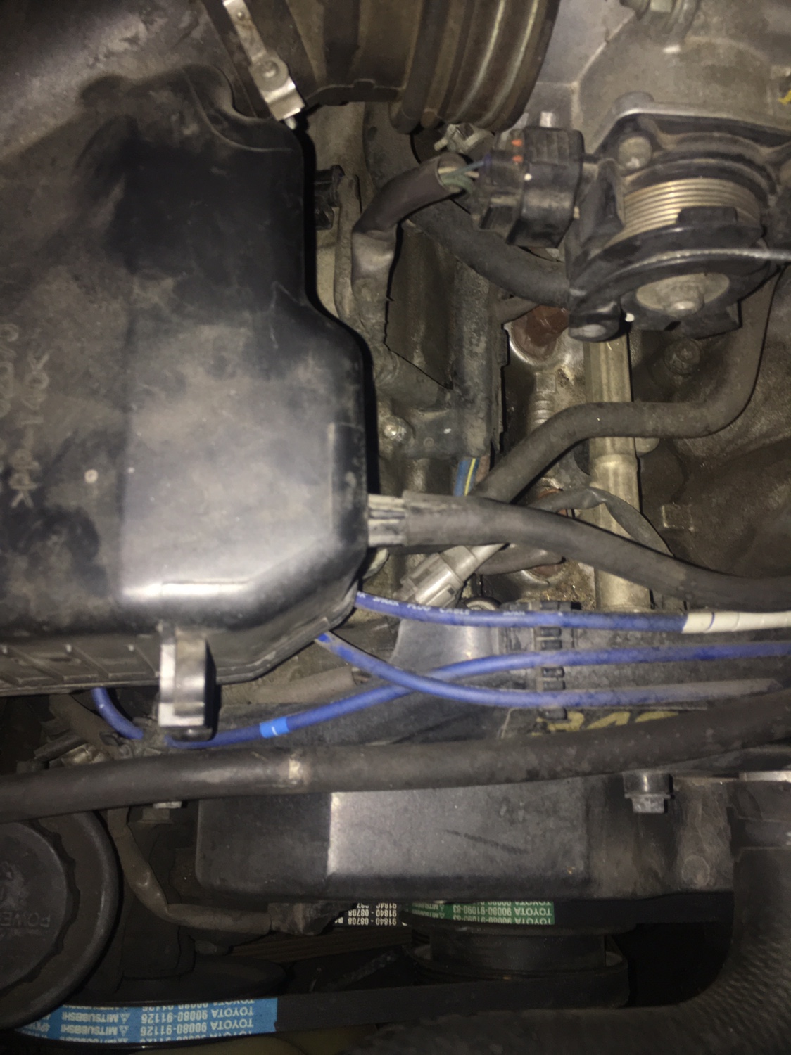

I guess that info is useful. I have a 2002 SR5 4wd.
Here are the pictures.

Your right that part is expensive for a hose. Searched for it on camelback Toyota and dallas Toyota parts. Wish there was a picture or diagram to confirm it is the correct part. The description just says hose. You can see my pictures posted above and maybe you can tell me if we are referring to the same part?

Wrong part. I gave you the part number for the hose that goes from the charcoal canister to the airbox. From the pix, you are referring to the hose that goes from one of the intake resonators to the fuel pressure regulator, PN 17343-62110
