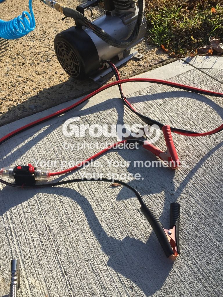

UPDATE
Extended the wires with 8 gauge wire. It worked out perfect because the wires I got of eBay were already glued together.
I then wired in a 50amp breaker.
And installed my own battery clips.
I believe everything was like $10-15
I kept the breaker closer to battery.

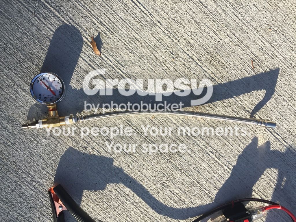

Right here I made own open air chuck. Got a free ARB tire pressure gauge thing. But it had a lever to release the air so no good for me. I took the hose of ( open air chuck) went to Home Depot got a gauge, and few adaptors to make everything work. Actually works good. Even the gauge. Only thing is the gauge is little of when pumping but I have a digital one to double check where I am on PSI. With the compressor running and open air chuck hooked up. The gauge is a hair line above 0. So no pressure is being built up.
