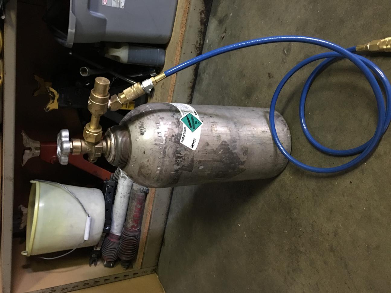

^This. I had a compressor setup and it took what seemed like forever to air up at the end of the run. So much so that Kevin [MENTION=119761]RedRun85[/MENTION] took pity on me and hooked me up with a CO2 tank. I got a fixed regulator and high-quality hose from Wheelers Offroad for around $75 . It's about $27 to exchange tanks at the local Airgas. If you're cool with them they'll hook u up with an aluminum tank if possible. Airgas has stores fkn everywhere so pretty sure u pass by one now.
WTF That's for a kegerator man. haha find a brewery supply and the refill should be closer to $10. They will do it in a couple of minutes.
This one is local to me.
If you want to get your own tank filled, stop in our store and we will fill it while you wait. Takes less than 5 minutes. We fill CO2 for beverage, hydroponic, and other uses.
Don't u know anything? :naughty: Kegerators were standard equipment on '88 4Runner XTEPKPXYZ Editions. :biggrin1:
Thanks for the tip on the cheaper refill source Chris. Maybe I'll just hang on to this aluminum tank.
Just make sure you weigh your tank before/after getting it filled at a brewery place. I was shorted big time once and just started going back to airgas.
