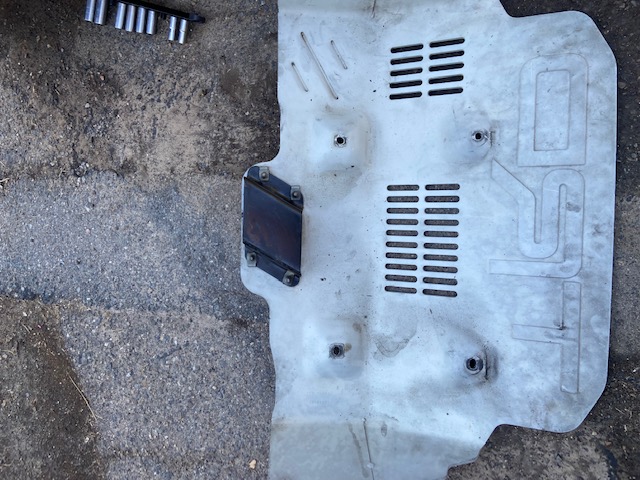

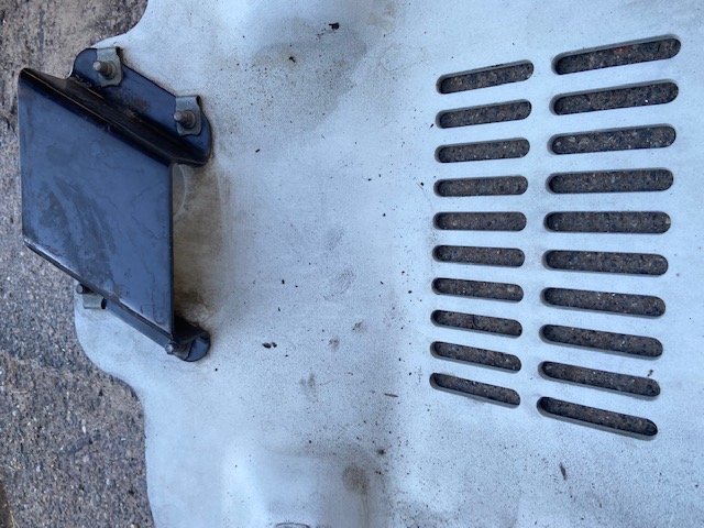

I believe it is to get more air forced to the skid plate's vents, but honestly it probably doesn't make a huge difference. Mine held up to some good scrapes, was impressed it didn't crack or rip away. I pulled it off when I removed the lower plastic valance, so the skid is more exposed now anyway.
For aftermarket skids, the RCI non-KDSS has four holes cutout for this purpose (or may just for weigh savings), and of course the TRD skid has slits cutout where the lame one has the two vent holes.
Pics of ducting on my TRD skid plate:
