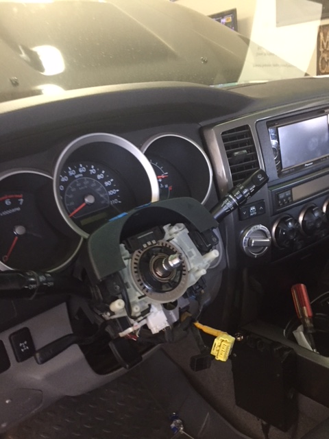

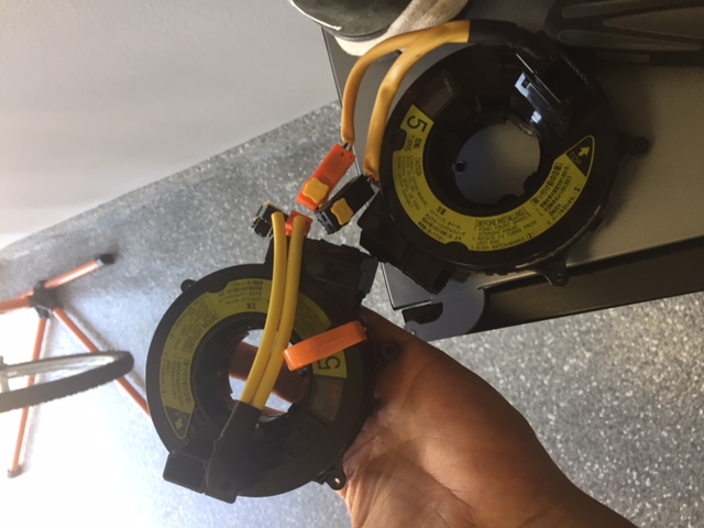

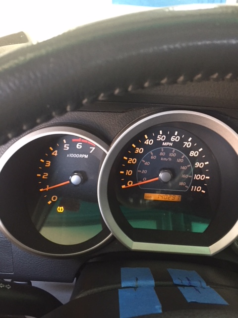

Bring this thread back to life. It happened to my 06 4runner. The dealer charged $135 for diagnostic cost. It came back with code B1181 (Open in D Squib (2nd step) Circuit. I did a "paper clip" tested before I took it to the dealer and suspected the same thing. I paid $130 for the dealer to confirm the problem before I spend $300 for the part. They wanted $750 (included $130 diagnostic fee) to replace the spiral cable.
I replaced the spiral cable. The dealer wanted $720 (part and labor) to replace it. I ordered the part for $220 and 45 min of work. It was very easy. Just follow the instruction (on youtube) carefully. I give it a 6 on the scale 1-10.
