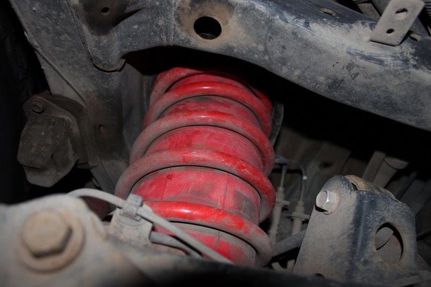

If you look at the info J.A. posted you can see the installed bags.
I grabbed one of his pics as a reference.
You can see how the bag is not touching the cut-off bump-stop.
I didn't like that, to me it feels like as the suspension compresses and hits the bags, it kicks/rebounds off the bags. Making it bouncy.
With the bags filling the coil it reduced that sensation...slightly.

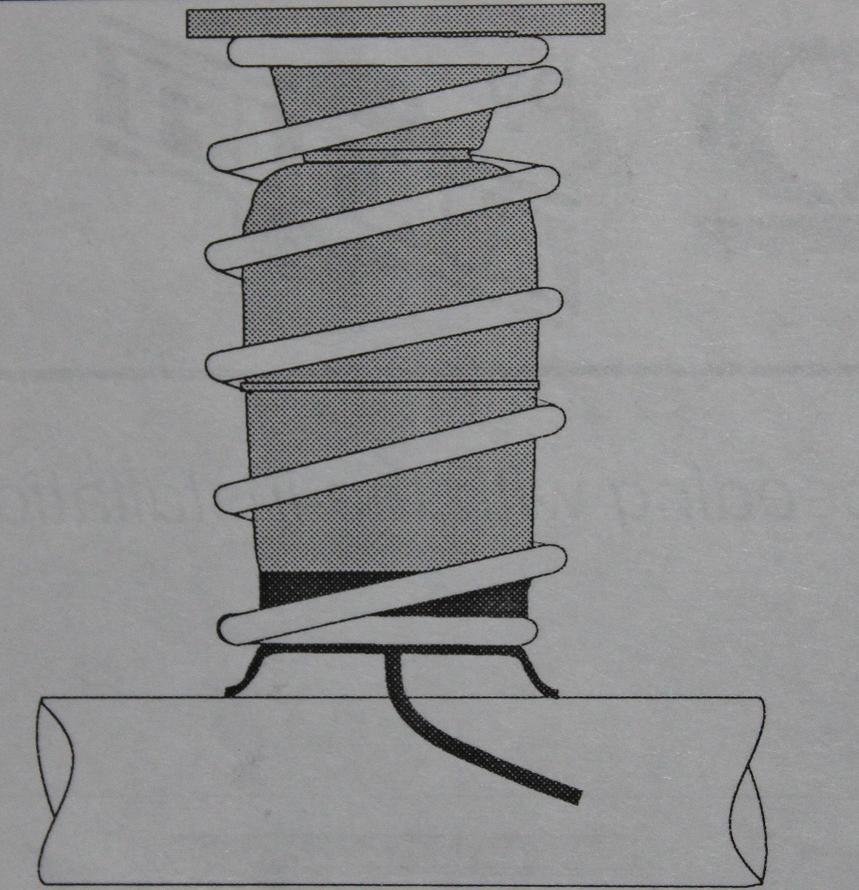

I was calling it the bump-stop, but the proper term would be 'coil-isolator' I guess.
In the directions it shows the isolator cut off at the top notch (of 3)...like J.A. shows.
In my kit it had a rubber puck that the bag sits on, between the axle and bag.
Also shows it in the directions I have. (pic 1) That's the only difference I see.

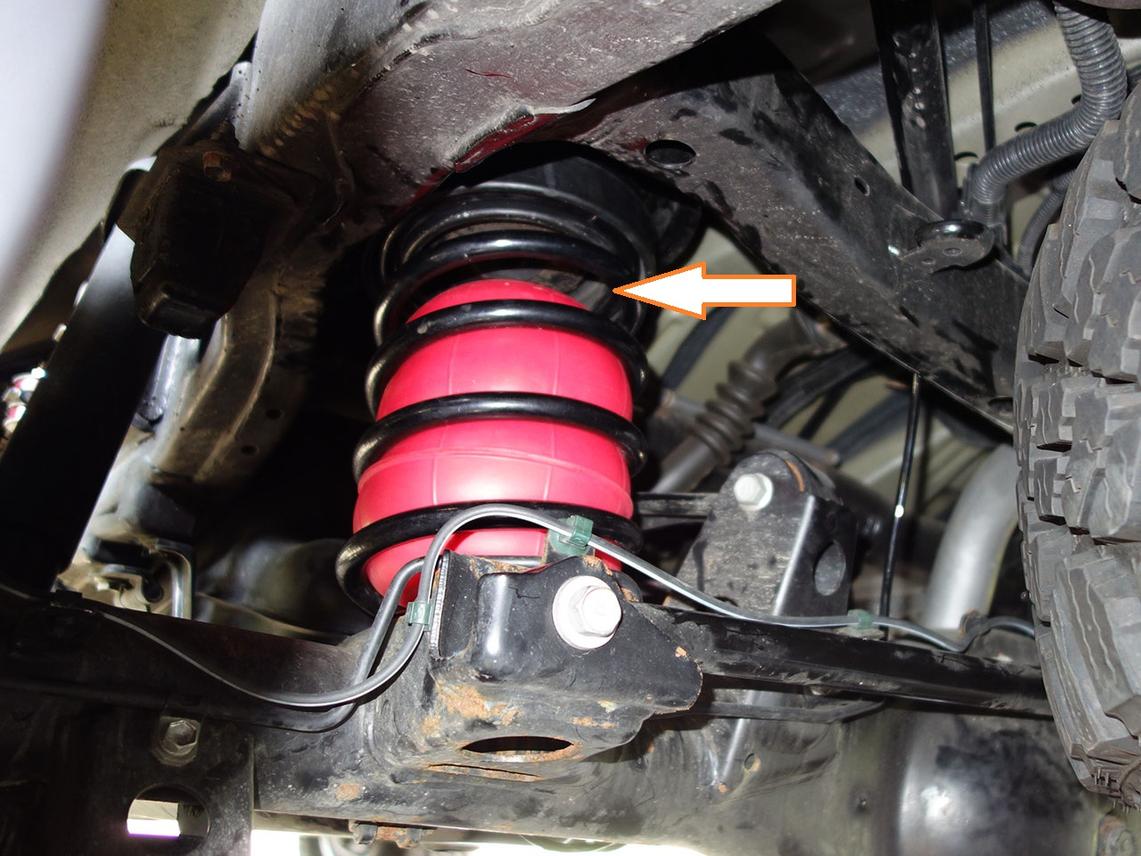

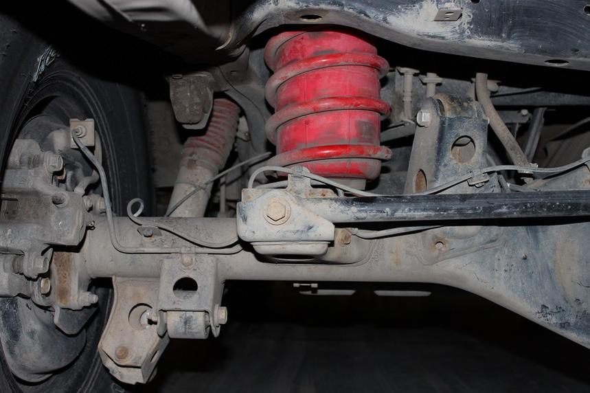

I did away with the isolator altogether, topped the coil with a 1/4" UHMW plastic disc that I cut out of a sheet to fit. (between the coils and the upper body mount). Then stuffed a bag in that filled the coil, after measuring the coil length. (pic 2 & 3)

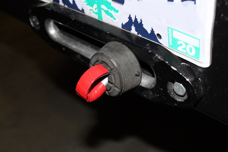

The bottom of the coil isolator also made a nice winch cable stop. (pic 4)
