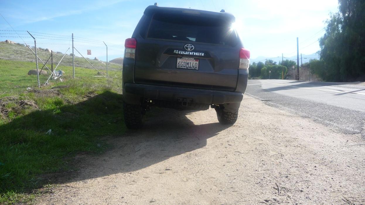

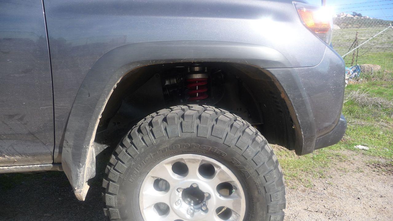

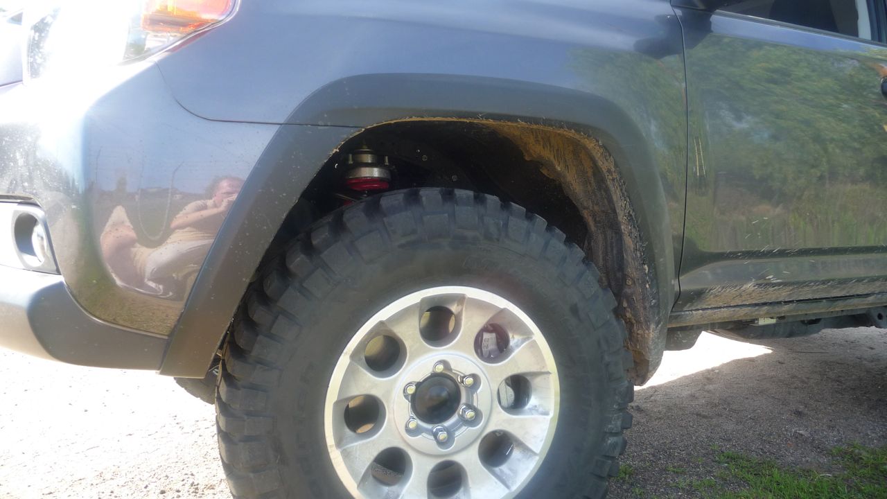

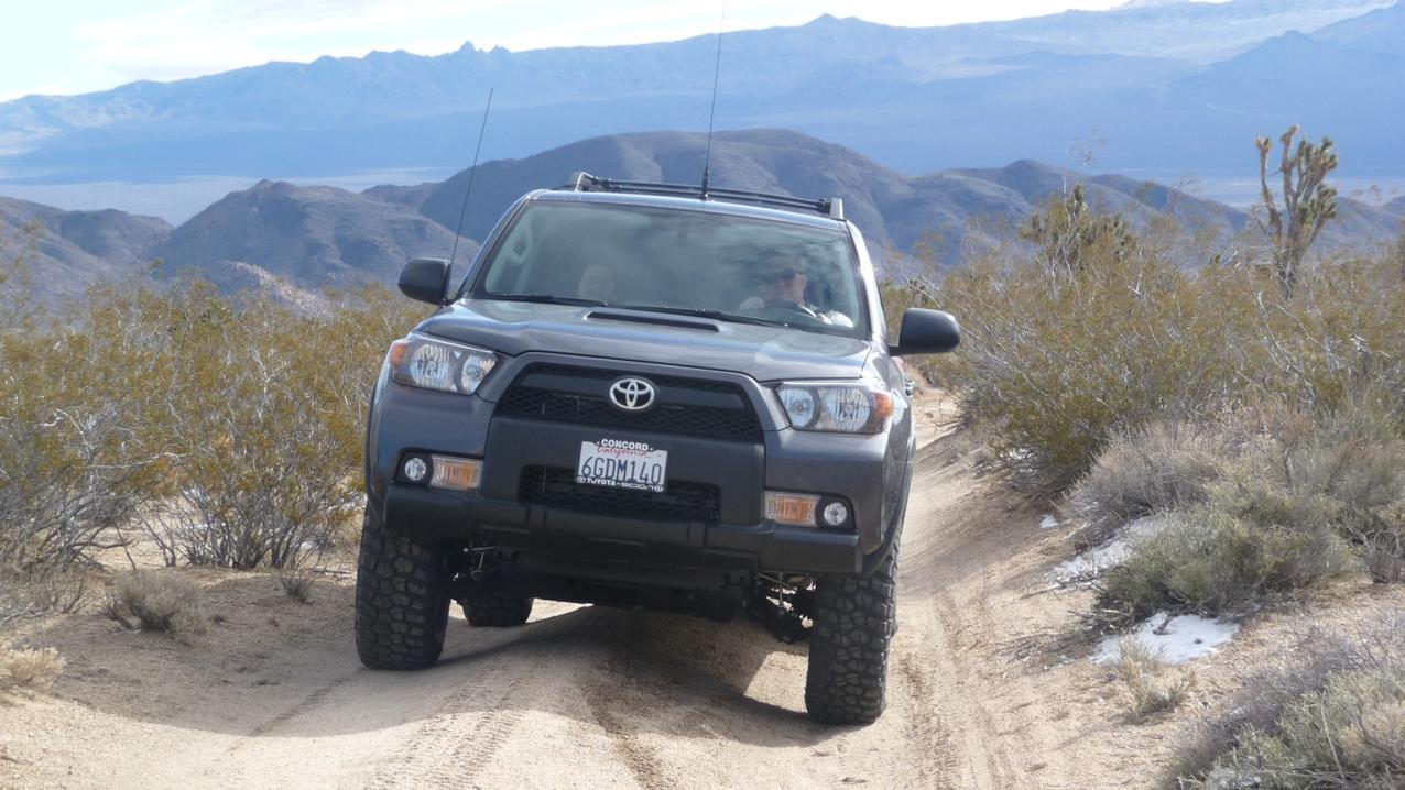

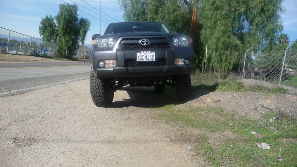

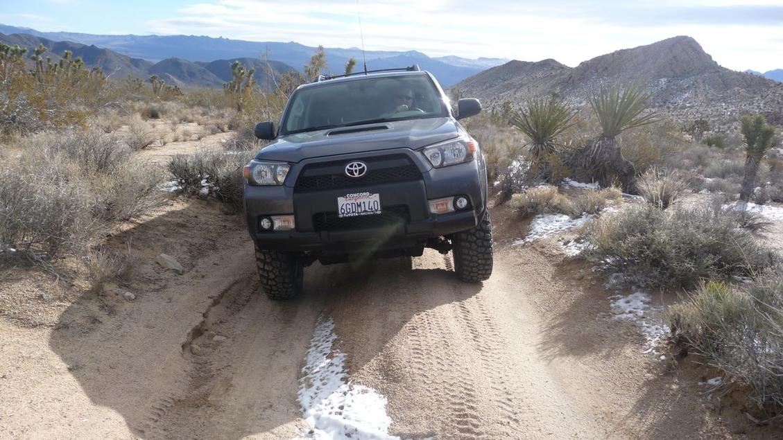

Drove the truck up a bit of dirt I use for testing. Pleased to say suspension compresses and extends as I'd hoped. This is before I've had the oil replaced so still has air in the system right now.

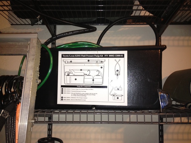

I actually went and bought the original Toyota KDSS hydraulic pump kit!! Amazingly it does not have the correct fitting for the 4Runner either...the hoses are for the Lexus.

I am very pleased to say that a technical services guy for SPX based at Toyota HQ contacted me today to talk about my connection problem. Sent some pics and had a few chats on the phone.
Long story short......turns out that I'm an idiot and the quick connect does actually fit....just not the way I was trying. I just have to ignore the Lexus part of the setup.

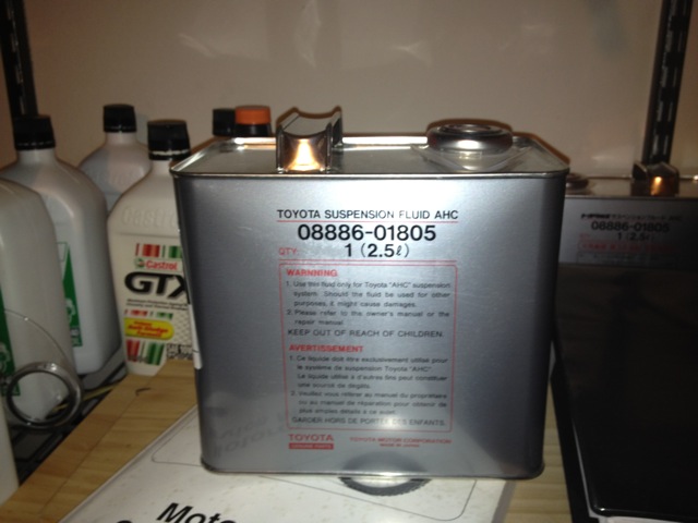

Now I'm good to go once my hydraulic fluid arrives next month :bigok:

So sorry to hear that. It cost me around $1000 in the end to get it done myself. The funny thing is I found out later that all the Toyota dealers actually do have the pump....they just don't realize what they've got!!
The pump is a crazy $2500 but I was super lucky and found one new on Ebay for $300. I then had to buy a 30 gallon air compressor to run it and of course get the oil. Had to do a special order for that and it took about 4 weeks.
I tried Lexus myself but they refused to work on a Toyota. Hope you have better luck than I did.

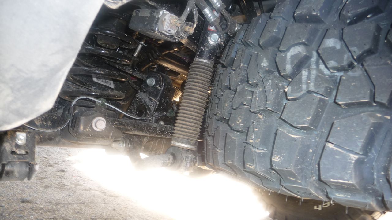

If you try your Toyota dealer again show them these pics. The pump is in the box and most dealers have never opened it.

Just realized I never updated this thread with the final solution. The connectors were correct on the pump....it was me just being a dumb ass and not understanding how it clipped on. Toyota HQ (that's how far I went with this) put me in touch with the designer of the pump and he put me straight.
