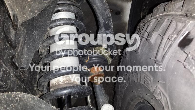

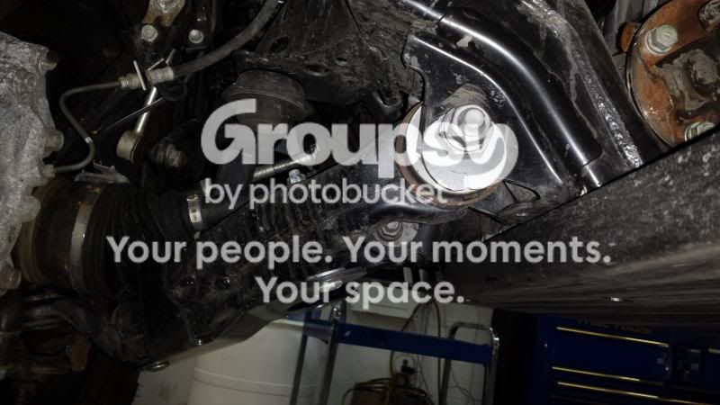

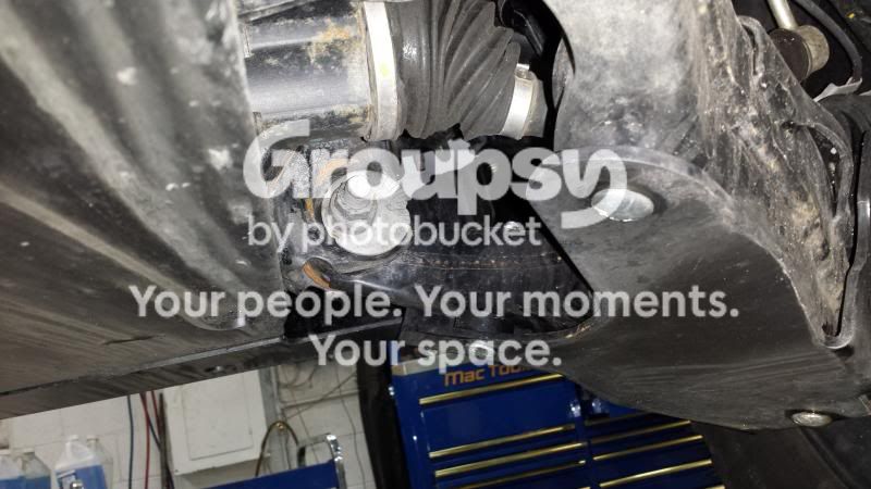

So here are the pictures. Some of this may be acceptable to some people; To me its not.
They had the ball joints rotated back one notch, and while this got the caster correct it caused the tires to rub the fender in the rear(BMC done)

This is a huge peeve of mine, while not technically wrong, I hate when the cams are rotated down as it makes it very easy to catch on a rock and knock the alignment out or bend the cam.
2014-01-06093108_zpsfd87cb0a.jpg~original
This is just flat out poor workmanship, They rotated the cam over top of the tab and flattened it out when they tightened it down.
2014-01-06093052_zps09f53257.jpg~original

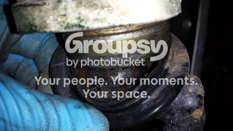

And here is the ball joint that is only a few months old, most of the water had run out when i took the picture. The boot retaining ring was missing allowing the water to get inside the ball joint. The ball joint had about 1/4" of play.
