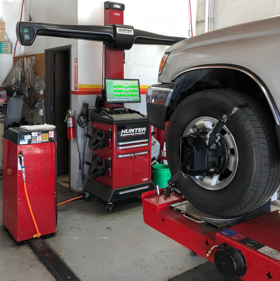

I did ask about lifted/modified trucks, and he said no problem, he works on them a lot. Im no expert, but the Hunter Hawkeye Elite setup impressed me. The wheel adapters dont even touch your wheels with metal (No scratching), takes real time tire psi and can adjust as well. Pretty cool.

Yep, that rack and alignment machine is tits. Those camera systems are just about idiot proof as far as getting reliable readings. But you still have to know how to decipher the readings once you get them. Hell, that machine will probably even decipher the readings for you and tell you what to look for if it sees a certain angle out of whack. I used to work on alignment machines (and all other garage equipment) a long time ago and the software they were developing was certainly headed that way.
Glad you got it worked it though and found a knowledgeable tech. I read WAY more horror stories on this site when it come to alignments and reading a happy ending is nice.

Well since I no longer work for JBC, I can say that IS a good system, not the best but plenty good. I am still wondering about the SAI and IA which he did not get readings for on this report. But if he got good camber and caster you wouldn't notice a 1 degree drop in SAI, so it's all good.
