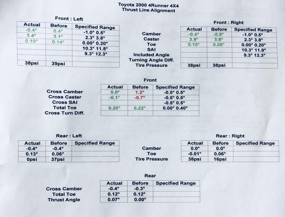

Alignment issue help. Pulling to right but alignment OK

While I agree with what you said, if you look at the before and after readings toe is unchanged which is why I said that it looks like they did nothing.

You pull to the right because the right side is more positive(top leans out) by 1.6 degrees.

Well straight up they didn't align it properly. Look at those camber readings, terrible. He only messed with the front because the rear has no adjustment. I would take it back and tell them it's still not right.

Bingo. Also the rear should have numbers. Especially the thrust angle. Hell at this point they couldn't even tell you if the rear axle was centered properly.

im a happy camper now. Fremont Alignment did a wonderful job. Michael was awesome and fixed the other shops screw up in 10 minutes before dialing other things in. It's obvious now, but the other shop only touched the lower control arm bolts. Here's the print out and the truck is tracking just right and no more fighting the wheel.
That's great. Damn. He dialed that thing right in. Even have a little more caster on the right for road crown. Pretty much a perfect alignment. Make sure you get the guys name and if you need it aligned again, you can get the same guy.
