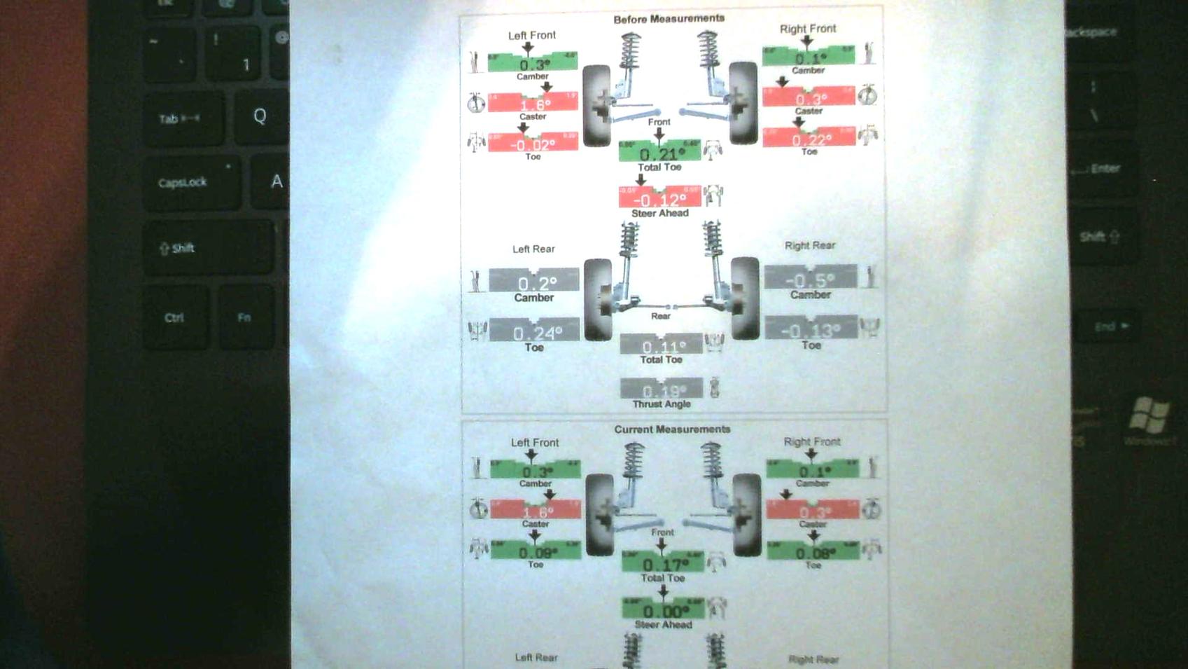

after 4 tries this is close as i can get

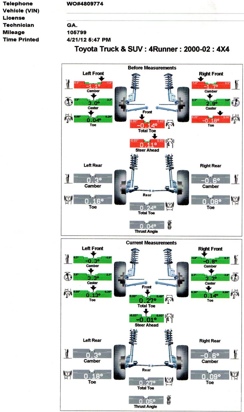

Here's mine...I'm at 22 1/4" in the rear and 22 7/8 in front from hub to fender. This is approx. 2 inched higher for me than stock was.
Alignment4-23-12001.jpg~original
This was done yesterday after the installation of the adjustable upper control arms. With the upper ball joints set in the 0 position, which adds 2 degrees of caster.
2001, 3" OME lift all around with the top plate spacers in the front. My front now sits about 3/4" higher than the rear after the control arm installation. Must have freed up some bindage and I may pull the spacers out.

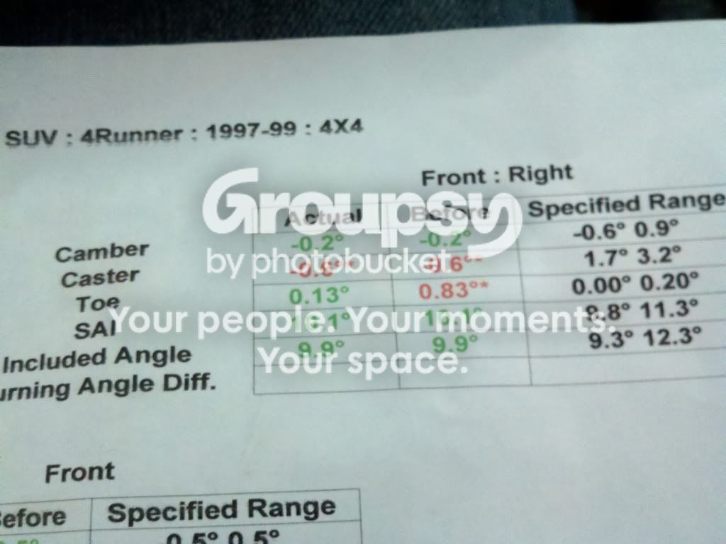

I know I'm bringing this back from the dead but does anyone else have any input on this. After several tries the guys at sears can't get me anymore caster. It drives straight enough but more caster would be better.
2013-02-27_21-48-54_377_zps3a74813c.jpg~original
Any recommendations?
[MENTION=84643]JBurt[/MENTION] are you lifted on stock upper control arms? The only way to add in more caster is to go to an aftermarket upper with caster built into it(Icon, Camburg, All Pro) or that allow adjustment(Light Racing). Or you could lower your lift and get some caster back that way.

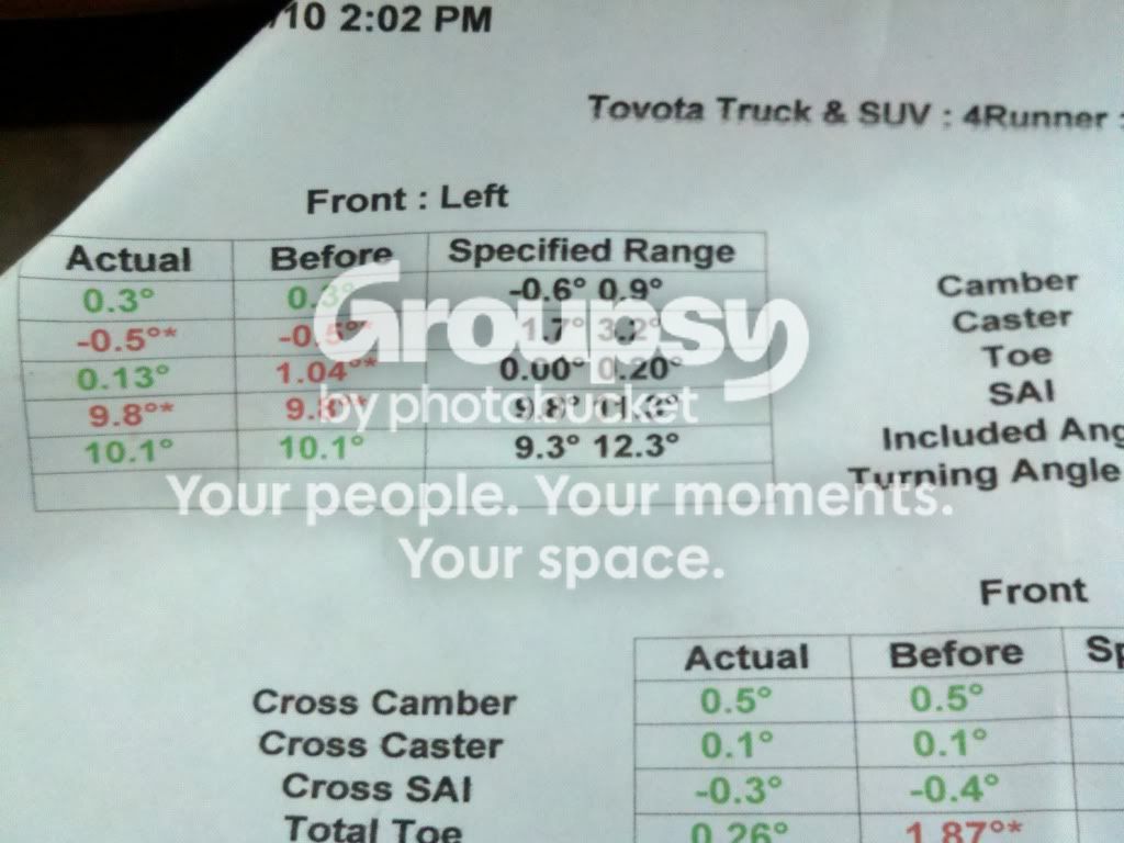

Here is mine. First alignment after adding SS1.2 lift, new lower toyota arms, new upper light racing arms, new ball joints and new steering rack and tie rods.
I'm running stock UCA's. After more research it sounds like I'll wind up getting some kind of aftermarket ones. I know light racing are adjustable, but are others (toytec, camburg, etc.) that are non adjustable giving better caster?
Okay well that narrows down what the issue is, the non adjustable arms are all built with 2* of positive caster to help you get back to spec.
I have on recommendation that is possible. This is from experience with personally doing alignments on these vehicles. When actually making the adjustments, the caster on these vehicles goes in the opposite direction of what it will actually be when it sweeps. If an inexperienced tech doesn't notice this, they will do the sweep and think they have the caster maxed out, when actually it's at its minimum. I hope I explained it in such a way that it's understandable. Anyone else wanna chime in on it?

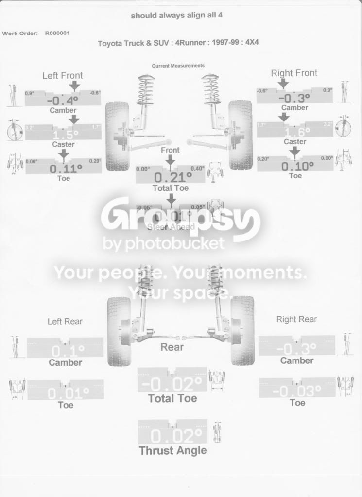

Here's mine after doing LBJs, ITREs, OTREs and tires.
