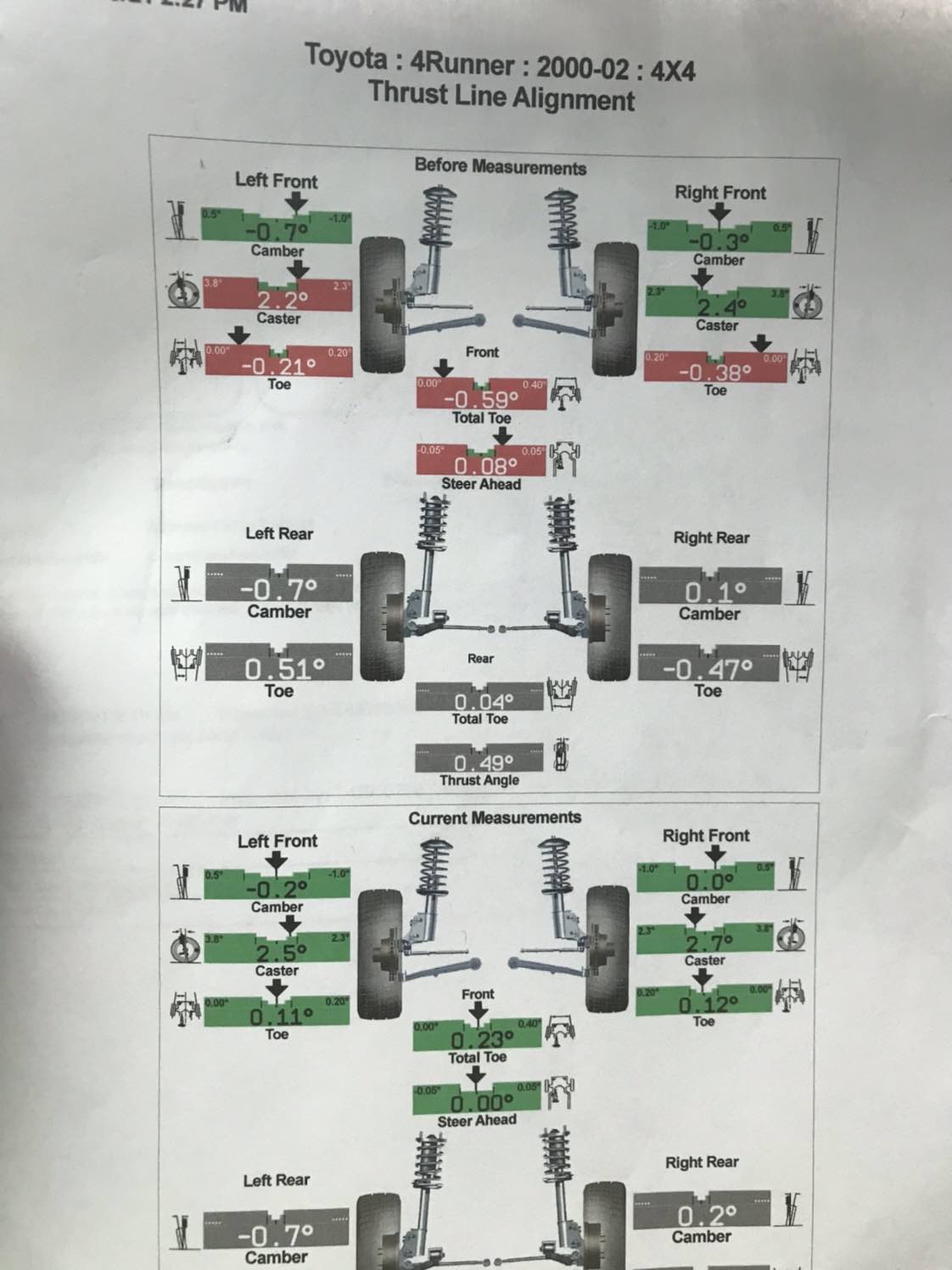

This sheet is after SPC UCAs. I've started a thread on this before I found this. My problem is I'm rubbing on the back of the wheel well more now then when I was before. Do I need to jack my Caster all the way up? I don't see too many people needing to do that....
20160712_181019_zpsug6prwwx.jpg~original
...come to think about it, we started in the "D" position on the UCAs, and he did all the adjusting down below... He pulled all the caster out to get it back into spec. Where he should've zeroed out the ones down below and adjusted to get the caster on the UCAs. (just thinking out loud here.....)
Make sure the steering wheel is straight also. Everywhere I've gone the wheel comes out crooked. I have to go back to Toyota for them to correct it, although the specs are good.
If you feel like getting under the truck, you can always just do this yourself by turning each ITRE the same exact amount of turns in opposite directions. I.e. lengthen the driver side by 1/4 turn and shorten the passenger side by 1/4 turn.
This will center your steering wheel without affecting toe.
Should I be worried about the caster being .2* out of spec? Anything else look off or am I good. This is stock UCA with 3" toytec boss lift.
Not at all. Thats a good amount of caster for stock UCA's. You will be fine. I have ran from 1*-5.5* front caster and found not much difference between 1-5*.

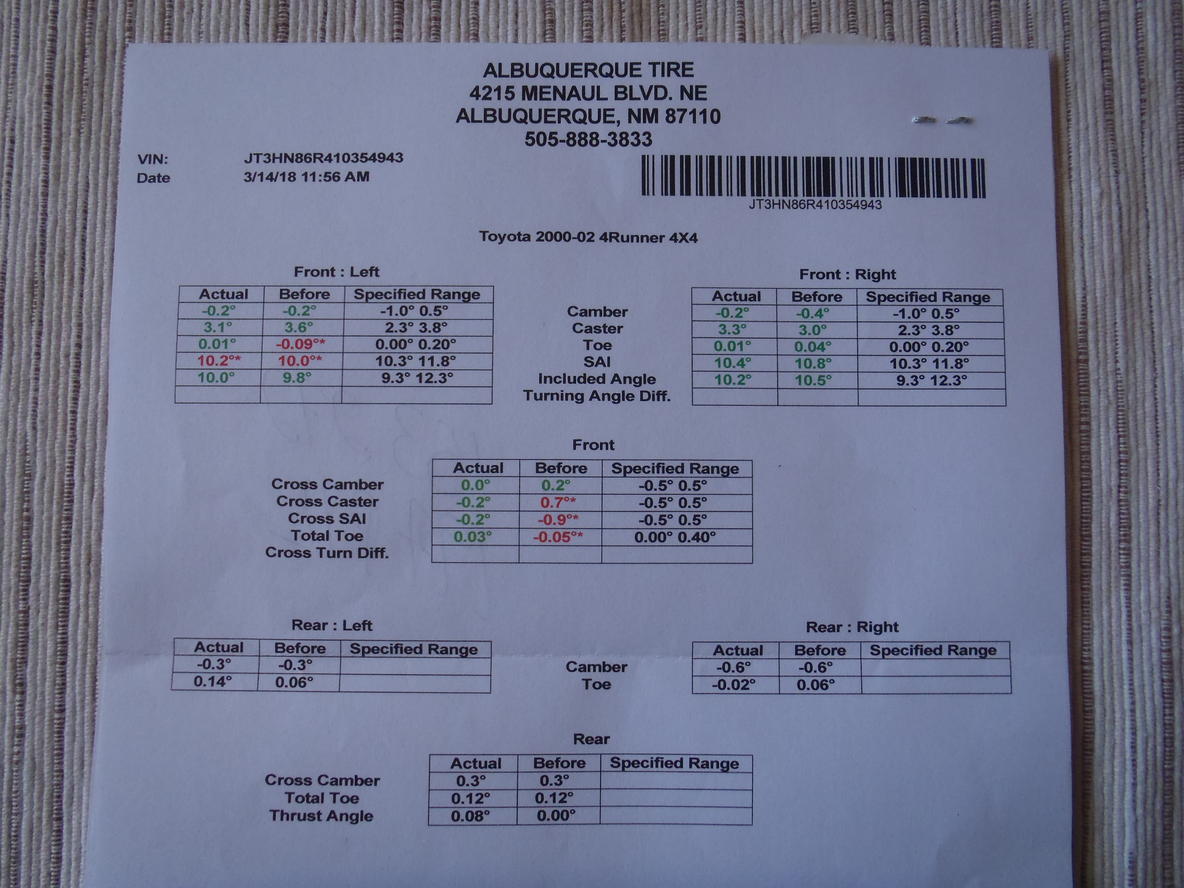

I just did my alignment today actually. 3" lift on OME suspension and 285/75 r16 BFG mud terrains. Here are my numbers
My first time geting an alignment after installing my 3" bilstein/toytec lift w/superflex coils in the rear. 265/75/16 Goodyear Wrangler
2000 4runner limited 4wd
After reading and comparing my results with others, it looks like the only way to adjust my caster is with an aftermarket UCA.
Sent from my SAMSUNG-SM-N920A using Tapatalk
This is a beautiful alignment.
3.3 caster on the right and 3.1 on the left to account for road crown and everything else zeroed. Fresh bushings in both UCAs and LCAs. Front cams in, back cams out for full firewall clearance via the LCAs. SPC UCAs on "D" for +2.0 caster and set with the UBJ ~1/4" inboard from the outside edge of the slot to dial in some negative camber at the UBJ.
I'm always amazed at the trouble people have getting good alignments.

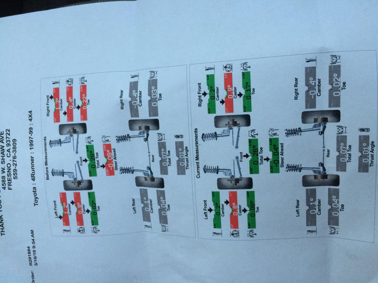

This was the first alignment I got with this truck. The rear alignment is cringeworthy. What do you guys think the verdict is? Axle doesnt seem "bent", but definitely out of alignment.
Doing all wheel bearings, ball joint, sway arms ends and bushings, and a new to me Panhard bar, and front right LCA (had some knocking). Checked front UCAs and back LCAs and UCAs, and they're fine. Front left LCA wasnt as bad as the front right.
Guy at the alignment shop said my axle is PROBABLY bent. Do you guys think so?
Wouldnt toe in and toe out of equal measurement mean the axles is sitting off-center? Hoping the better pandard bar fixed it. Dumping money into this thing, and would hate for the frame to be bent.
A former toyota tech said that bad springs can cause the rear end to be pushed to the left.
Your rear toe issues simply mean the rear axle is not exactly square with the vehicle - one side is slightly ahead of the other side. That's not a problem per se, it just means the vehicle will run slightly crooked (dog -style) down the road. Since the error is only .5 degrees, it will probably be barely noticeable. Have someone drive behind you and see if the rear axle runs noticeably out of line with the front. If they can't see the issue, forget about it and don't worry about it again. Since the toe error is essentially the same magnitude on each side, just opposite sign, it means the wheels are running parallel, so it won't affect tire wear or handling or much of anything else.
It's not a bent axle, btw, nor a problem with the pan-hard bar. Much more likely a worn control arm bushing on one side or the other.
