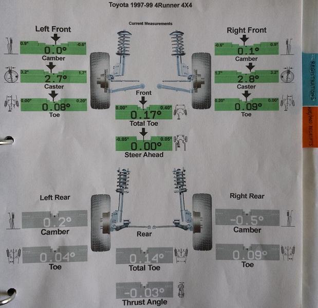

Bump, as I just got an alignment yesterday.
4th gen 17s with 265/65's which are more or less stock ride height.
Notes on the receipt said rear camber was off but could not adjust. Any idea why they'd say that/be unable?

The rear is a solid axle and can't be adjusted in any way. It's slightly cambered due to tolerances and won't affect anything, no way of making them perfectly straight.
Not any adjustments to adjust back there. Usually this is caused from bent or damaged rear suspension or axle components. Bad wheel bearings can also cause this.
Thanks for the replies. Hopefully it is within the tolerance and isn't seriously out of whack. Vehicle hasn't been in any accidents or serious off roading that I know of so wouldn't think there would be serious rear axle damage. At least hope not!

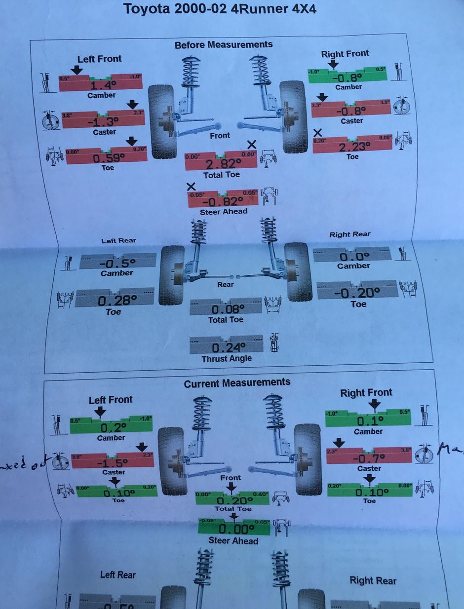

Sorry for bringing this thread back, but just wanted to post my numbers. Fresh tundra/LC lift, first alignment (Firestone lifetime). Pre alignment, I felt the truck not wanting to turn back straight by itself. Post alignment, feels a little better, but now has a slight pull to the right, but haven't driven it very far since the alignment. Alignment cams now both face the drivers side, is this normal? Both were facing up prior to alignment. After reading through this thread and some suggestions from a guy I know, I may be getting spc arms in the future, along with new tie rod ends, rack bushings, and balljoints. Probably not all at the same time, but will align after each change. Again, sorry for bringing up an old thread, but I just wanted chime in and maybe get some feedback. Thanks!

Your caster is way out of spec and why its not returning to center. If you got some SPC arms that will net you at least 2* or more caster. This will push the tire forward and help clear the firewall when running larger tires.
The pulling to the right could be bad LCA bushings on that side. I have replaced entire front end, aligned and still was getting pulling to the right and bad tire wear on that tire.
Come to find out all my lower bushings are toast and Im in process or installing them.
Never worry about where the cam bolts are facing if the computer specs are in spec.

If you look at the horrible image above, the specs are to the left and right inside of the colored bar. Compare those numbers to what you got and see. But truthfully, I'd take it back and have them redo it using the correct vehicle specs, even if all they do is take readings and print it out. You paid for it!

You've got negative caster. Those numbers should be positive. I don't have any faith that those #s are good. The tech may have made a mistake when doing the caster sweep. Truck could have rolled. The turnplates could be binding or still in the locked position. Also, unless you have something bent, your cam eccentrics should be mirror images of each other Or at least close to it.

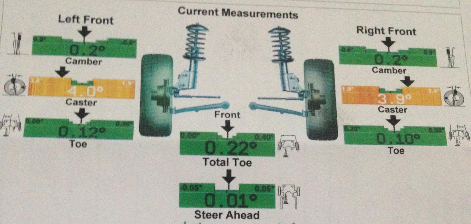

You need new upper control arms. I'd like to think that my alignment specs are close to ideal

I have on recommendation that is possible. This is from experience with personally doing alignments on these vehicles. When actually making the adjustments, the caster on these vehicles goes in the opposite direction of what it will actually be when it sweeps. If an inexperienced tech doesn't notice this, they will do the sweep and think they have the caster maxed out, when actually it's at its minimum. I hope I explained it in such a way that it's understandable. Anyone else wanna chime in on it?
So the measurement goes toward the high end?
