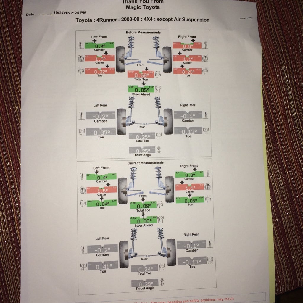

Any tips to get a better alignment? Running OME 884 and Bilsteins for ~2.5" lift.
On wheel drop my passenger UCA is touching the springs, driver side is good. Here is my current alignment print off. Anything adjustments to fix with stock UCA?
Looks like they didn't even try to mess with camber or caster, they just set toe for you and gave it back. Did they say they couldn't do any more?
At that lift height with stock UCAs, you won't be able to get much caster at all. Nothing can be adjusted enough to fix it, the solution is to get aftermarket UCAs with a few degrees of caster built in. That will also solve your problem with the coil hitting the UCA.
So...yeah. Drive it and determine if you're okay with the handling (since the toe is good and the camber is okay, you won't be tearing up tires). If you don't like how darty it is now: UCAs.
If the caster cams are maxed (front ones) that's as good as you're going to get with stock UCA's.

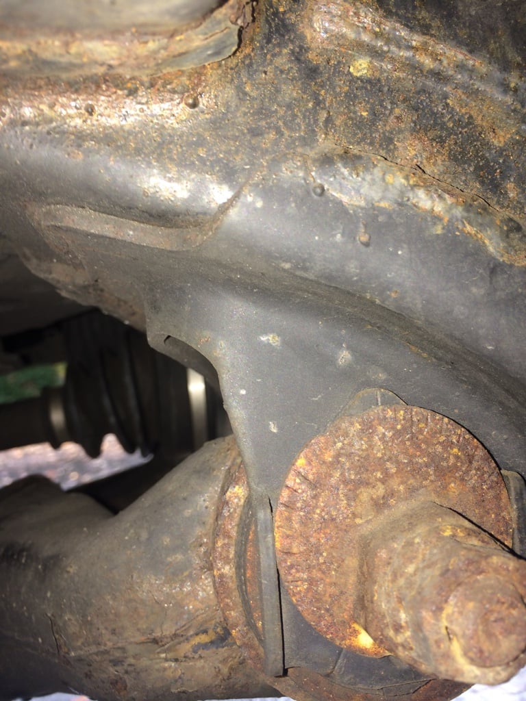

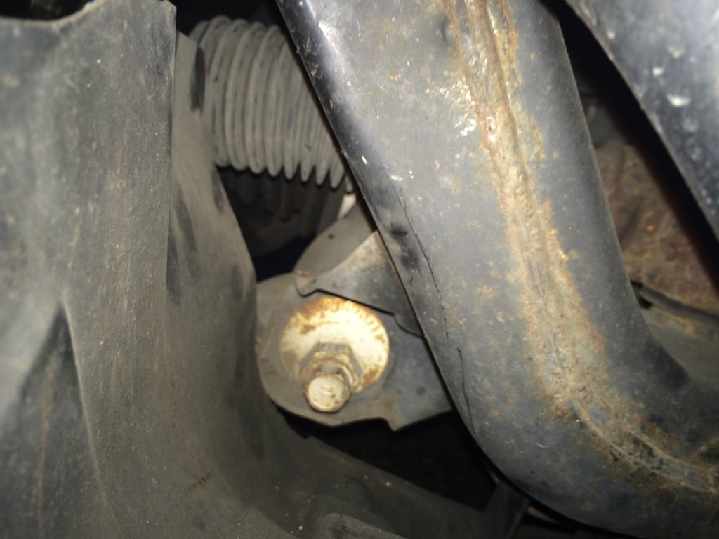

I don't quite understand how you read the cam bolts to see if I have any adjustment left. I'm not seeing what you are in these pictures.
Look at the second picture. Look at the marks on the cam bolt (washer), you can see that from the top center there are marks on either side. Those marks indicate the adjustment range. That, at least, is my still learning understanding of it :)
You can't just look at the front adjusters on the lower control arm, you have to look at the rear ones too...
Moving the LCA in/out (turn both front/rear adjusters the same direction) affects the camber by tilting the wheel vertically.
Pivoting the LCA forward/aft (turn the front/rear adjusters opposite each other) affects the caster by changing the steering axis angle for the wheel (the lower ball joint moves towards the front/rear with respect to the upper ball joint).
You'll have to inspect the rear adjustment cams as well to really see how much adjustment room you still have (if you just mess with the fronts, you'll change both caster and camber simultaneously).
I agree that those bolts look like they haven't been touched, which is validated by the lack of caster/camber difference on your before/after printout. I'd head back to the shop and ask why they didn't even attempt to improve your caster numbers (since those are clearly outside the acceptable level).

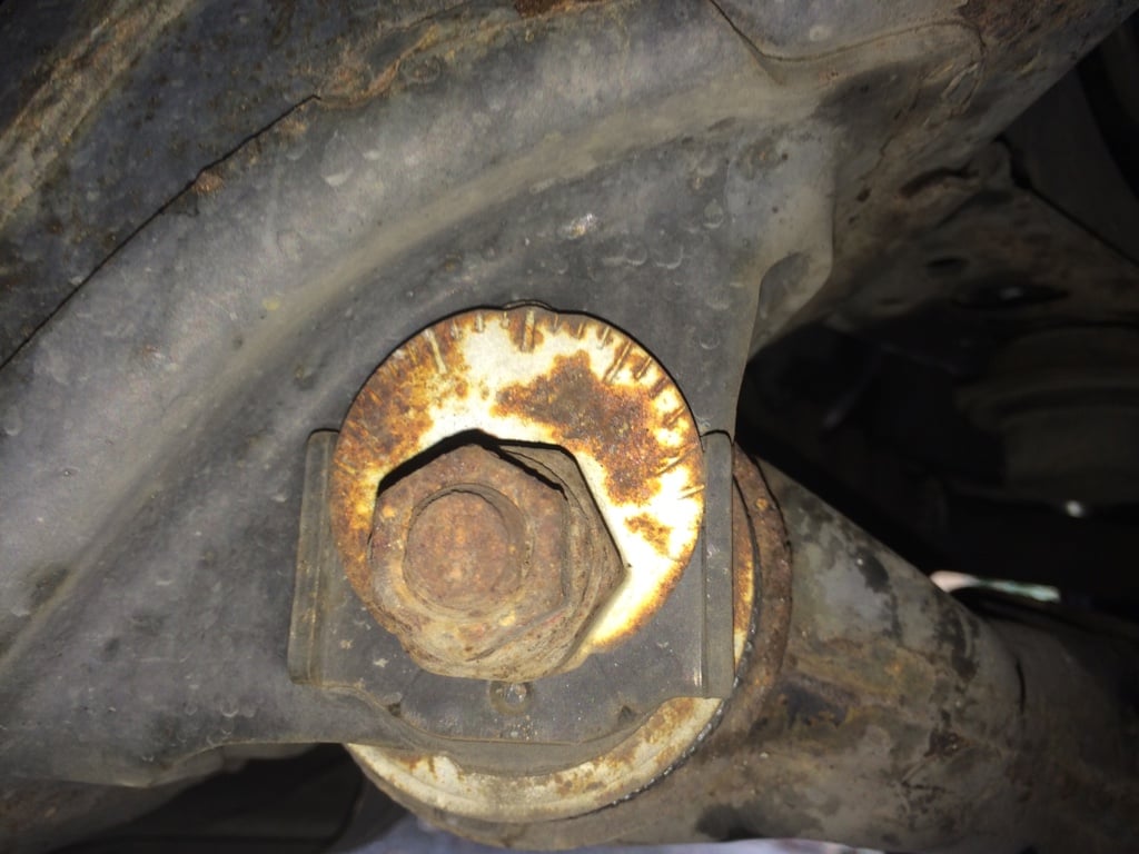

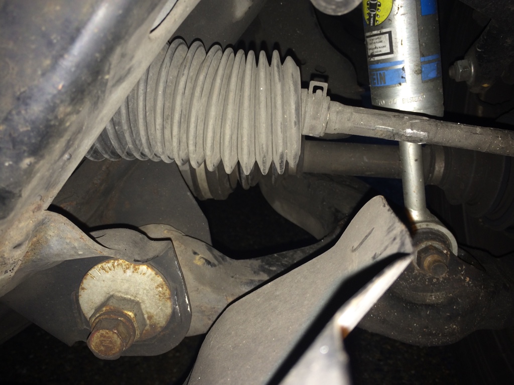

Here are the rear ones. Both sides look like they have room for adjustment, driver side looks pretty rusty, looks like they were able to move it partially, seized to much for further adjustment maybe?
Driver
Passenger
Those definitely look like they could be seized! However, I don't see any tool marks on there (indicating the technicians never even tried to adjust them).
Go to the shop with your alignment sheet and pictures. Ask why they didn't correct the caster. If they tell you there's no more room to adjust, show them the pictures and point out that there is indeed room to adjust. If they tell you the cams were seized, show them the pictures and ask them to point out where they wrenched on them; those look like they haven't been touched in years. Unless they charged you less for only adjusting the toe, it looks like they've done an incomplete job.

So it looks like (in the ideal situation where nothing is seized) I have room for additional adjustment on both front and rear cams, right?
I see two scenarios
1) Tech was lazy and only adjusted toe
2) Cams are seized and tech couldn't adjust them further (and didn't tell me)
Assuming it is seized, what is the dealer likely to recommend as the fix? New LCA? Cut bolt and do new cams?
Yeah, it looks like you have some wiggle room on both the fronts and the rears; that means your camber/caster numbers could be slightly better, but at your lift height you'll probably still be lacking on caster once the cams are maxed out.
If those bolts are seized, penetrating lube / impact / torch / cut to remove the bolts and replace them with new. You shouldn't need a new LCA unless the bushings get melted from torching out the bolts. Even then, it should be possible to press out the old and press in new bushings.
