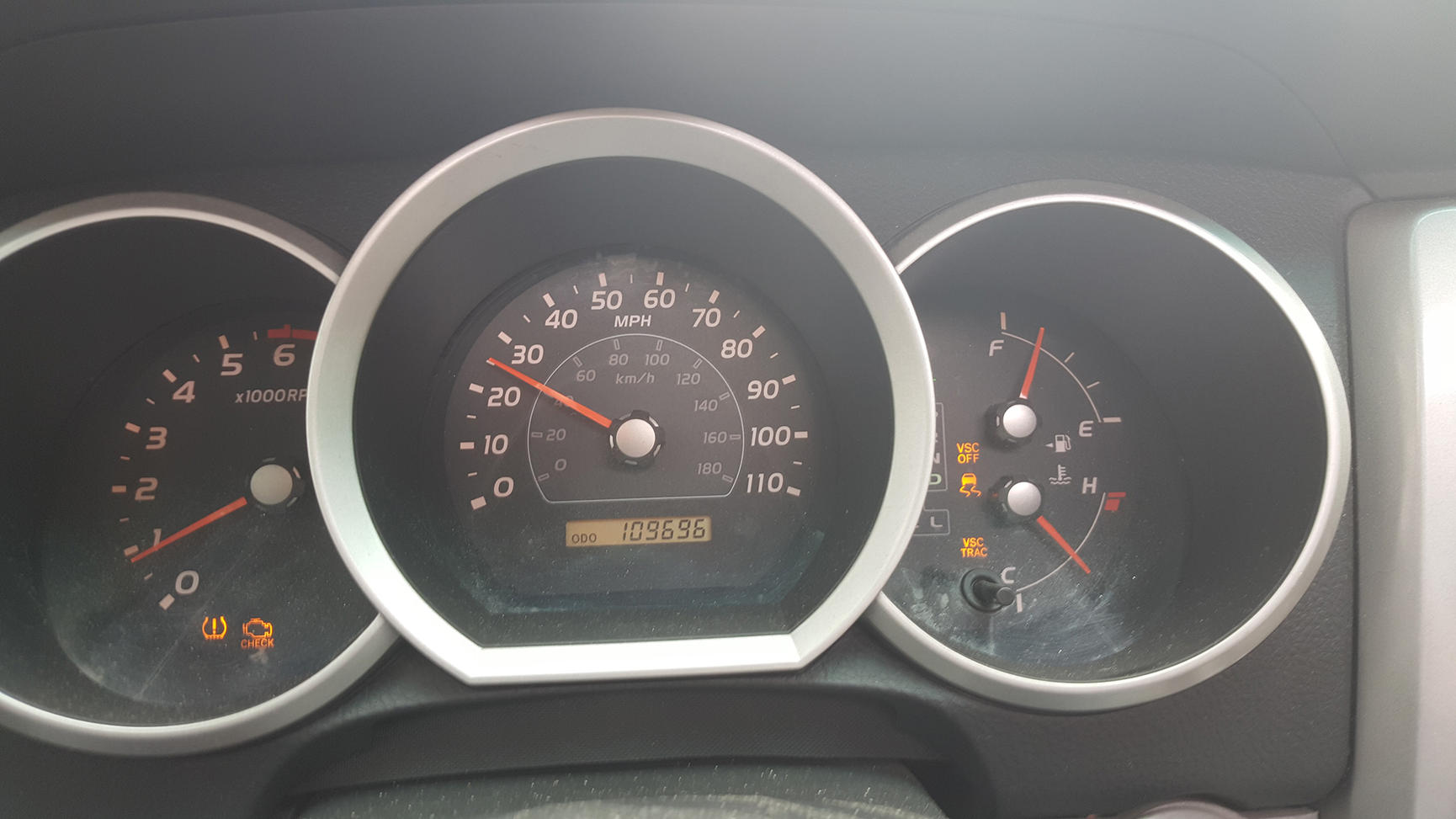

See attached photo. When starting my 2006 4runner, the lights are all off. About 3 seconds after it turning over, they all come on and stay illuminated for the entire time driving. Everything works fine -- ABS, speedometer, tact, etc. No idea. Looks like an electrical issue.
The ODB reported 15 codes. The first one was the most troubling, which was c1201: Engine Control System Malfunction. The rest were all codes dealing with evaporator issues.
Anyone ever see before?

http://www.toyota-4runner.org/4th-gen-t4rs/151487-check-engine-trac-vsc-read-me.html
This will explain the reason so many lights are on.
Can you please post all the DTCs present, C1201 is a generic fail-safe DTC set when an OBDII DTC is detected.

I'm guessing some of the DTCs were P0456 and a P0441? Which sounds inline with a gas cap being loose (you never posted the DTCs so I can't be sure.)
[MENTION=66389]BlackWorksInc[/MENTION], I have a P2197. Seems like the most straightforward approach would be to replace the sensor in question. I'm worried about being one of these guys that chases the sensor based on the code and something else pops up. I know it's not the only cause for that code, but seems like the best place to start. You agree? Reading through the forum makes me think either 1) gas cap fixes everything, or 2) not matter what you do, the light will never go off.. haha.
That's a pretty straight forward DTC, toss in a new Bank 2 Sensor 1 AFR sensor and you're good to go. That's one of those really easy DTCs, the only other possibility is the ECM; which is extremely unlikely. :)
Basically it's saying that the ECM is watching the sensor and it knows that the sensor is reading too Lean even when it richens up the mixture.

P0456- EVAP Gross Leak Detected
P0455- EVAP Small Leak Detected
P0411- EVAP Incorrect Purge Flow Detected
Check the gas cap and see if it's loose, I will guess that it has backed off by itself. I've been seeing this happening with some of the older Toyotas (happened to my 4th gen as well) the rubber gets very hard and will cause the cap to back off and create a leak, you tighten it and it's okay for a bit until it gets loose again. A factory gas cap is a good fix, though some aftermarket ones work as well (seems sorta spotty though, some people have had the aftermarket ones not seal properly).
At least that's my guess since those are the trifecta for a large leak like a Gas Cap or big hole in the EVAP system.
By the way, the correct term is not "Evaporator" that is the radiator-like assembly in the HVAC system that cools the air when you turn the AC system off. EVAP is shorthand for "Evaporative Emissions Control System", there is a difference and when you first posted I thought you were talking about an Air Conditioning issue. :) You can just call them "Emissions DTCs/Codes" as that's pretty well known as well. Don't mean to beat you up on it, but the wrong terminology can send diagnostics in the wrong direction.
