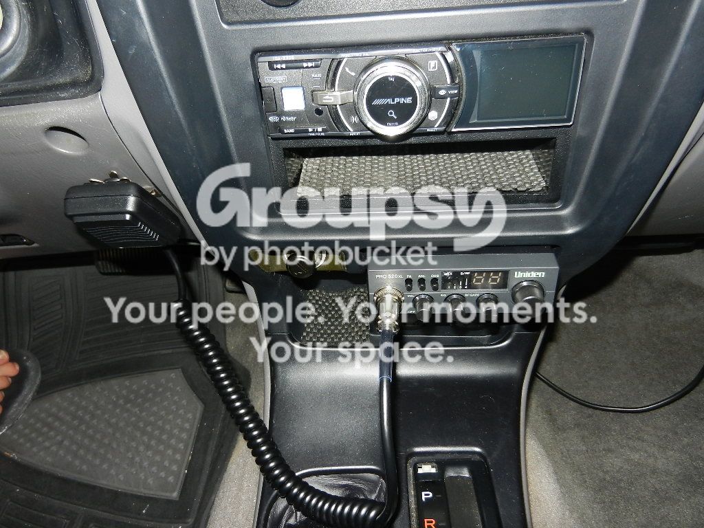

There is a thread somewhere about this and has everyone's mounting locations. I searched for it but don't' remember what it's called.
At any rate... I have the Uniden Pro 520xl mounted in my ashtray location. This picture is before I had a 90 elbow on the antenna connector on the back so it sits out a bit further in the pic. As it sits now it's flush with the dash edge.

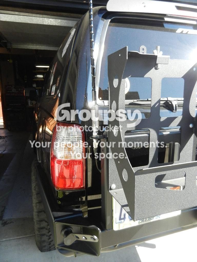

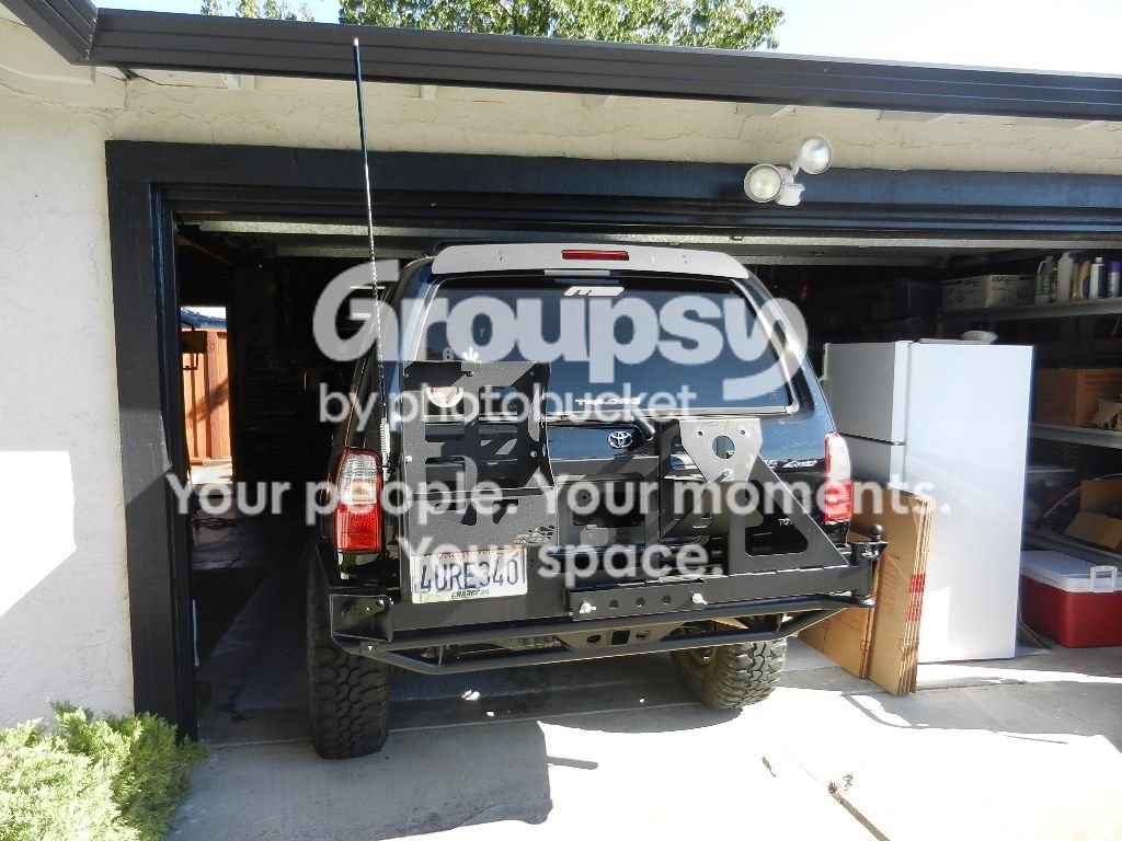

Antenna mount is on my CBI bumper:

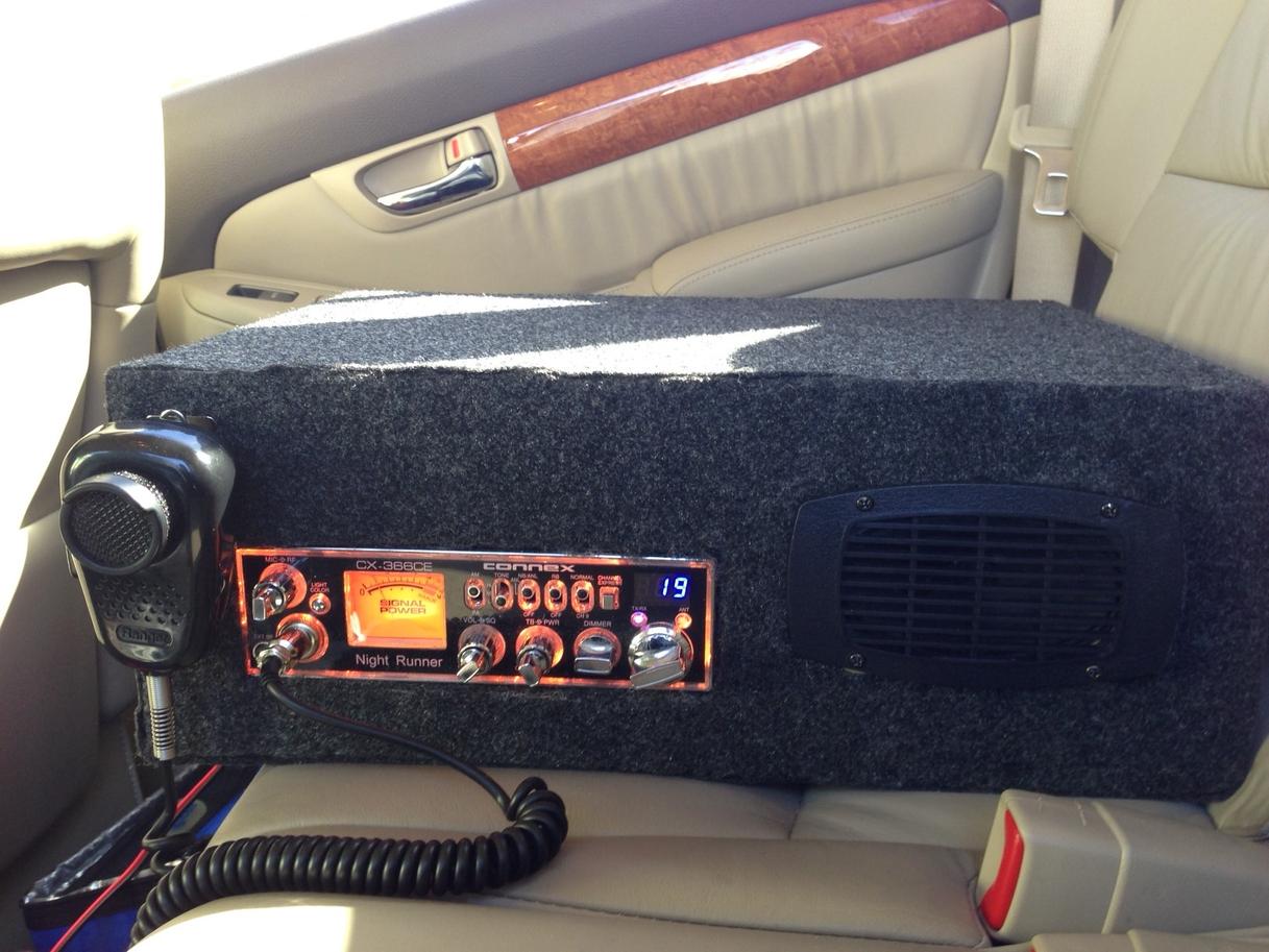

Don't have my T4R yet but currently rolling around in its cousin the gx470. I had a perfect, to me of course, setup for my Connex in my Super Duty until I sold it.
In my research for my 4Runner (5 th gen) I came to realize that the options for anything larger than the little all in one cobra 75 are quite few.
That being said I decided to build basically a small slip seat box, trucker term that refers to an easily movable box that holds your radio, maybe a stereo, and speakers. I didn't need the stereo or anything as large as they sell online so I built my own out of some 5/8 particle board I had lying around. I literally finished it last night. I'm responding from my phone right now but when I get home I will post pics.
The point to my build was to have something I can quickly disconnect and remove from the rig. As well move it from the front seat to either the back seat or floorboard when the gf is along for the ride.
It's about the size and weight of your standard briefcase and am pretty happy with it.

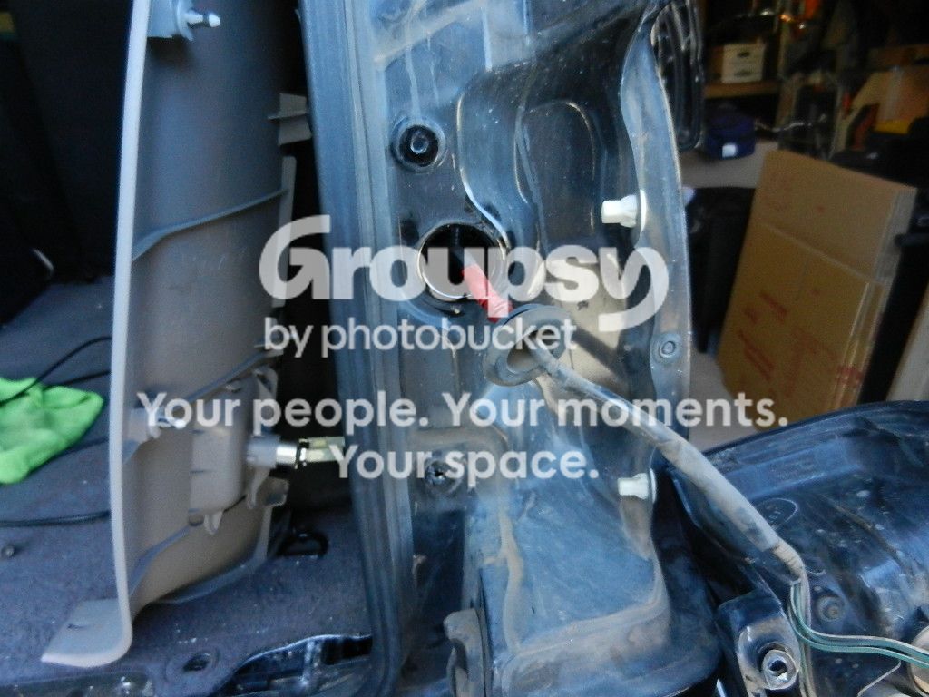

Anyone have pics of how they get the antena wire outside? I don't really like the idea of drilling a hole through the body or run the risk of cutting it through a door jam
I fed mine through the tail light grommet and then behind the light. It feeds through the same hole the wires to the signal/stop/tail lights do.

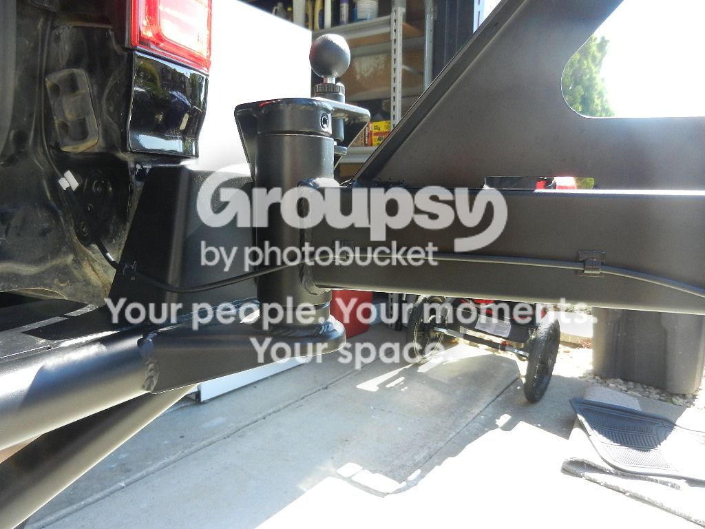

And used stick on cable ties to hold the cable in place along the tire swing out.

I think this is the best place for a CB and it's why I got the model I did. This and the Cobra 19 both fit into the ashtray spot with a little trimming. I like the small basic CB for what it is, if I went full size then I would but it below my HU. But before I put in a full size CB I'd rather upgrade to HAM. But so far my CB has worked perfectly for me.
Box I built for the radio and speaker. Currently sitting on the backs seat of the GX. Using the seatbelts to secure it in place for now, gotta think of a more permanent solution for that. Dimensions are roughly 18"W x 11"D x 5"H.

Thank you very much! Next step is a nice 10 meter and my FCC license, of course.
Sadly there just doesn't seem to be much space to mount the larger radios. Space seems to decrease as the model year increases.
Overhead was the holy grail for me, assuming I don't get a sunroof, but the work involved and messing with headliners is too much for me.
Pretty happy with my setup. Certainly not for everyone but works for me!!
