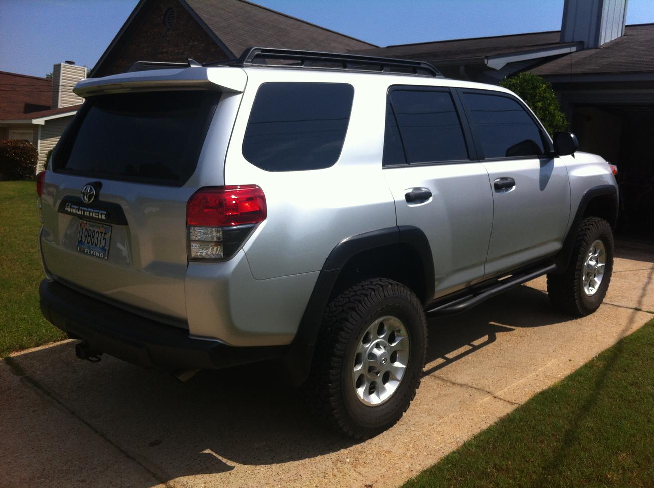

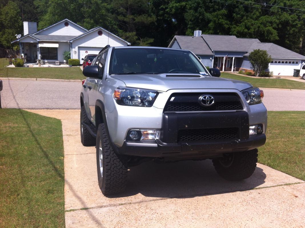

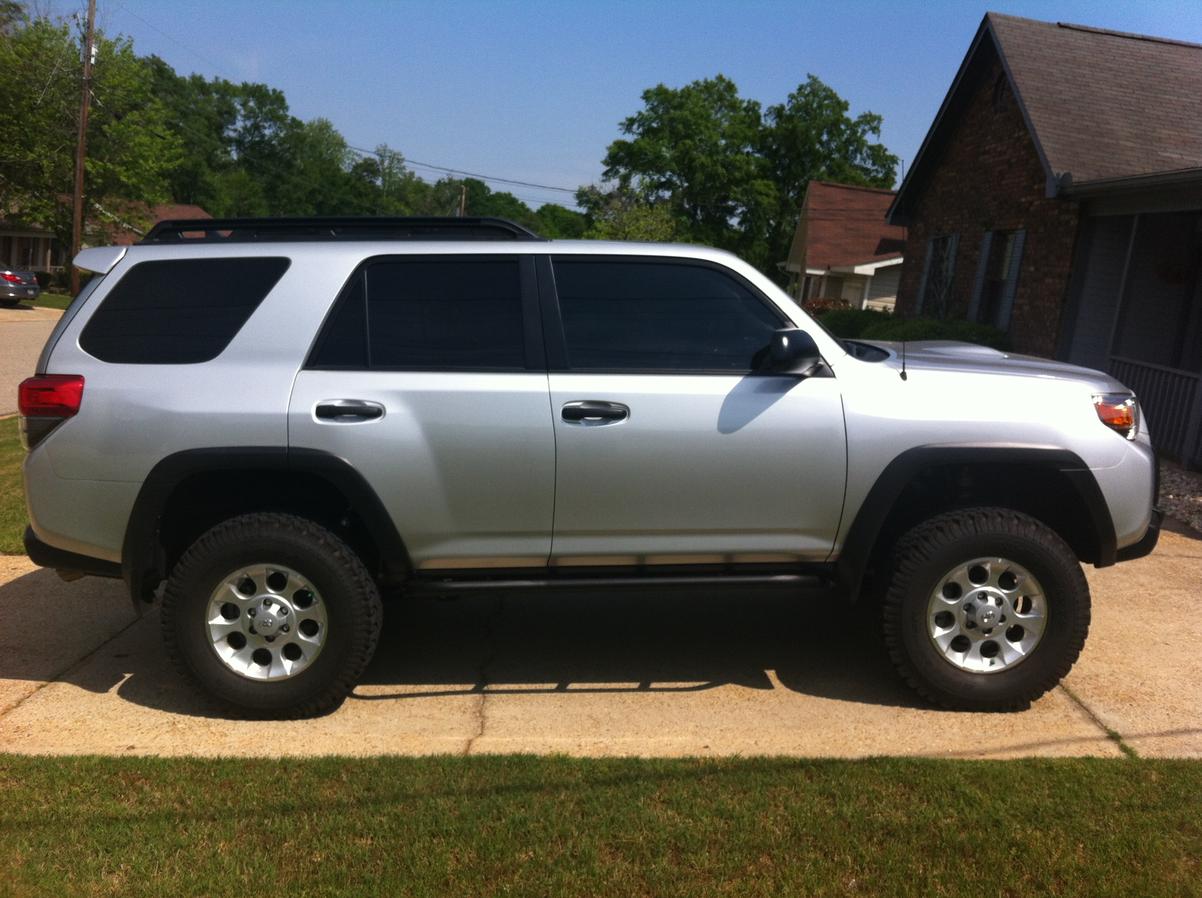

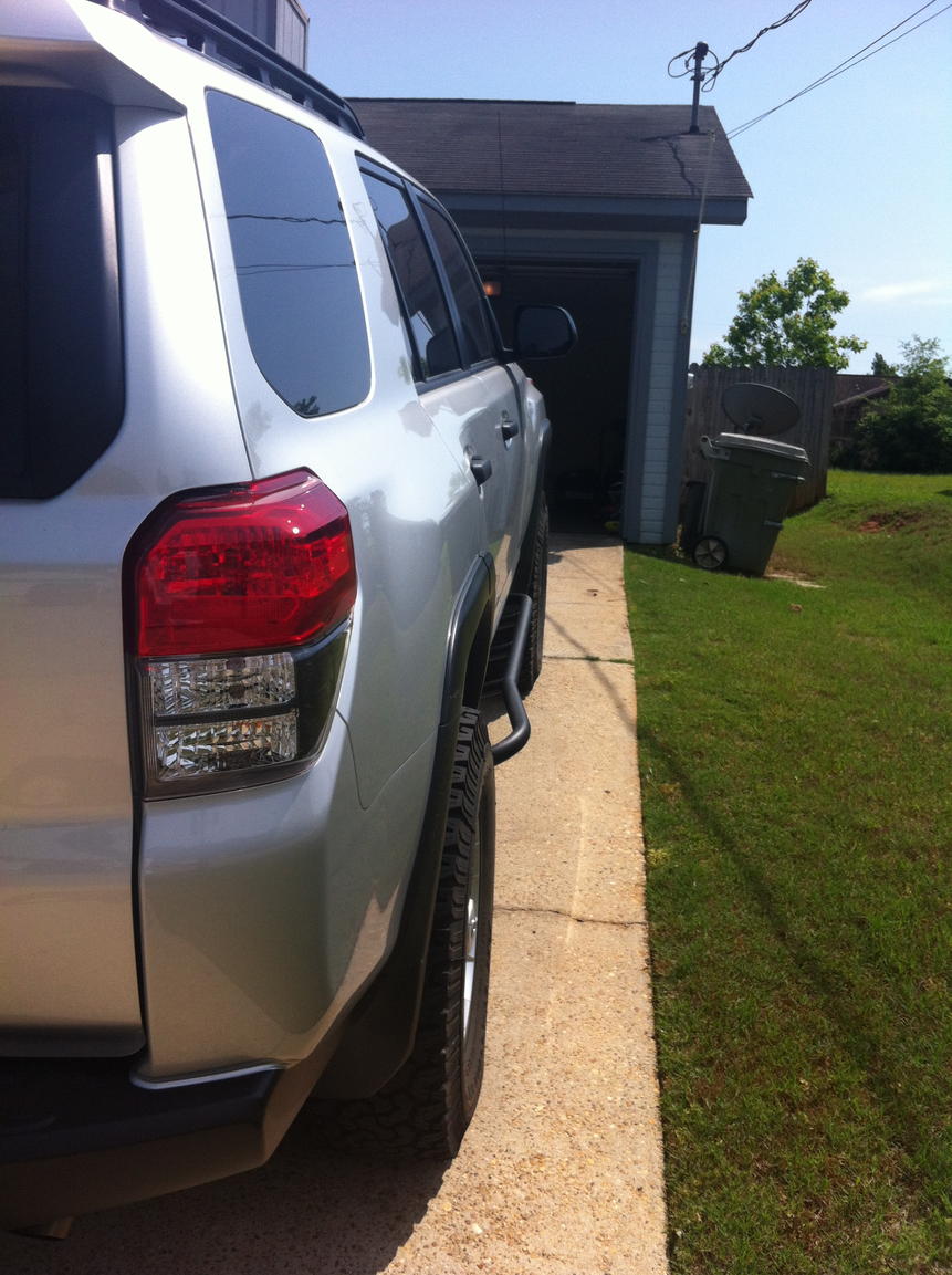

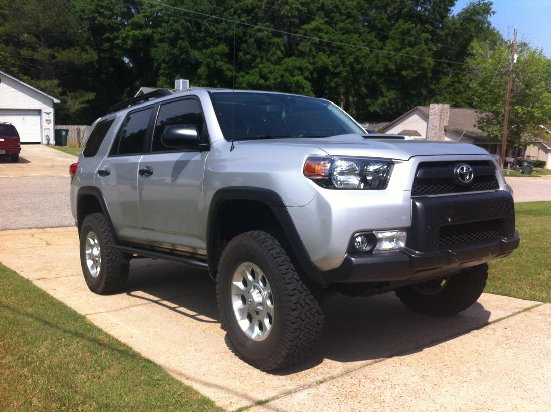

Almost finished...the next addition will be a grill craft grill and powder coating the wheels. I know she is plain, but I think she is a beaut.

I currently am running an Icon Stage I lift with the front as high as it will go. I haven't noticed any settling, and the suspension has been on for almost four months. The tires are currently BFGoodrich All Terrain KOs. Amazing tires to say the least. Honestly, I haven't noticed much of a difference in the amount of debris and mud that collects on the side of the truck after the mud and rain. I think it is mainly due to the tread pattern of the BFGs. I will say that the 4R definitely handles better going around corners, and the chicks dig it too.:girl: In addition I have the weathertechs all the way around, and 3M Crystaline tint which comes out to about 15%. Hope all of this helps and is informative. I just drove 800 miles round trip to Orlando and averaged about 16.8 MPGs at 80MPH. Needless to say, I wasn't too thrilled about that. Oh well, at least she is fun to take off road.

Spacers are 1.25in on every corner. The only time I have noticed any rubbing issues is when I am in reverse, and I turn the steering wheel all the way to the stop.
