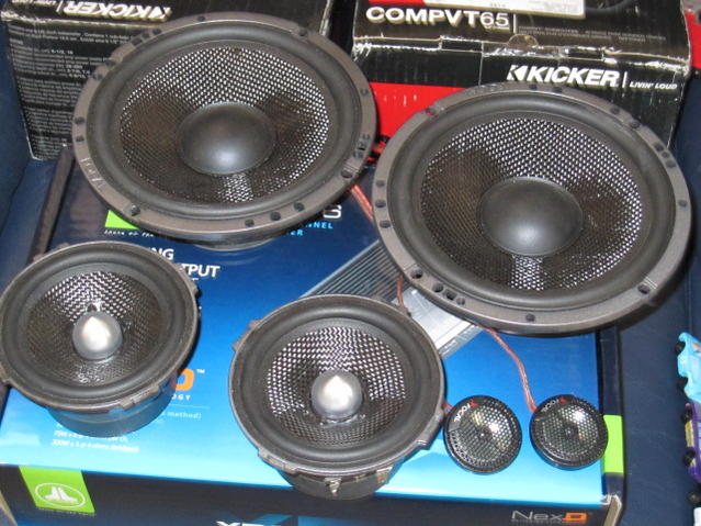

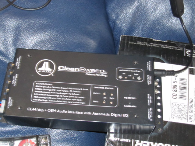

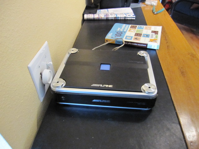

I`ll keep stock head unit. Jl cleansweep will be connected to stock speakers wiring. line levels from cleansweep to 6 channel jl amp and from there to alpine amp bridget for a pair of kicker subs. 6.5" subs will fit in rear hatch and I`ll keep stock appearance. 3way Jl in front doors. mid and tweeter in the place of dash speakers. 3way focals in rear doors will experiment with tweet placement. tread will be updated as I go. should take me a couple of weeks to get prepared

Will the subs be a direct replacement of the existing rear hatch speakers?
yes, that`s the place internal hatch volume is enough to get down to 27 HZ according to bass box software calculations. subs also shallow, will fit there no problem. I`ll have to do a lot of sound deadening. where do I buy dynamat cheap?
another challenge is to mount mids and tweets up front. factory dash speakers locations should be ok but JL and focal mid drivers is 4", I`m not sure it they gonna fit inthere. I don`t want to use A pillars due to airbags in there.

looks like some nice kit, Victor_inox. looking forward to seeing it all in place. (side note: it's kind of funny that all your trick components are laid out next to an "affordable vacations" book :naughty:)
