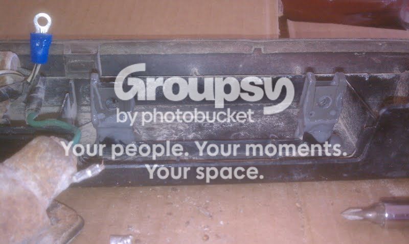

I called a Toyota service center and they said they thought it did. So i took apart the rear panel with the hatch down. the window was in the way (of course) so i looked and saw which door latch had the sensor then used a screw driver to move the latch to the closed position. Went to the front WHILE HAVING SOMEONE HOLD THE WINDOW, and rolled the window up. Did all this because it is much easier to work on it from the top down standing up than it is for a 6'1" guy to fit in the back with my 12's in there. Once we opened it up i was able to address few problems...
1. Driver side spade connection for the rear window defrost was broken off. *Fixed with a new connector and wire strippers*
2. The passenger side License plate light was dangling down and i wanted to fix it. So right now some JB weld is drying with some auto body speed nuts so i can mount the stock plate light again.

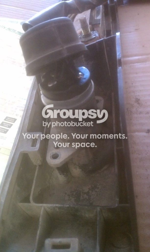

But with all that done, I still cannot figure out the problem with the rear window and why the rear lock doesn't roll it up. If it isn't suppose to, i feel dumb. If it is, any trouble shooting? I can't even get the Lock cylinder off the rear license plate assembly.
IMAG0096.jpg~original
Any help on this (if needed) would be appreciated...
So quick question recap...
1. Is the light ticking (at all RPM's) normal?
2. How can I gauge the engine temp without a actual temperature gauge?
3. After driving for 10 minutes, is it normal for me not to be able to touch the engine for a full second (because it is hot)?
4. A. Does the rear key slot roll up the window as well as down? Or does it just roll it down?
B. If it is suppose to, what could be the problem?
C. How can i get the Lock Cylinder off the License plate assembly (see above picture)?

the key switch issue is common the contacts in the switch wear out and youll need to replace the switch and install your lock cylinder. to make sure this is the problem you just need to put a multimeter on the switch contacts one will be a 12v solid with ignition on when you put your key in and turn you will get 12v in each direction. if one direction of the key turn and corresponding wire doesn't put out 12v then you know the switch is the issue. once separated the lock cylinder and switch are easy to swap.
you can not repair the switch because its glued in and a pain in the butt to work on.
here is a link to show you the separation and how easy it is to put your lock cylinder a new switch. in your picture you can see the hole that has a set screw that needs to be removed to separate it from the license plate holder
http://www.toyota-4runner.org/classic-t4rs/82853-tailgate-lock-cylinder-repair-walkthrough.html
hope that helps!

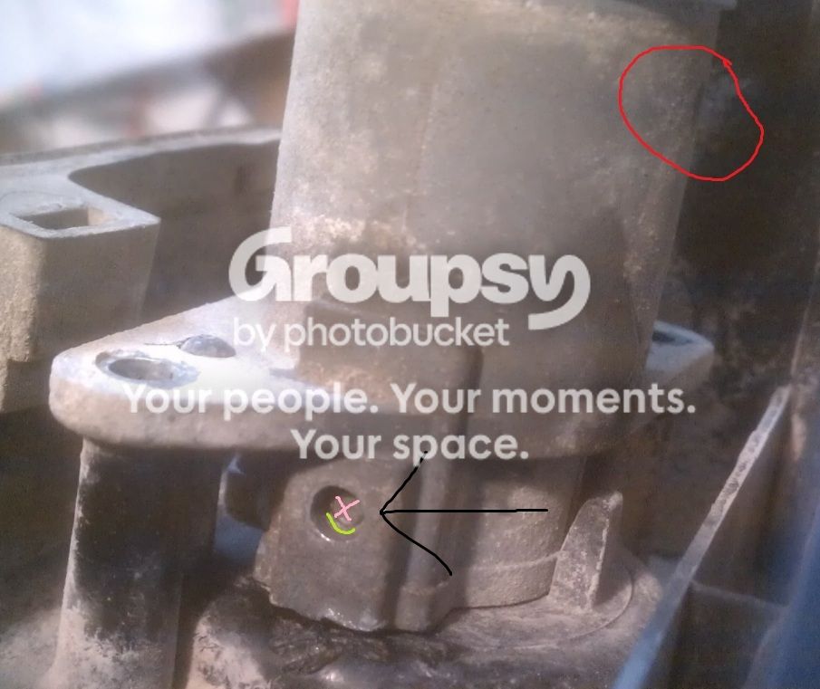

Thanks. That is great stuff. The thing i am having a problem with is separating the switch/lock cylinder from the whole plastic mounting bracket that sits above the license plate. I cannot seem to get it removed. I have unscrewed all possible screws and cannot for the life of me get it apart. Does the "cover" for the lock on the face side pop off or unscrew? Does the whole cylinder come out the back or push back through the front? i am just at a loss. i don't want to break the thing trying to fix it ya know? lol
like i said the unit has a set screw once the screw is out the switch comes off the lock cylinder and it will be able to push it out of the black plastic.
Yeah i looked very intently for another screw aside from the two that run parallel to the Cylinder that hold it in the plastic. The only hole that could possibly have a screw like you are talking about is pictured here:
Captured.jpg~original
The hole that i think you are talking about has an arrow towards it. I tried to see/scrape to see if this is a set screw and it isn't. The pink X is a flat surface and the light green semi-circle indicates a VERY small space. Not large enough for any "ratchet" or tool to do anything with.
The Red circle indicates the only other hole i could find on my cylinder. It is "empty" I cannot see inside of it because of the plastic near it and any allen key i stick inside seems to have pretty free play. I prolly sound like an idiot here, but i cannot get this thing off.
it may have corroded to the point that it cant be pulled out have had some before that did that. i used a dremel with small head to drill out that piece to separate the two and yes the pink x is the hole that separates the two,
