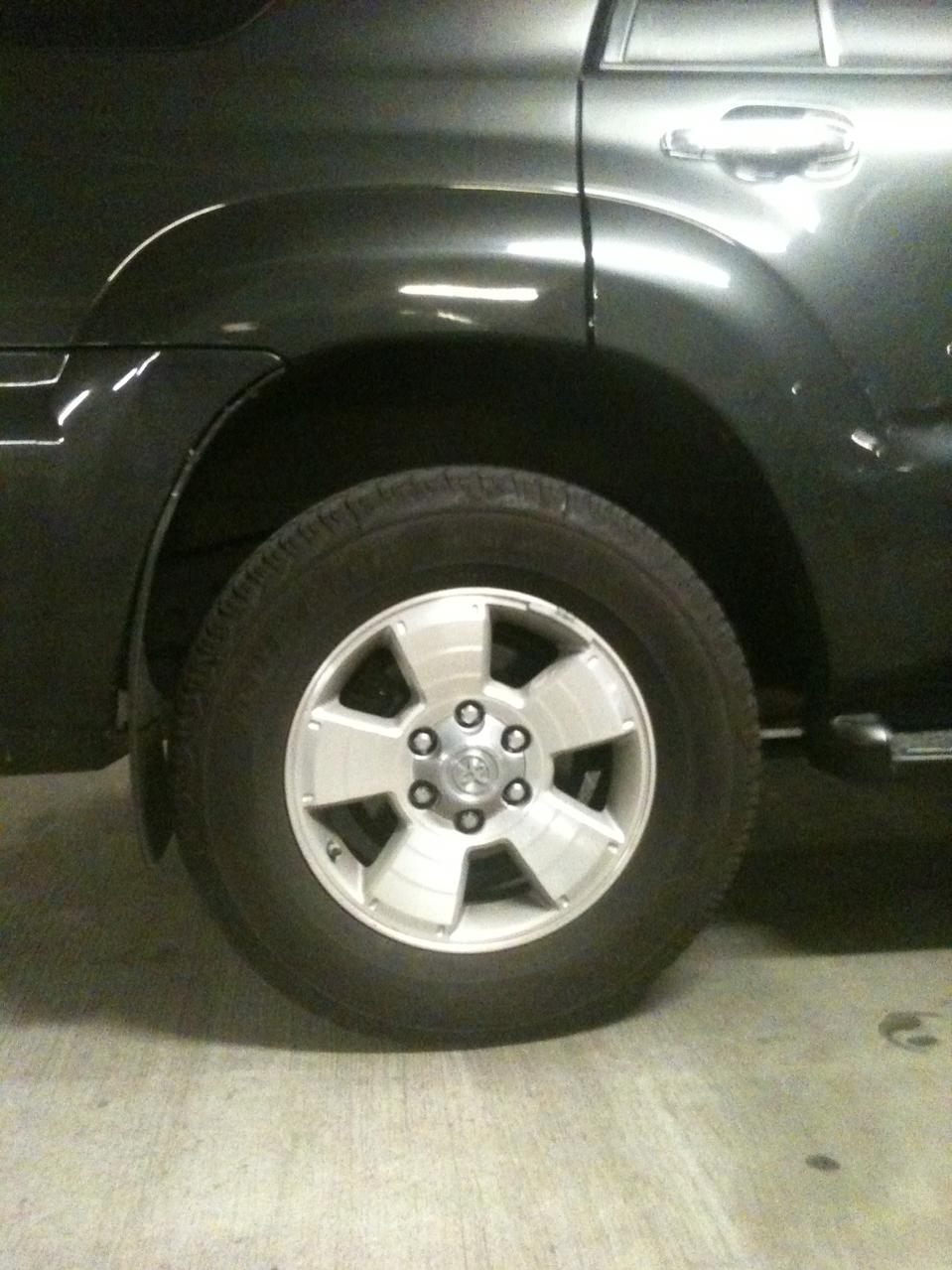

I have an 07 4R with 265/65-17's but the rear looks like it might be a little on the lifted side(See pic). (The Toyota dealer knew s about s when it came to 4R's)
In the rear; from the center of the hub to the begining of the fender measures 21". The front is about 18".
I'm not sure what to look for to determine if lifts have been added, so I thought there might be some standard spec for that measure.
Thanks

I think it may just be sagging in the front.
There was a thread somewhere recently with stock measurements. It's around 20-21" for the rear and 19" for the front.
Thanks. I couldn't get any of the search wording right to come up with anything solid.

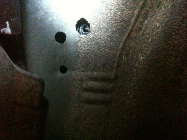

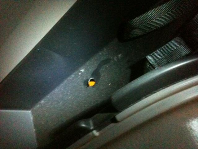

This still doesnt explain the mystery hole in the rear passenger storage bin that runs through the wheel well.
I thought it might have been for a compressor or something...

Could it be a hole for subwoofer wiring?
If not it could be some sort of off-road wiring (air compressor, fridge, power inverter, etc.)
3" seems like a lot of rake. Most stock 4Rs have some rake but 3" seems excessive. Maybe it was run with something heavy on the front and a spacer lift?
Here was my dimensions recently before and after lift, stock 2008 SR5 with 33,000 miles.
Ok, final results.
Dimensions front before lift = 18.75 After = 21.0
Dimensions rear before lift = 21.50 After = 23.0
Hope this helps.
