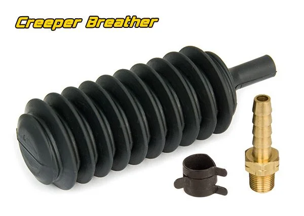

I would get extended brake line, and run a diff sealed diff breather while you are at it.
attachment.php
