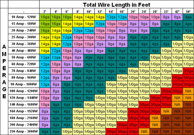

Also what gauge cable are you using? I would highly highly recommend 4 gauge cable.
(I forgot to add that I once had an Alpine amp that claimed it only needed 8g but it kept shutting off, when I switched to 4g the problem went away entirely)
This is for several reasons ....

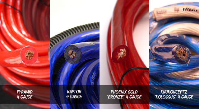

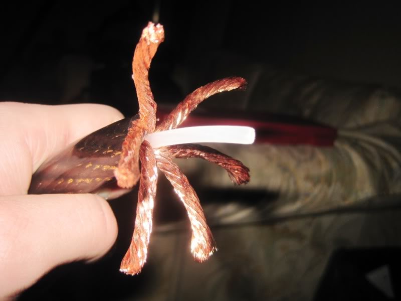

1) most stereo cable isn't copper, it is actually CCA or Copper Clad Aluminum. For this reason it is inferior to copper at least for the purpose of power throughput. It is still ok for most stereo uses but just know it isn't copper.
2) most cables aren't actually AWG even if they imply it is so. A specification on packaging may say something like 4G but they never say 4 AWG which is the real specification for contractors and electricians.
What does this mean? Well when you look up Wattage vs. distance vs. Cable Thickness (AWG) charts they are almost always referring to real AWG and real copper. As I already mentioned CCA is inferior and about 66% as efficient as copper (quick Google search, no hard references) and the 4G is probably not 4 AWG.
So you may look at a chart that says 8 AWG copper is more than good enough to push 600 Watt about 8 feet without issue. But what most don't realize that their 8G Amazon/EBAY Copper Clad Aluminum cable can't come close to this.
How do you make sure you are covered ... it is simple. Buy 4G always and preferably copper but that isn't realistic for 95% of stereo builders. So go with CCA but make sure it is 4G, as close to 4AWG as you can find and you will probably be covered.
