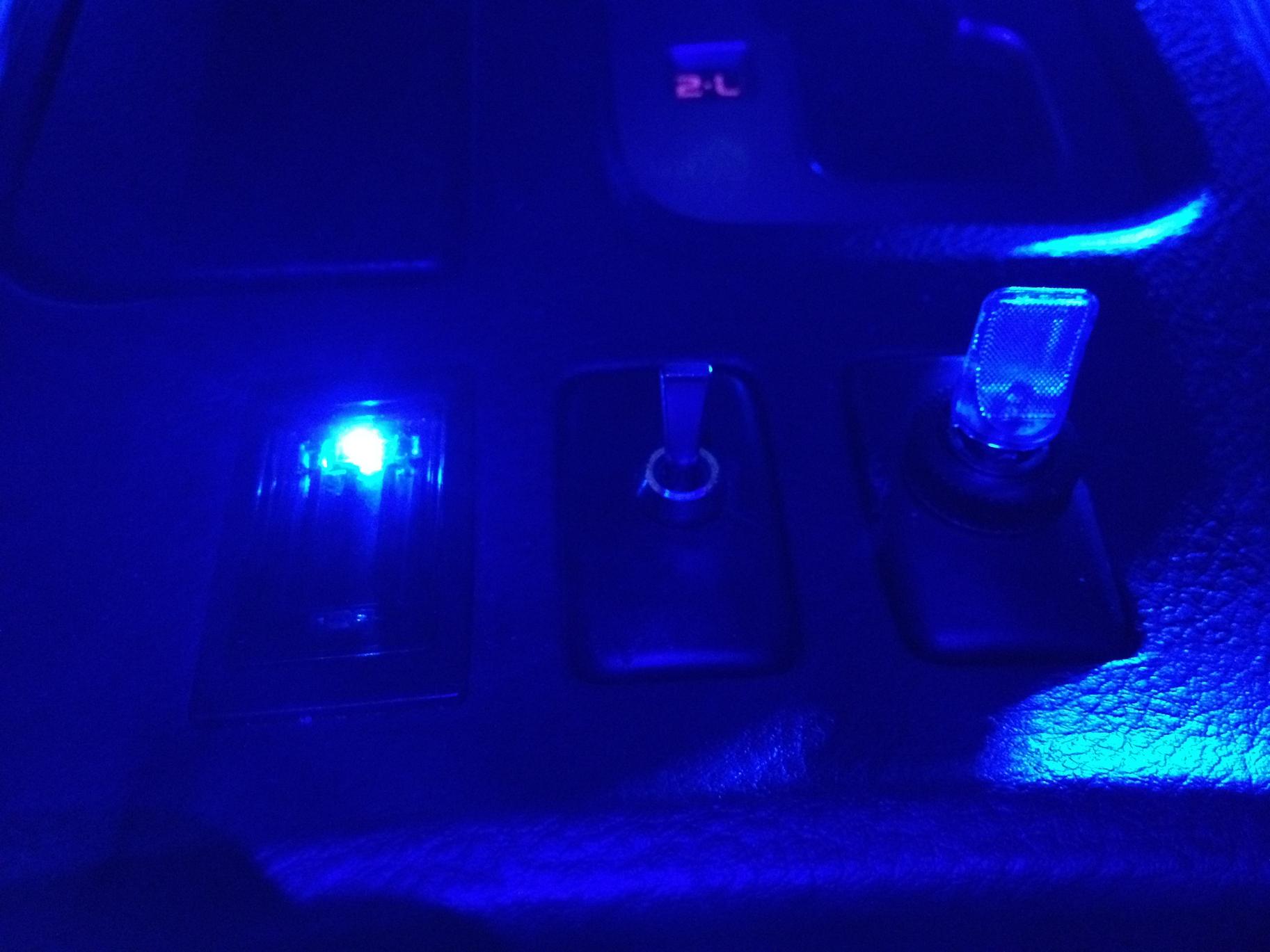

i havent seen anyone else with a switch like this that i made but its really easy to do just a little pricey but it was worth the money for me (being that i can turn the off with my daughter in the car) or when i dont feel like listening to my subs or going through neighborhoods
DSCF0785.jpg~original
Touch screen switch on the left for sub amp. can buy at any autozone. Its just alittle big for the hole but just a little handy work with a razor made it fit. middle switch is for Front 6X9s amp. and the one on the right is for rear 6.5s.

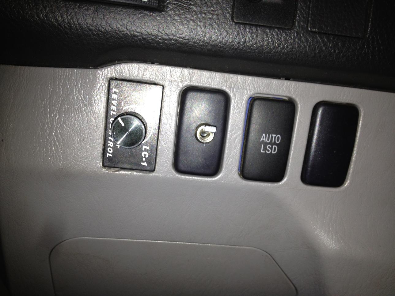

Best thing to do is to put an in-line switch on the amp trigger, that way it will still turn on and off when the head unit/car is turned off, but you can kill it if needed
thats how mine is wired. i have it wired into the remote wire. its just a inline switch

Does the switch you made light up when you turn the lights on similar to the DAC switch? If so, I need the details. Looks awesome!!!
(I think I may have asked this before, I can't remember...LOL)
Im not sure if it does i want to say it does because it has a bulb socket on the switch i will pull it and try to wire it up to see if it works.
