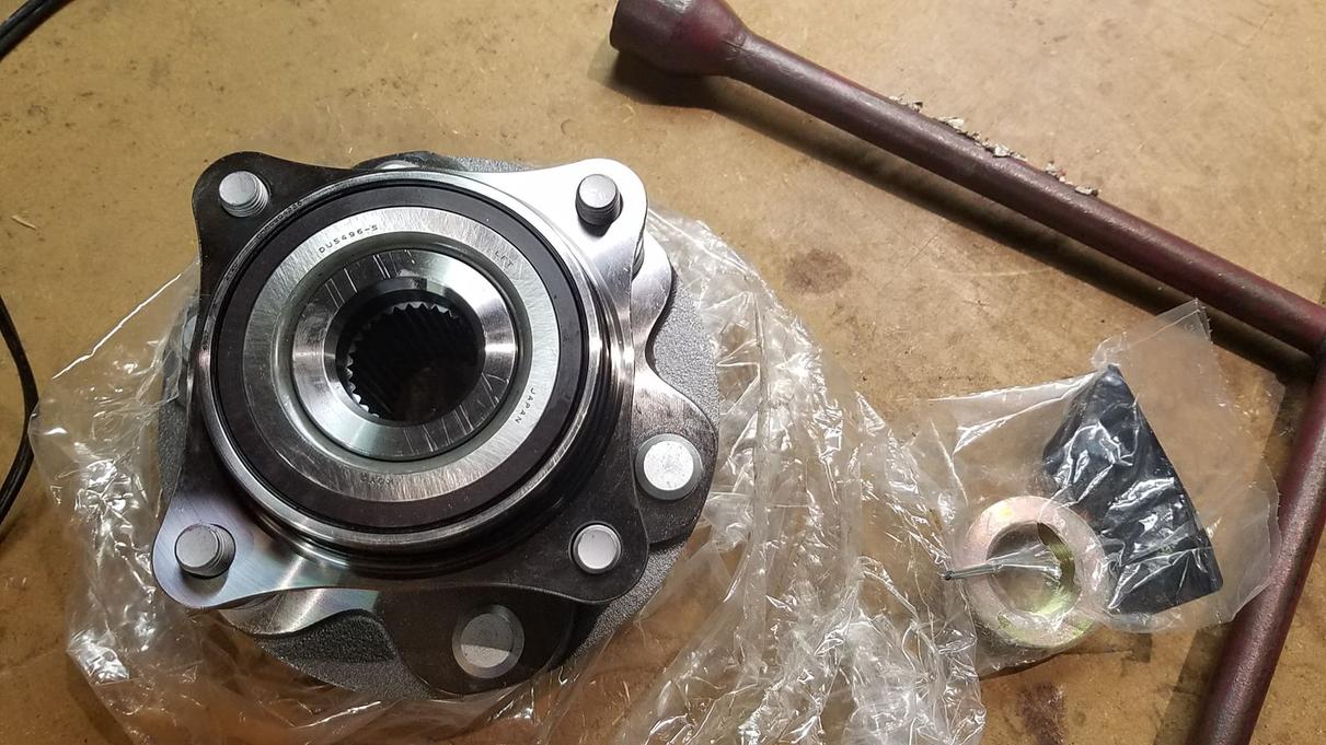

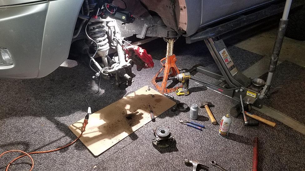

Finally got in my hub assembly. Ended up getting it from the jersey guy again since I figured it would be quicker being only a bridge away. For those interested, it does come with a new axle nut and cotter pin.

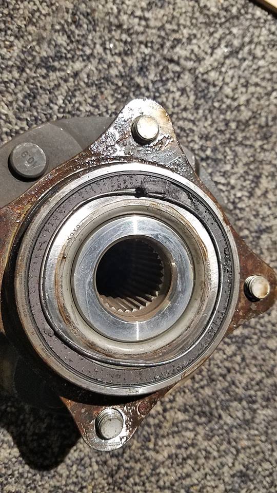

Anyway, when I removed the old hub assembly it was obvious. The magnetic ring that the sensor reads was destroyed and full of debris from the previous sensors. I thoroughly cleaned everything, wire wheeled and wiped with break cleaner several times. installed new hub assembly, buttoned it back up and after driving about 50 feet the lights are off. I put about 50 miles on so far and everything seems great.
