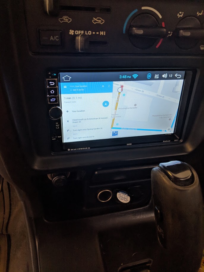

here is the one I have... Cheapest android unit I could find with GPS:
7in 2 Din Quad-core Android OS Bluetooth Car GPS Navigator 1080P MP5 Player- US$88.90 online shopping | NewFrog.com
Works fine. Took a month to deliver. I really wanted android so I could run TorquePro but it can't connect to my bluetooth obd2 device.
Works fine for playing music from my phone.
One of the reasons I picked the one above is because it works with torque pro and there are two bt chips in it which would be nice for items like an obdii and a smartphone. It looks pretty nice though. I just never considered the idea of an android powered hu
