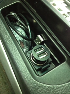

Hopefully not too obvious, but here's another option to add 5-volt power to the center console.
(1) get a low-profile USB 12-volt charger -- mine was 10 bucks at Frys for a 2-slot charger
(2) Disassemble the 12-volt cigarette lighter and remove the flip-cover. Search the forum to see how to remove the center console where the 12-volt lighter is.
(3) Re-assemble the 12-volt cig lighter and plug in the USB charger.
Since you've taken off the flip-cover and since the usb-charger is low profile, the console door will now close completely and hide your new mod. You can also remove the USB charger in case you need to the 12-volt socket. Piece of cake--the hardest part is removing the flip cover on the 12-volt socket.

i dont understand how this is different than buying a low profile USB charger and plugging it into the cig lighter? :confused:
Do the later models have that flip door that would preclude you from closing the door? maybe mine just doesn't have that at all
I think the point is that you can leave the charger in place AND close the door :fish:
I just use a low profile and it allows the flap to shut plenty to use the larger door. No need for extra modding.
You could always mount it all underneath and use a short USB cable. This one is done with the USB Cable from the Nav Unit. I apologize for the uncleanliness. Shes getting new Bilstein 5100's and a bath tomorrow.
