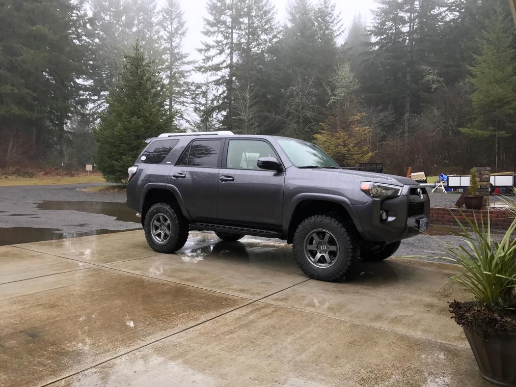

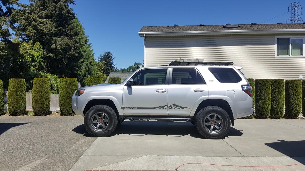

Fronts - bilstein 5100 (set to 0 no lift) paired with 2" OME 883 coils and an OME 10mm spacer on top of the strut assembly. THIS yielded about a 2.2inch lift in the front.
Tears - bilstein 5100 & OME 2895E coils with 1 single OME TRIM PACKER 10mm spacer on the drivers rear. This yielded a perfect 2" lift.
I am VERY happy with the way this setup rides. It's a match made in heaven. It rides really smooth, there isn't a ton of lean or yaw. It flexes really well off road. It's not harsh and it's far from soft. This is probably the best economy lift on a budget you can do IMO. Very inexpensive & no cut corners on reliability or performance. Will post some more shots once I get some

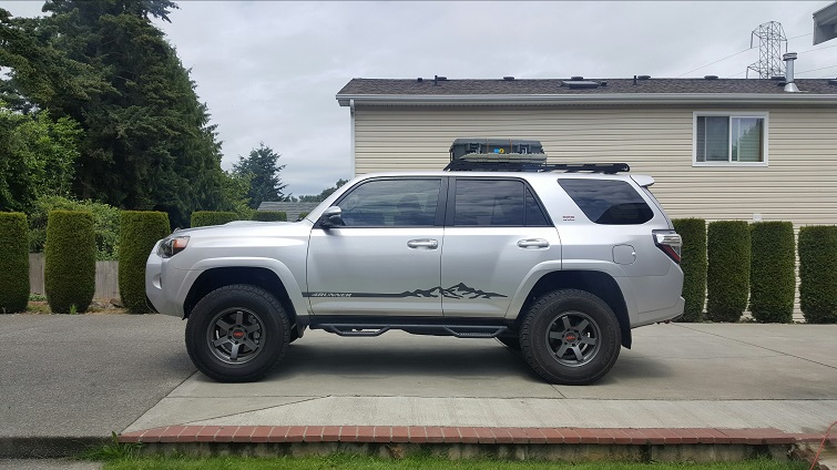

My old setup. 5100 with 884 and 895E unloaded in top picture and loaded with about 160 pounds of gear in bottom picture. Mine lowered a bit when it settled. I'd say it yield a 2.5" front lift.
