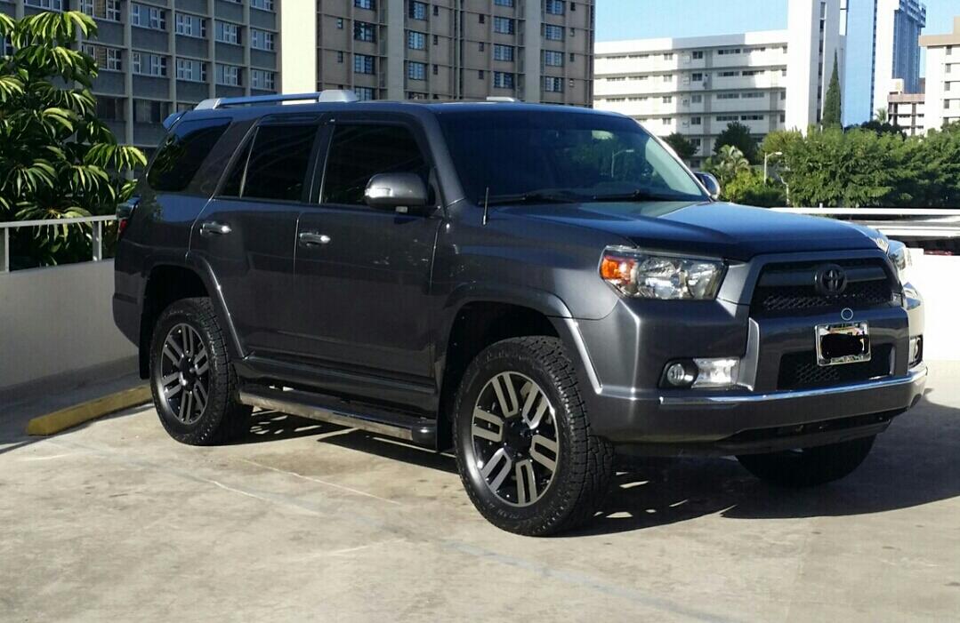

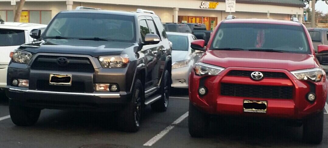

Bilstein 5100's 1.75 & Cornfed Spacers 1"
This is [MENTION=4880]colo4runner[/MENTION] 4Runner with a 1" rear Cornfed spacers and the front Bilstein 5100's set at 1.75".
Yep. 1.75 front with 1 inch rear spacers gives it a nice stance (lessens the factory rake), but doesn't really affect DD (that I've noticed anyhow).

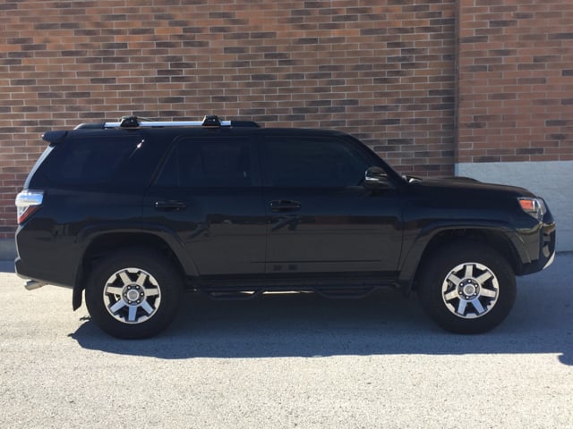

Heres another bilstein set up front 1.75, rear bilsteins with 1"cornfed spacers. Lift vs. Stock in the second pic.

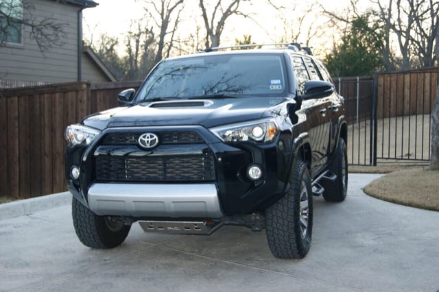

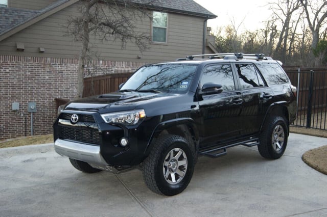

To each his own; you are more than welcome to try/do it.... But I'm telling you, somethings not right with that. Either he isn't on the highest setting, or something else is going on. TONS of us have all done this mod, and you WILL HAVE NEGATIVE rake with that setup. Heck, there is approx 1/4 inch negative rake at the 1.75 front setting and nothing in the rear (tho the fenders will look level).

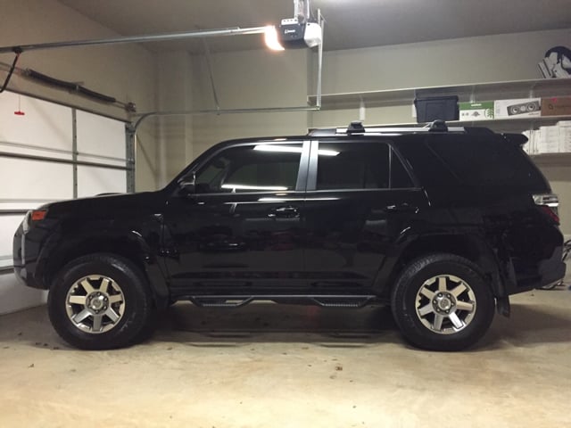

The pics below are 1.75 front (which is NOT the highest setting) and stock rear... And it's level to the eye, but slight negative frame rake.
Again, do as you please, it's your rig, your time, your money. But with a completely stock 4Runner, 5100s at all four corners, and the fronts set to the highest, you will not be level.

Yes. The pics I showed above were before I added the rear spacers.
