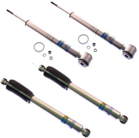

Sorry about that, definitely have the 885 (edited my post) so the medium duty. I'm thinking I don't want to do a 3" lift honestly. So I'll probably forgo the OME now knowing that. Good thing I got them at cost, can just resell I'm sure. I get a little mod happy since this stuff is so much cheaper in relation to my supra so I just kinda pulled the trigger too fast.
Honestly, I don't want to go more than 2" I'm more so wanting to level out and replace springs so it's not so "mushy" feeling. I will eventually get the GOBI roof rack, will get TRD skid plate.
No winch, no bumpers, no cargo drawers.
I do have some 17" SCS Stealth six wheels coming in. Will be upgrading tires, probably 265/70 or 265/75 depending on potential rub.
BTW, I lived in edmond for several years. Moved to Kansas City in 2010 for work. I lived off Western and the tollway for a while, also off Grand and May too. Played softball at Oklahoma City University.
Ok here is what I would do so your not duplicating parts but also have the option of upgrading at a later date.
Front 5100's at 1.75" - alignment and done, no UCAs
Rear 5100's - done
Sell the springs, if you lift probably be to rough anyway with no extra weight on the front end.
Tires- you can do 265/70/17 or 275/70/17 - If your towing the supra go with 265's if not I'd do bfg ta ko 275's and it would look great. I doubt you have any rubbing if your offsets are close to stock. If they rub it would be very minimal and easily fixed.

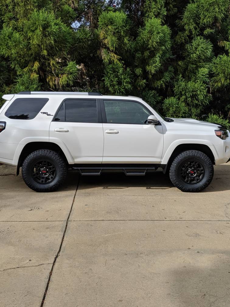

Here is 5100's set at .85, stock rear. I did tons of research prior to adding mine, .85 is perfect IMHO. Way to many people have reverse rake at 1.75, it is not worth it. Yea, their wheel wells look level, but everything else looks odd.
.85 Front lift

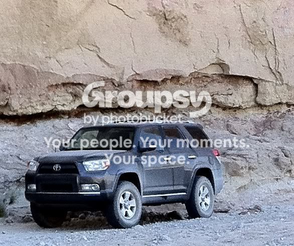

This is with just 1.75" setting up front and no rear lift.
90% of the time it sits perfectly level, 5% of the time the front is slightly lower and 5% of the time the front is slightly higher... all depending upon the ground level.
If anything, I'll just put a 1" spacer on the driver side to correct the lean issue which should lift the rear L about .65" and the rear R about .35" from what I've heard.

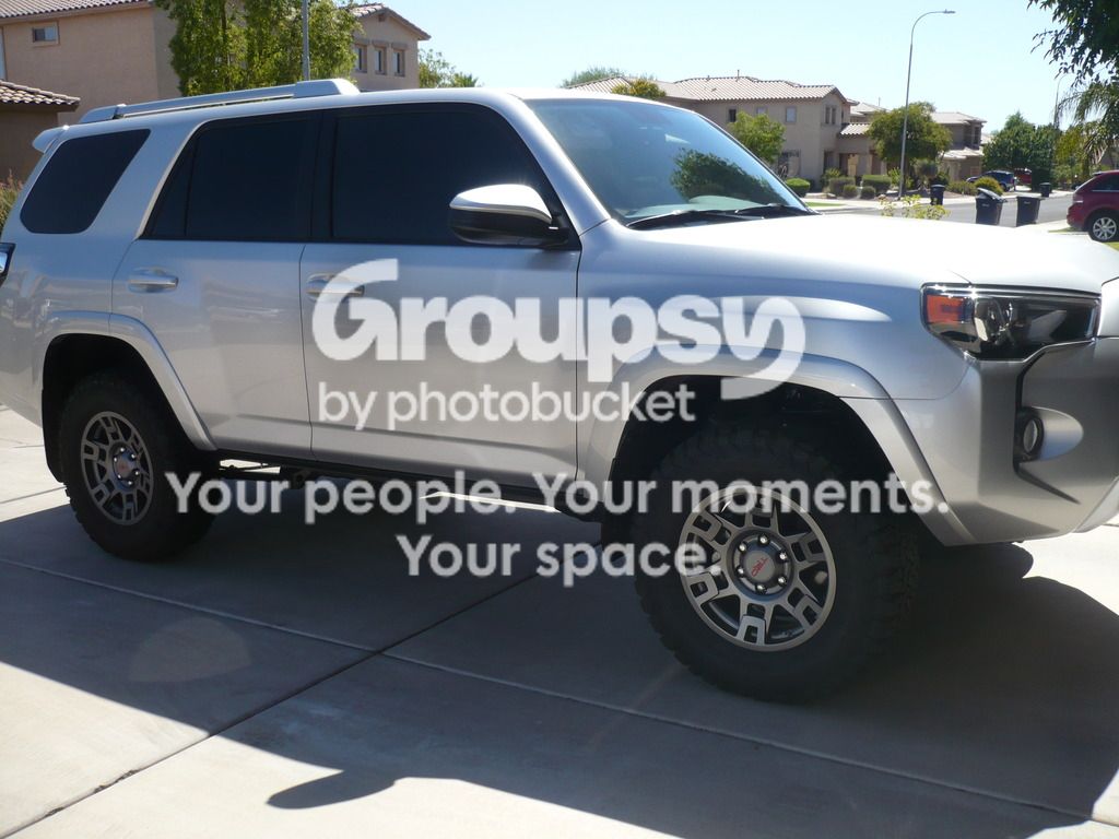

Here's 1.75 up front and Dobinsons 599 in rear. 285's haven't rubbed even a tad on road or off

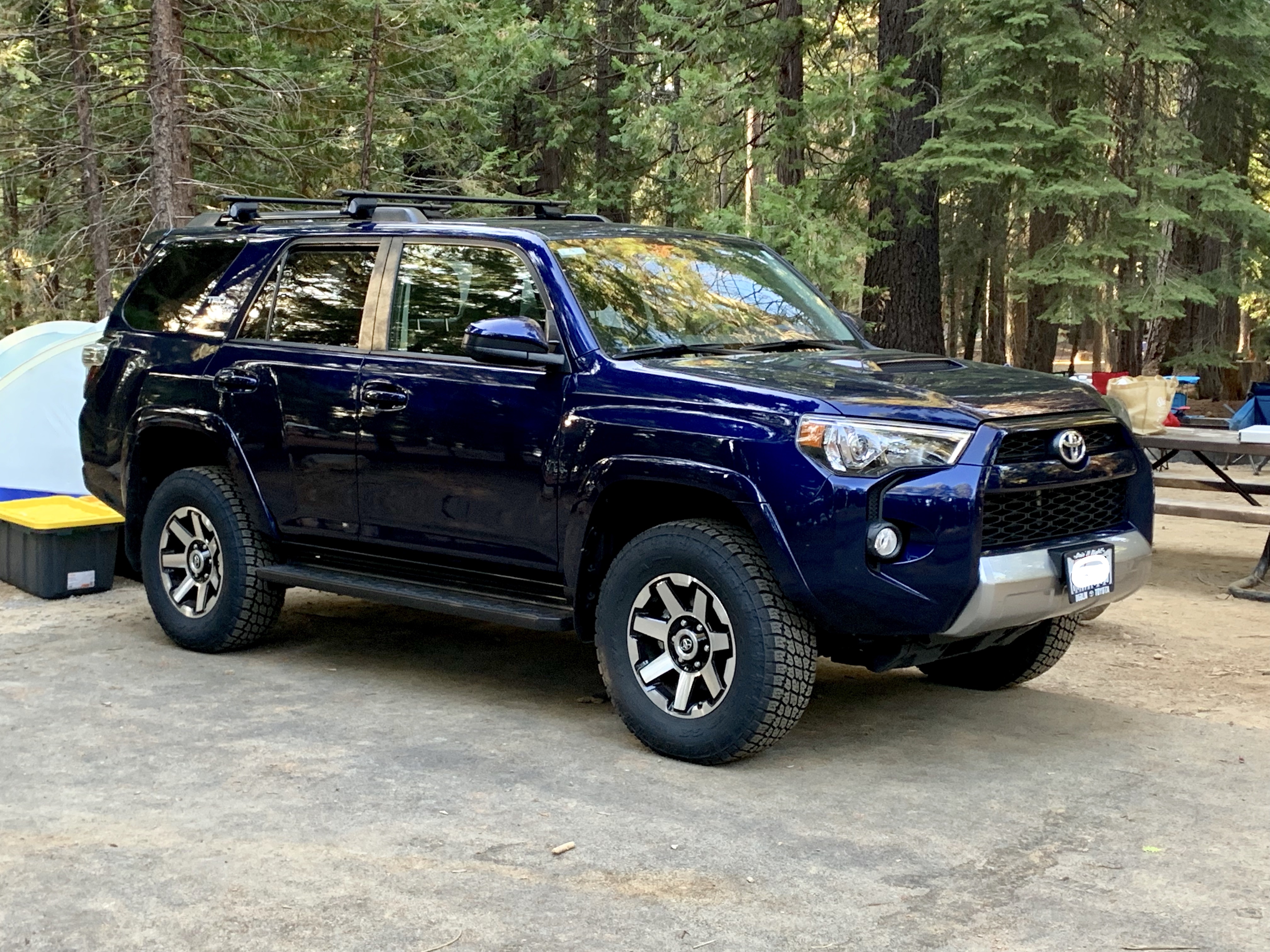

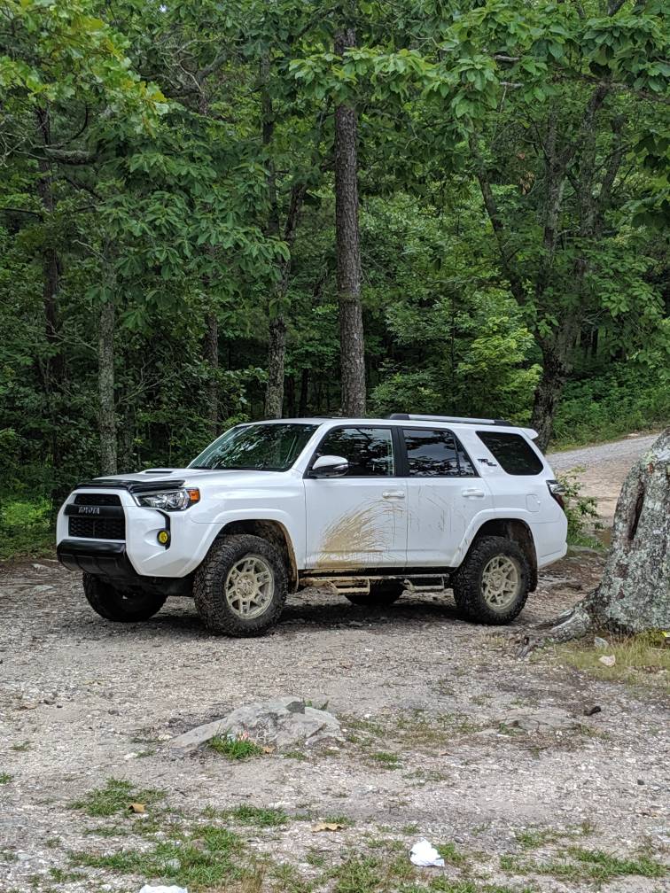

Bilstein 5100s all around 1.75 up front, 1" spacer in rear
I installed 5100s all around with the 1.75" setting up front and 1" spacer in the rear to preserve a little factory rake. All springs are stock. Then I threw on some 265/70R/17 Nitto Terra Grappler G2s and went camping! In this shot it's still nice and shiny before hitting the trails.
