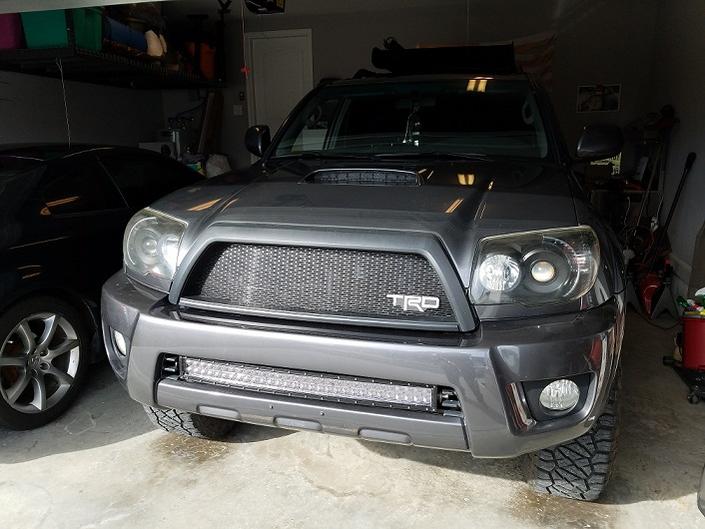

I disconnected my day time running lights bc it melted the plastic surround piece. I'm pretty sure that cut way down on the heat.
I did this mod today and wanted to share my results. Overall it was pretty straight forward following the OP instructions.
As stated that 4th screw to remove the housing is a b**** but take your time with this, if you rush you won't get the best results.
I made sure I took plenty of pictures. It took me about 4 hours to do everything. This mod was on the list for a while, love the new look!
I did 8 minutes on 250, pried a little, then did 5 more minutes to separate it completely.
When pulling them apart don’t go full-on hulk. If it isn't budging throw it back in the oven for a few more minutes. It should come apart pretty easy.

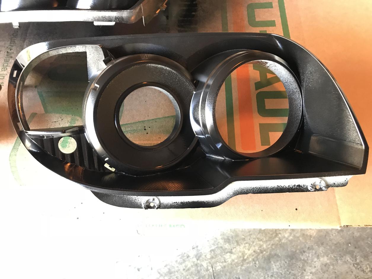

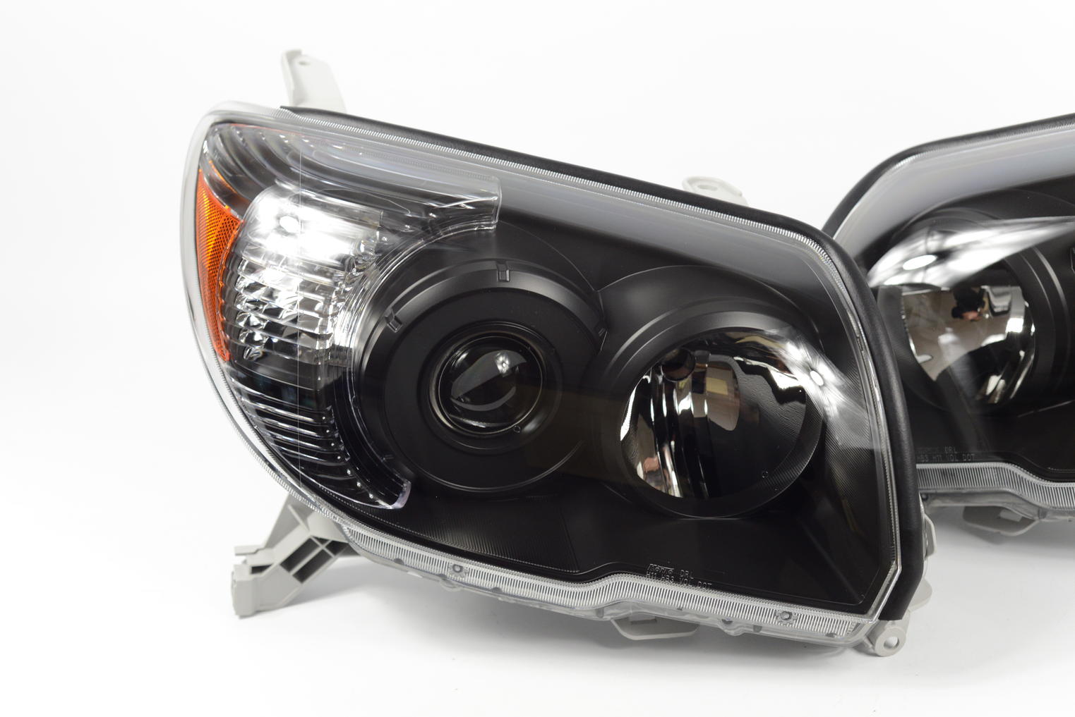

This is what you're painting.
This piece had a few people confused. You don't paint this. It's there to illuminate the blinker/DRL's, so leave it clear. You can remove the reflect though if you like.
After 3 coats of semi-gloss rustoleum.
Before putting it back together make sure you clean everything with a micro fiber to get rid of any fingerprints.
I put both halves in the oven together for 5 minutes, sealed it, and then put it back in for another 5 to seed it fully.
Final comparison
Doesn't at all, your not painting anything that deals with output.
I can't. See any of the OP's pics but I figured you weren't painting the light emitting portion. I was just curious if blacking out the reflective surrounding portion would decrease the output at all.

but as mentioned, you are not painting anything that affects light output. just the reflector part that goes around the lights.

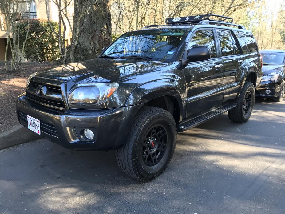

Thanks so much for posting this. Well done and very easy to follow. Your detailed pics help a ton! I plan to tackle this project this weekend. Cant wait to get rid of the old dingy and cloudy units. Wish me luck!

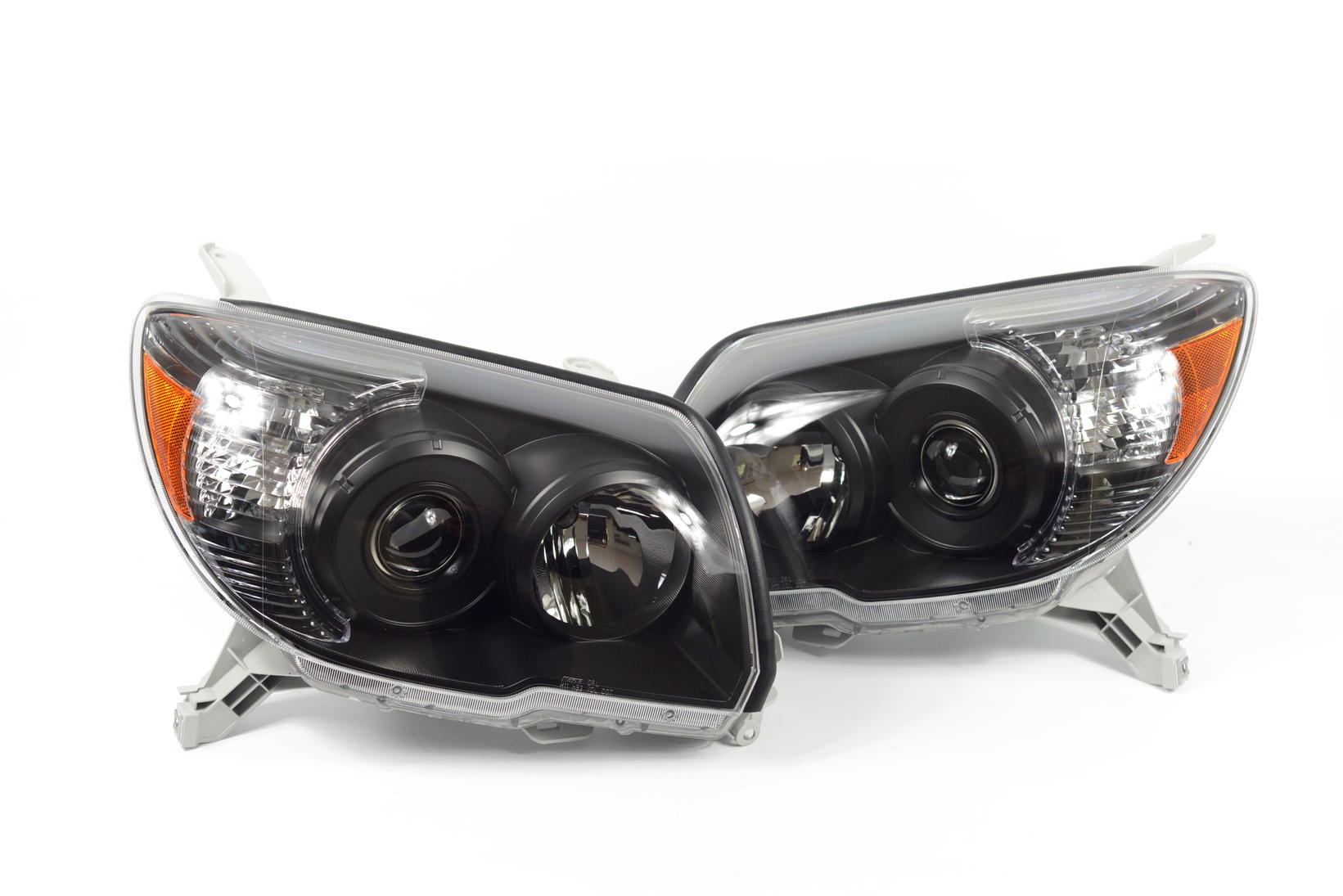

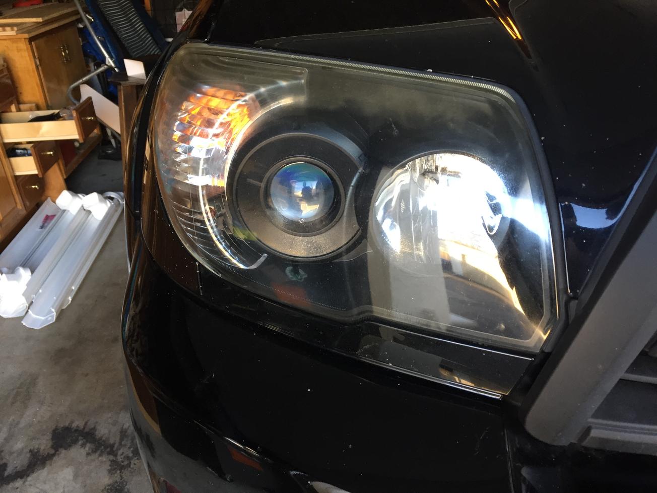

Blacked out headlights with satin black paint. I also used VHT nightshade on the clear corner lenses to give them a smoked look.

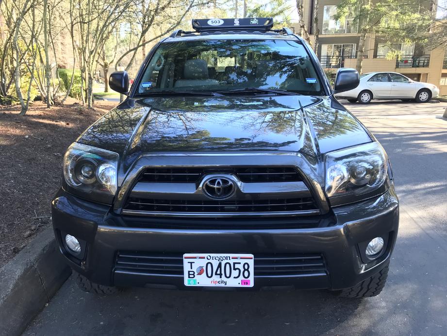

Blacked Out Headlights

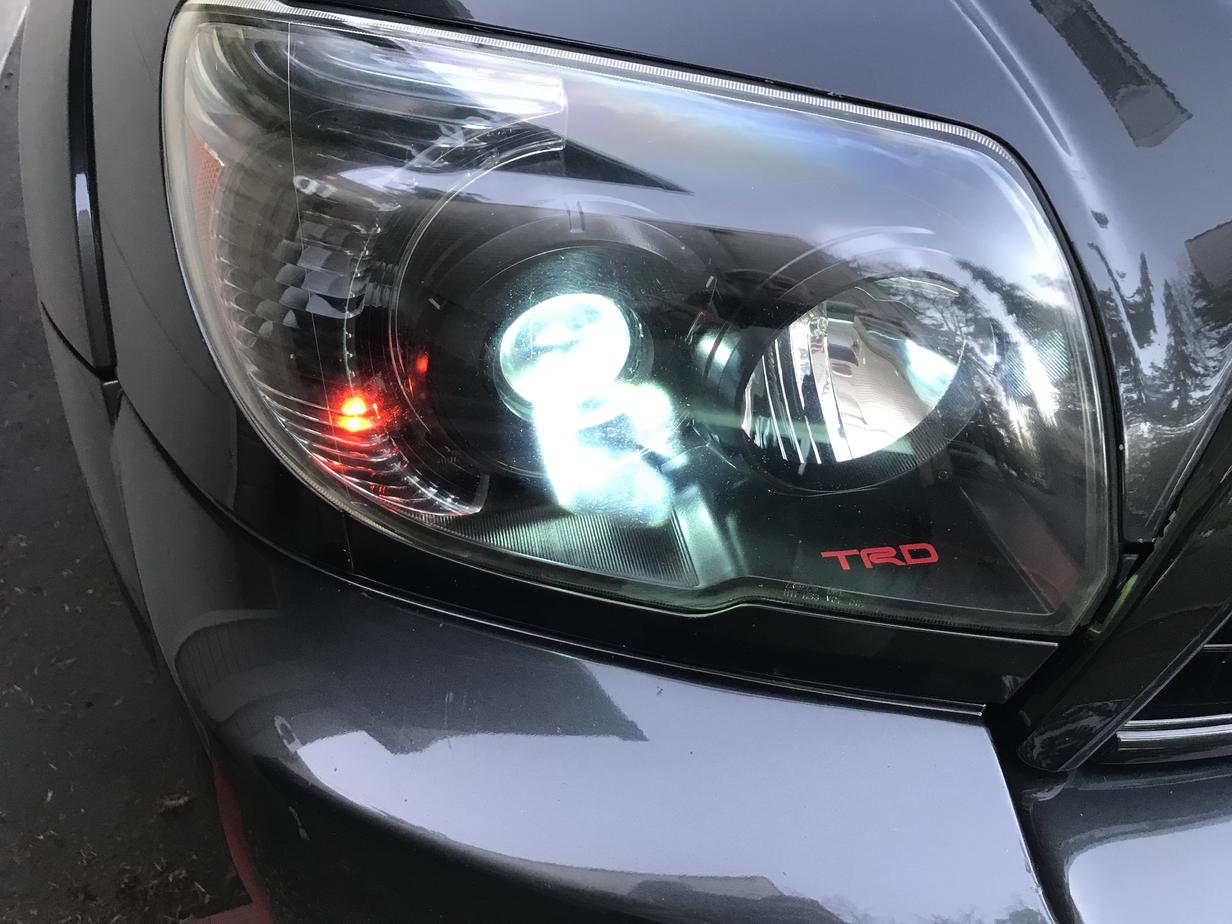

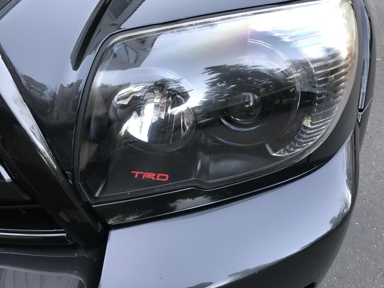

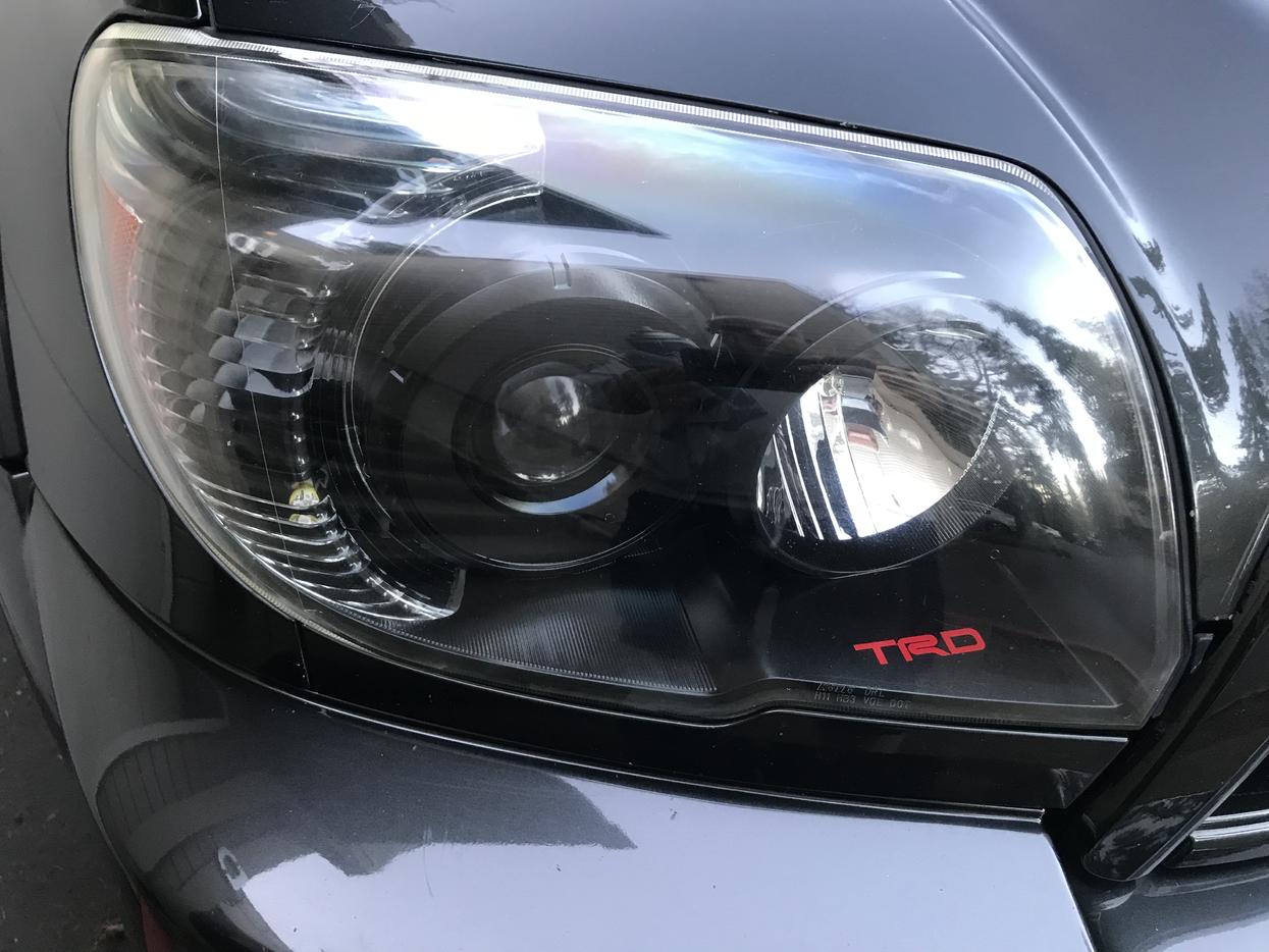

I finally blacked out my headlights. I followed tips from all the different posts on this thread including using the easy off yellow can oven cleaner to remove the chrome before painting. I did three coats of satin black primer and paint and I added a high temp TRD decal on the inside of the headlight to give it a custom look. I smoothed out the old headlight sealant and used Morioto headlight sealant to re-seal the headlights that I got on line for about $17. It took about four hours total but it was well worth it!
2008 SR5 4WD, 3INCH ROUGH COUNTRY LIFT, 285/70/17 FALKEN WILDPEAK AT3’S, TRD PRO WHEELS, HID HEADLIGHT AND FOGLIGHT BULBS, ROOF BASKET

did you removed the reflector where the turn signal is?
