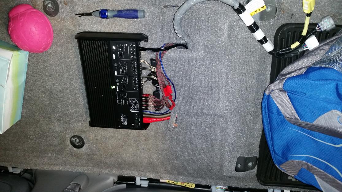

Well, went to the local car audio store I have dealed with fir years. Got a killer deal on a JL audio XD700 5/v2 amp. Fits great under the passanger seat. Got it 3/4 hooked up, will post the results later tonight

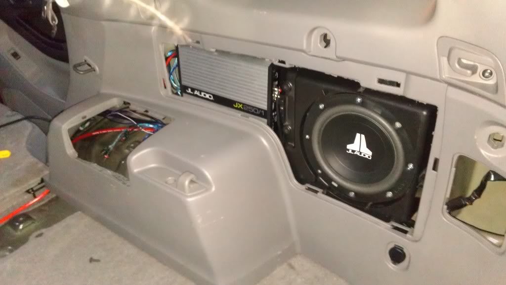

I uploaded a pic of some putting a jl audio JX 250/1 in the stock location. same size as the phantom.
Nice choice, those xd are killer amps. Even better are the HD's, but out of price range for a lot of people.
Got it all installed. Ran new speaker wire and connected it to to the stock wiring by the factory amp. Sounds amazing. Need to figure out how to tune it, I think I got the gain set, but I need to figure out how to do the hz part.
nice, you should take off the vent and run all the wires through that big opening. Its pretty much useless now. Its was pretty useless before, since there was that flap at the bottom of the seat the block the air in the first place.
where did you run the ground to?
google on how to set the gains right. It's easy but your gonna need some test tones. To tune the eq, your gonna need an RTA setup, I just listen to the peaks that I don't like and cut it. I'll probably set with an RTA one of these days.
