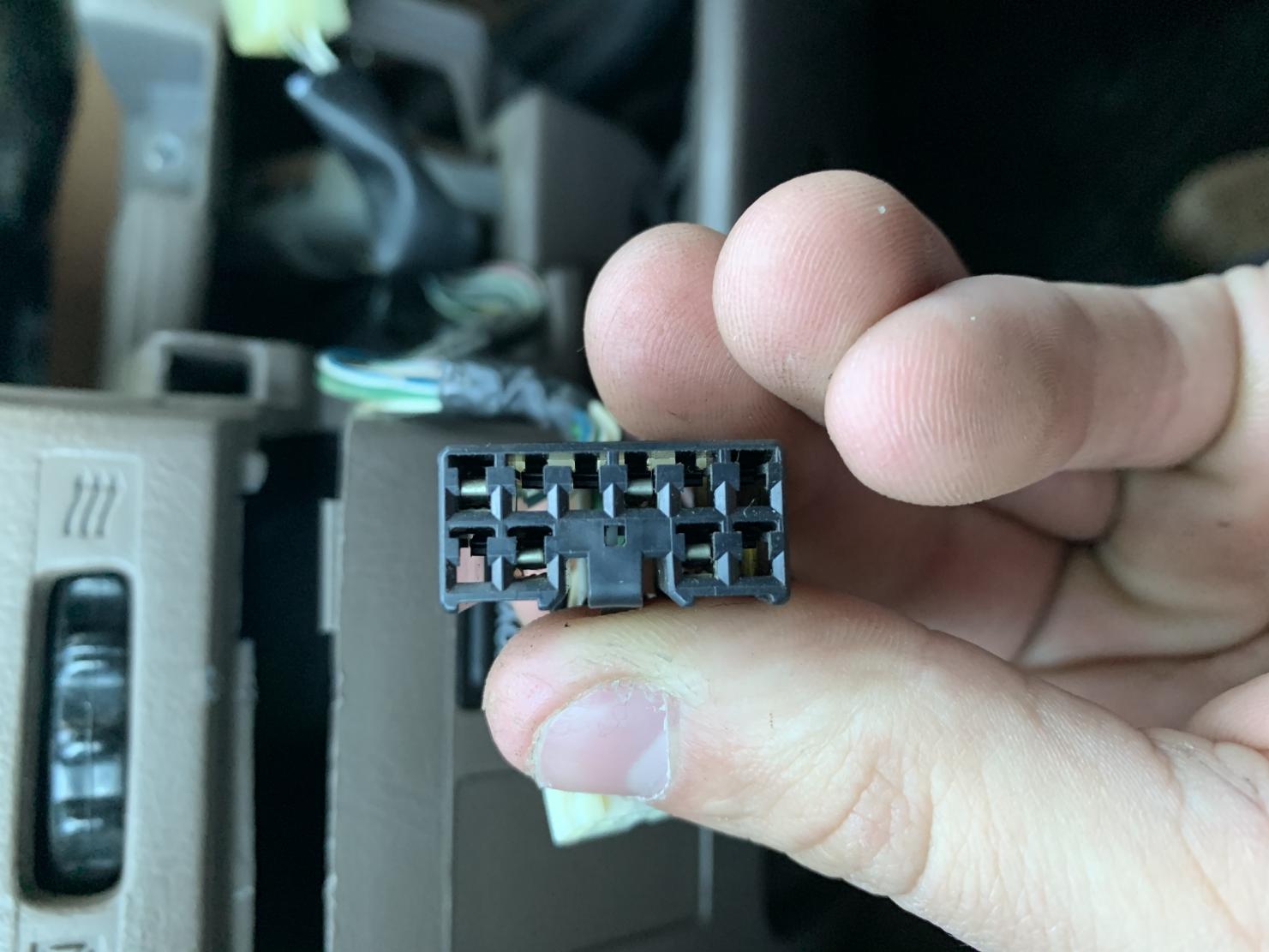

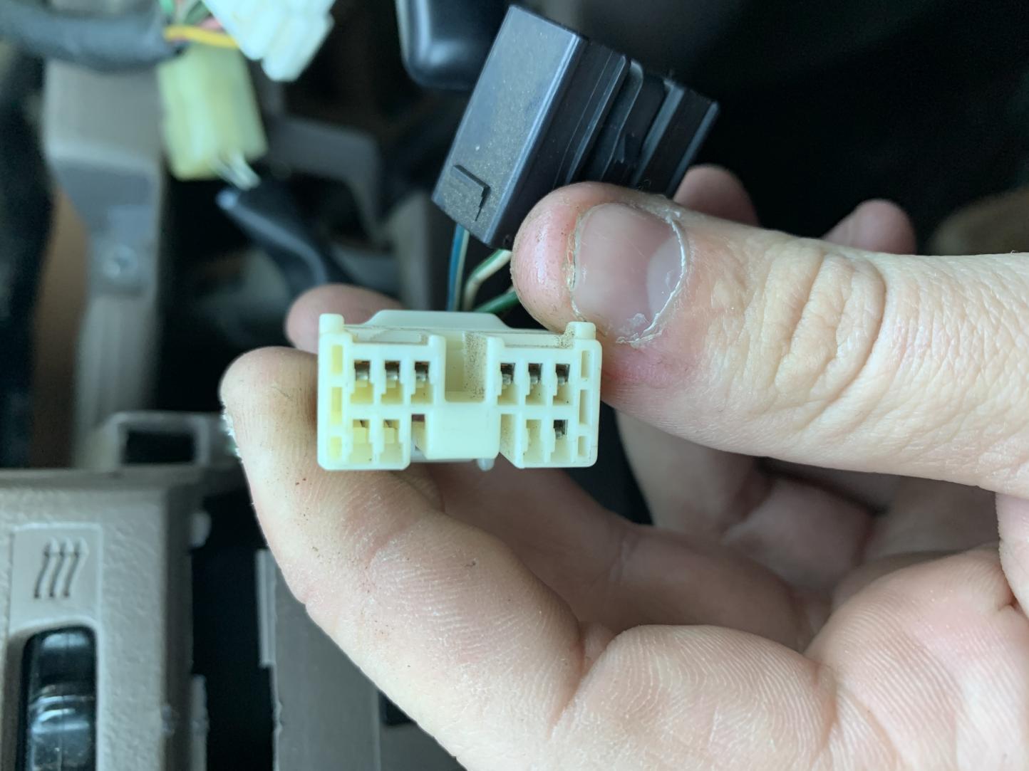

I don't think I'm prewired for elocker though, I've had the dash apart trying to figure out why my dome light doesn't work and have found no plug under the dash that the locker switch from my parts 4Runner will clip into. I did find two other plugs; a black one with four pins and a white one with seven
