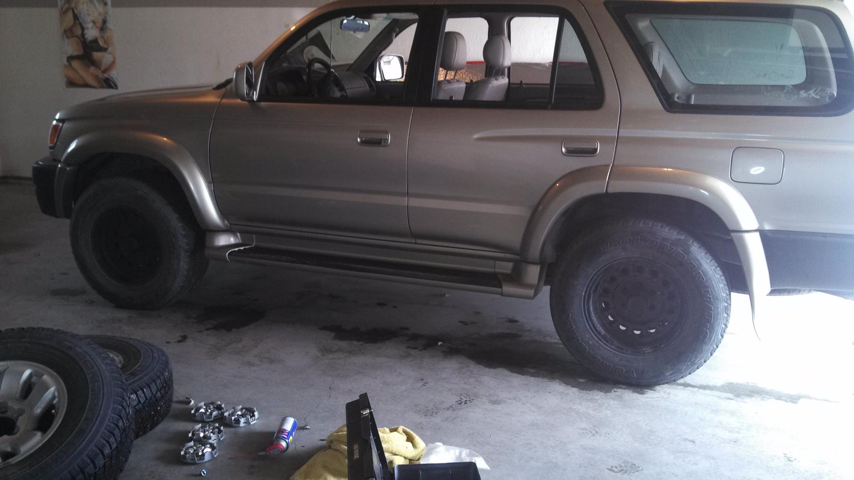

Hey all, picked up a 2002 V6 auto 130k miles for 8.5k a few months ago, the first pic is from when I put on the summer tires (oh yea, it came with 2 full sets of tires + rims). I can't figure out how to attach pictures inline with text in between, sorry, so they're all at the end.

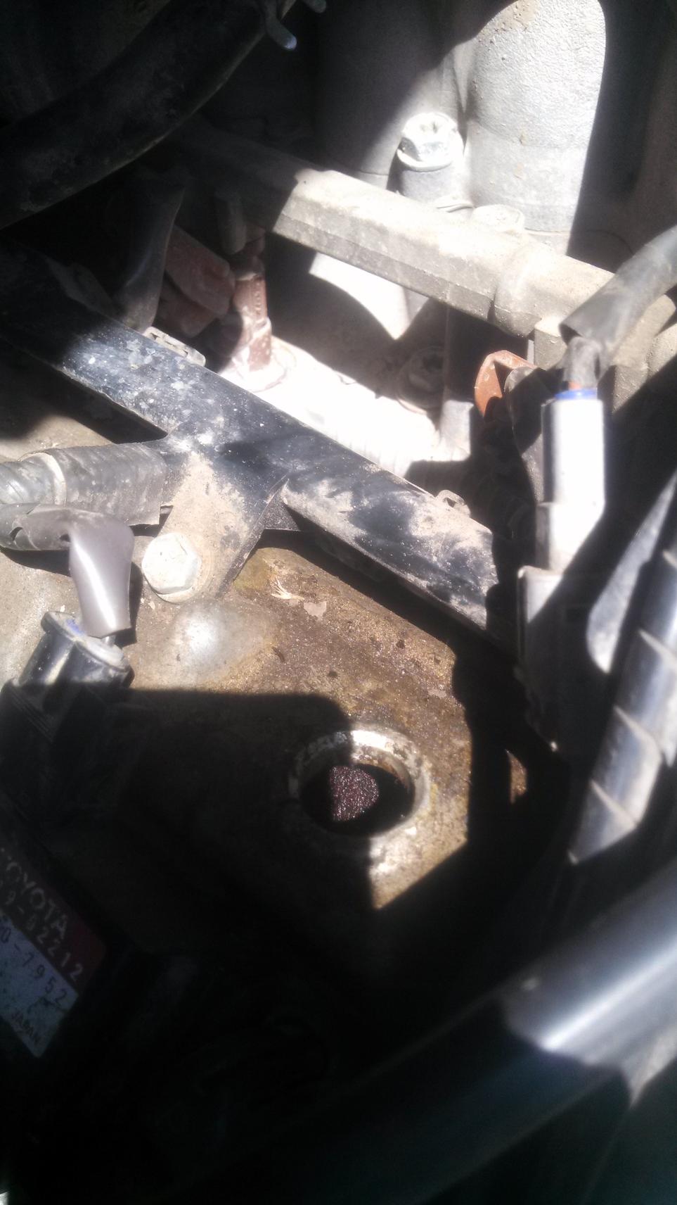

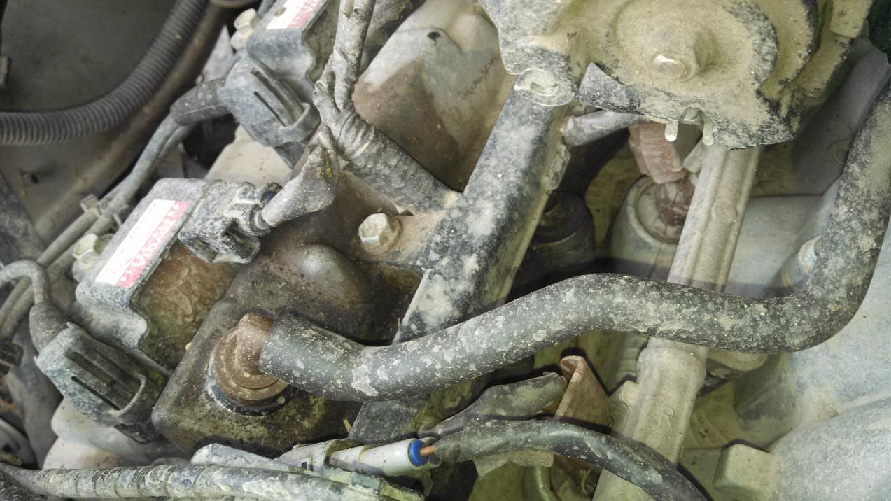

This second picture is of when I was changing the PCV valve, and noticed a significant amount of oil residue inside the manifold when I took it off that freaked me out. Sorry the pic is really bad, it's hard to get an angle with light in there. I did some searching on this forum and am not too worried now, I found out some residue is normal but couldn't find many pictures and felt like there's "a lot" in mine, or is that normal? Also, notice the oil around the hole where the valve goes. Is that was a valve cover gasket leak looks like? Again this is something I read is somewhat common, but haven't found many pictures of what that actually looks like. I tightened all the bolts (with no torque wrench), they all felt really loose. I should take another picture specifically of the valve cover. If the second one doesn't give the info you need, let me know and I'll go get another.

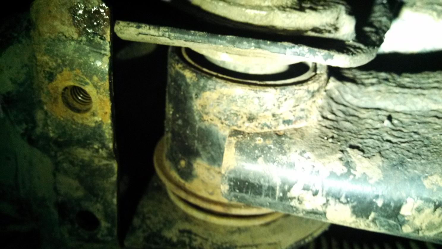

Second, that third picture is of...I dont know what it's called (wishbone maybe?). It's the lower arm of the front suspension, driver side, where it attaches to the frame. There's a gap where it looks like a rubber bushings should be to stop the "wishbone" from sliding around, but obviously there is none, and same on the passenger side.

That is where the PCV valve goes, right? Assuming it is, that residue is on the top side of a splash shield inside the valve cover. Somewhat normal. Hopefully the rest of the top end doesn't look like that. Did you use a new grommet for your PCV? You did dumb question.
Do you have a sway bar? Are those holes where the end links go?

I have a sway bar, it doesn't connect there. This is the connection arm from the lower spring and strut to the frame, there are two spots on the frame that look like this. Its a large horse shoe shaped piece. Pic is on the frame side, towards the engine.
hmmmmm..... something about the truck looks odd..... Sport Flares with NO sport hood? Looks like the truck was either in a front end accident of the owner bought a set of sport flares.

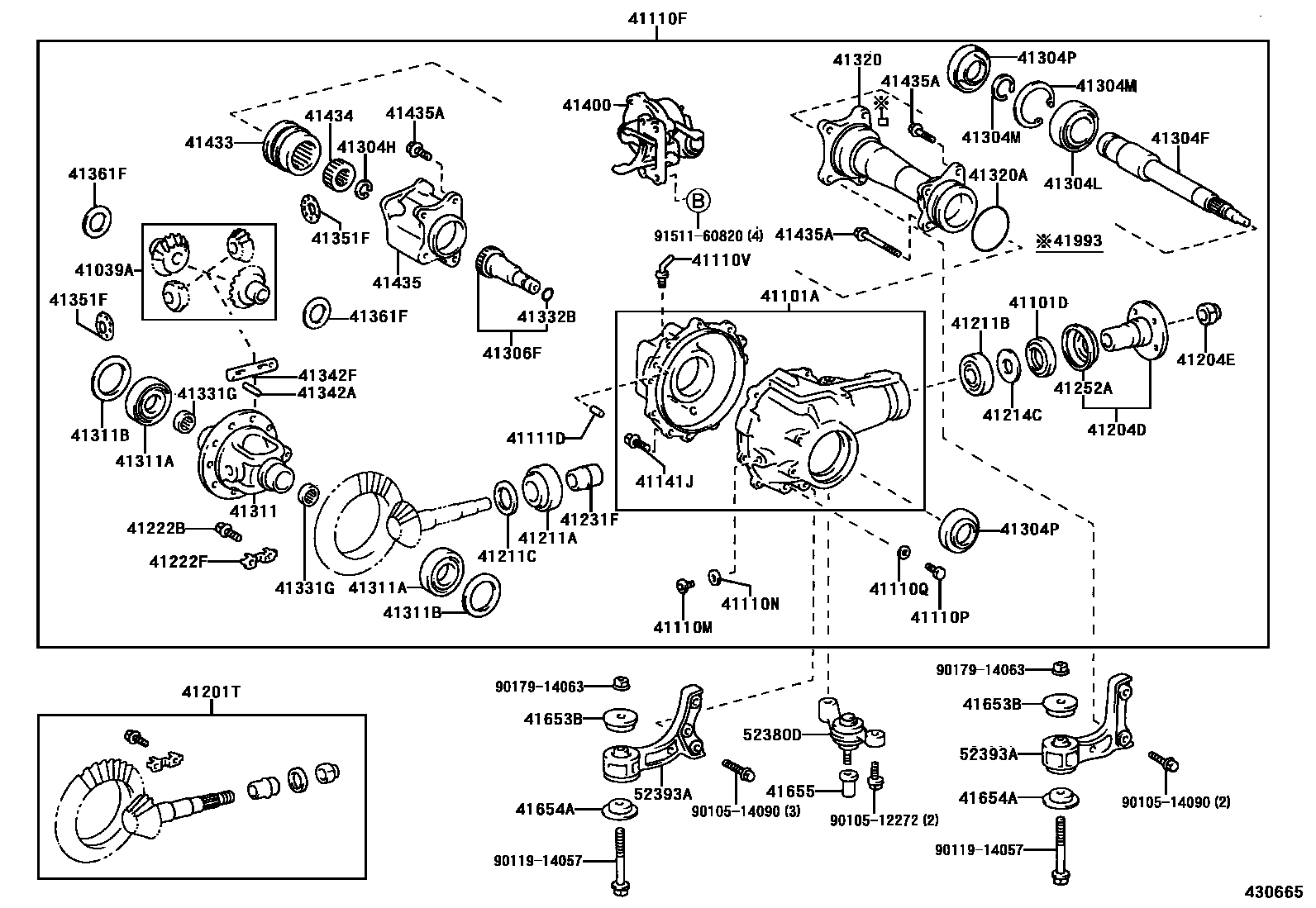

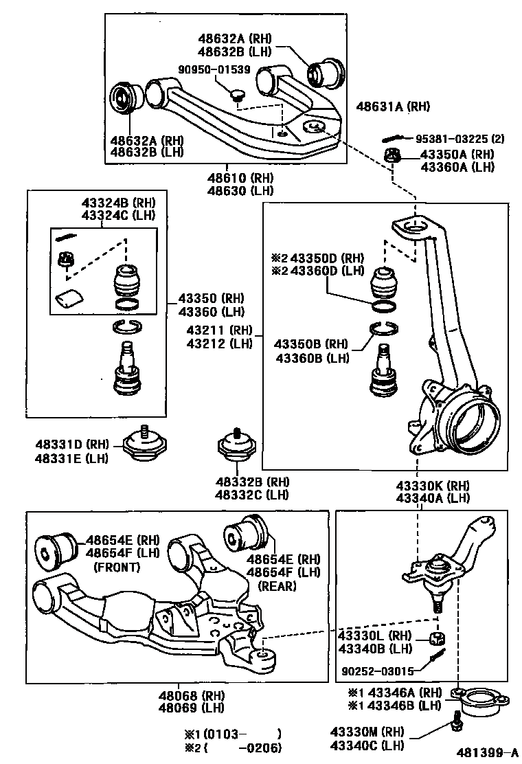

Ok after rereading and looking really close at the pic, I believe you're referring to the lower control arm bushing. Maybe the outer lip has broken off. There should still be rubber inside or else you would be metal to metal. The rubber is vulcanized to the inner and outer sleeve. If that's not what it is then maybe it's the front differential support. Let me see if I can get some exploded views to help you identify your part.

Great news if the residue under the splash guard is normal. What about the oil residue on the outside? Think that leaked out from the old PCV valve grommet? (which yes, I replaced...not dumb question haha). I attached one more picture from a different angle, with the new valve in. It's dirty, but the oil is obvious.
The part is the bottom left one in your second exploded view, 48454E. Based on that diagram I have nothing to worry about, there's no other part that goes in the gap I was concerned about.

Based on the pic, yes I'd agree what we can see around the pcv is most likely due to a little seepage from the old crzppy grommet.
