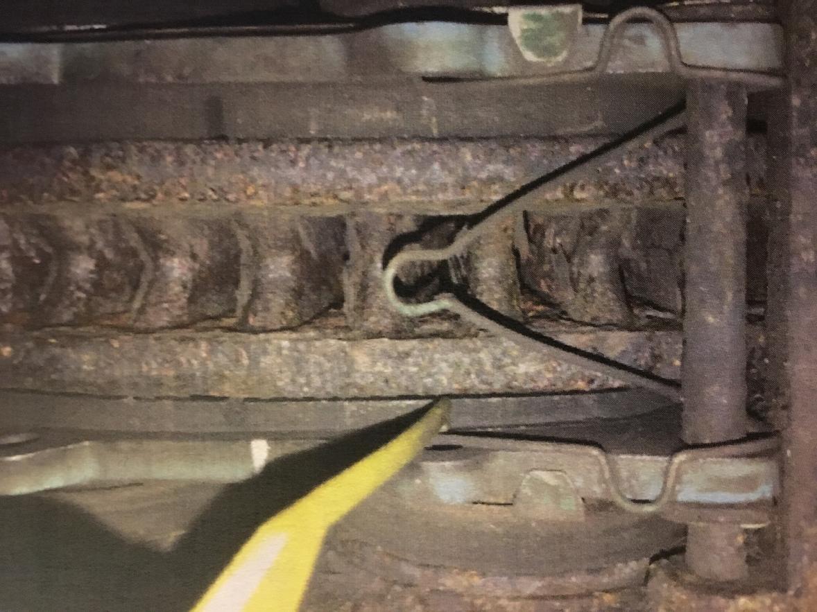

One of the most important things that make pads stick and wear fast etc , the stainless pad clips MUST be removed and cleaned with wire brush and more importantly the rust cleaned out from UNDER them where they sit in the caliper holder if not the rust forces the clips up and pinch the brake pads , I remove mine and sand blast the area and then put a light coat of syn. brake lube on the area to prevent rust then put clips back in .
Files and wire brush on drill will work also just be sure not to hit guide pin rubber boots and rip them or remove them before starting
Also refrain from putting any type of lube on pad ends or stainless clips it will attract dust and dirt and gall the area up and prevent pads from releasing , This must be done as it is the most common reason why pads stick and wear uneven and prematurely , I live in the rust belt also and this must be done , I do it once a year when I put my winter rims/tires on
. On the fronts I take pins and pads out and wire wheel pins and lube them with silicone paste and use a sharp flat blade screwdriver (pretty much the only thing that will fit ) to scrape rust build up off where the bottom of pads sit ( be careful not to hit piston cylinder rubbers )
I also give my pad faces that sit and touch any part of the stainless clips if rusty , a quick light rub with a file to clean them before putting them back in.
Its become routine for me living in the most salt infested climate there is and it keeps by brakes working perfect as I let it slide when I first bought 4 runner and burnt off a rear set of pads in 30K miles , they were froze solid in their holders and not releasing

Caliper issue
I definitely have a caliper issue.
