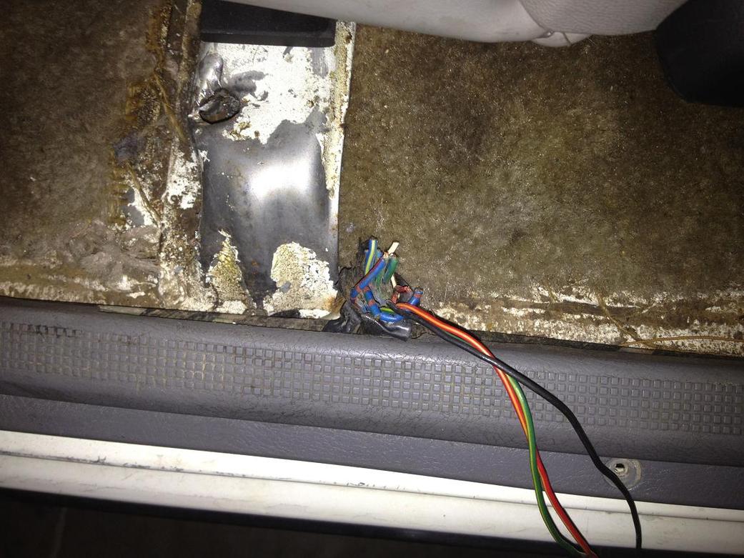

OK I know there are lots of threads about this and I am still reading through them but not finding the answers to my specific questions. Hopefully you all could help.
When I bought my runner the PO was raising and lowering the back window with a drill battery (missing center console and wiring harness cut - see photo). He unplugged the connector in the tailgate and attached a long wire that stretched all the way to the cab and when you wanted to raise/lower the window you touched the appropriate connectors to the battery terminals and then it worked though it is terribly inconvenient.
I came across a guy with an '88 v6 SR5 runner and his runner's back window goes up and down using his key in the tailgate. I was hoping that this would work in mine so I reconnected everything and no go.
Is the key in the tailgate trick supposed to work on all first gen 4runners? Is the busted wiring harness the reason it's not working?
FYI - The back door light on the gauge cluster is functioning properly so there seems to be some functionality back there. PLEASE HELP!

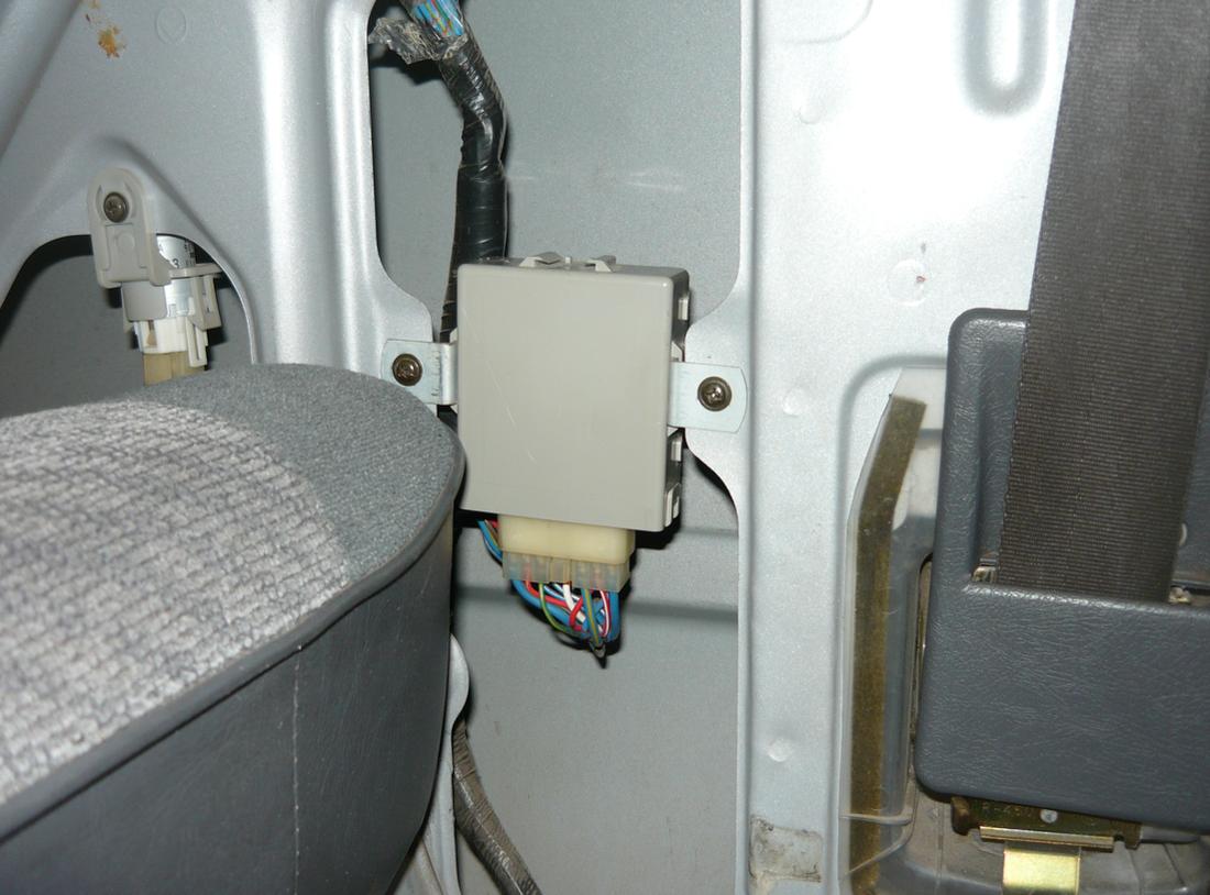

Yeah the key should work. Check to make sure the 2nd bolt from the rear, driver's side, is installed on your top. It activates the sensor to ensure the glass is not raised with the top off. Also some say to check the wiper arm to make sure it is seated fully. Mine has never been affected by this but apparently it does affect some.
Also not sure how and where he ran the wires but if the PO jacked with the relay in the driver "B" Post then the key and console switch wouldn't work. Both switches go through the relay before providing power to the window motor.

If he was using external power to raise an lower, possible that wiring to window control relay (pic in helo-mech's post) is messed up, or relay itself is broken, or he was directly running rear window motor to bypass limit switches because they're broken or out of adjustment. Try tracing harness from under driver's side door threshold to window control relay (gotta undo side panels), and see if all wires are connected to connector properly like here:
Check against schematic here (full FSM link on my signature):
rad4runner-albums-rear+window+control+mod-picture25614-rear-window-control-system.jpg
Pin Numbering here:
Hard to explain how limit switches work, but assuming they are OK, Even if console switches are removed, as long as relay is functional, key should be able to lower/raise because it's a different circuit. See schem above.
Below checks should give us a better idea of what's going on.
Assuming relay is good, wired good, and only the key switch is bad, you can simulate what key switch does as follows:
Wire to pin 11 (light blue-white stripe) when touched directly to chassis ground will lower window.
Wire to pin 12 (lt blue-blk stripe) will raise window.
Touching directly to ground bypasses top off switch.
You can do this by carefully stripping off insulation on wires above.
If this test works, chances are only the key switch is defective.
In same manner, touching wire going to pin 4 (Green with yel stripe) will lower window, and Pin5 to ground (Red yellow stripe) will raise it. This where console switch connects. Connecting directly to ground bypasses console rear window lock and rear door lock detection switches.
If both above work, you know your relay and limit switches are and you only need to fix console and key switches or wiring.
