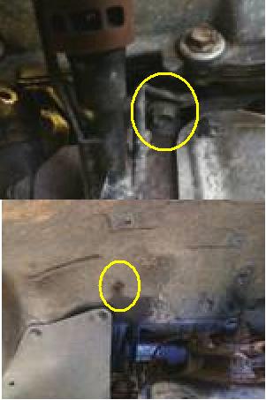

This may be redundant but if you remove these yellow circled bolts you will be able to separate your transmission downtube and remove the top half getting it out of the way (top pic of bolt on trasmission downtube to be removed). The second bolt (bottom pic in wheel well) removed will allow you to move your brake lines further out of the way so that you can pull your starter completely out of the wheel well area. Be careful with those brake lines so that you don't bend them too far.

How the crap do you get the top 14mm mount bolt out? I see very little clearance to turn a socket. I tried a 14mm gear-wrench in between the exhaust pipes from the side, but couldn't get enough torque on it. From below, the bottom bolt looks possible, but I need a swivel. The top? I have no clue...maybe a 1" extension and a swivel, with a long breaker bar?
I've already taken everything else apart, so the truck is now stationary until the parts come in on Tuesday. Going to need to run to Ace for more tools, I guess.
You're right, that bolt is a toughy! It's been so long now since I did this I'm having a hard time recalling what I did, but I didn't have a swivel at all (I hear this would have been very helpful in this situation). I have a breaker-bar type socket wrench so I'm sure that's what I used, then used a much smaller ratchet to get it out quickly. Good luck!
Well, after trying just about every tool I have, I finally got the upper mounting bolt out! Ended up pulling the starter down towards the sway bar, and took the cap off there. Seemed a little easier than working around the brake line from the wheel well.
