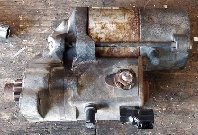

I just took mine out and replaced the contacts today. What a b***h that was on my rust bucket. I had to remove the transmission dipstick and the sway bar body mounts. I have no idea how anyone managed through the wheel well... Figured I'd summarize everything I've read:

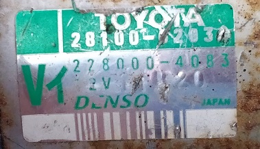

Our 3rd gens come with either a 1.4kW or 1.8kW starter. From what I have gathered, the 1.4kW is for manuals and the 1.8kW is for autos. Some of the part #s below might have changed, but these #s should get you there.
The 1.4kW starter is Toyota part #28100-62050, Denso part #228000-5300(I think).
It's plunger is Toyota part #28235-55050.
It's motor contact is Toyota part #28226-74070.
It's battery contact is Toyota part #28226-64200.
The Victory Lap ND-34SOL is for the 1.4kW starter.
The Dorman 02349 Starter Rebuild Kit *might* work for the 1.4kW starter.
The 1.8kW starter is Toyota part #28100-62030, Denso part #228000-4083.
It's plunger is Toyota part #28235-54380.
It's motor contact is Toyota part #28226-72010.
It's battery contact is Toyota part #28226-54380.
The Victory Lap ND-36SOL is for the 1.8kW starter.

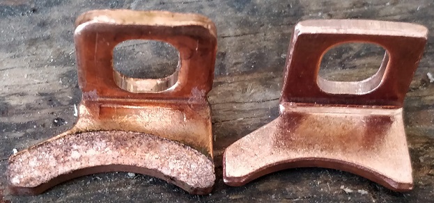

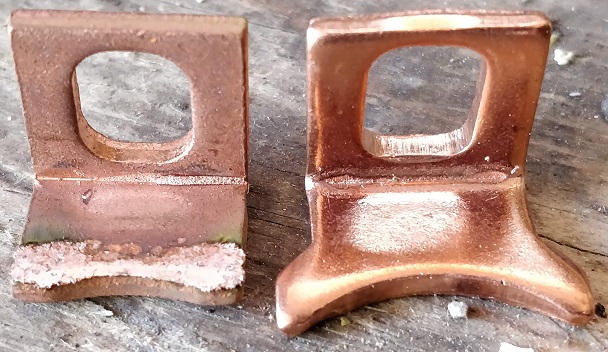

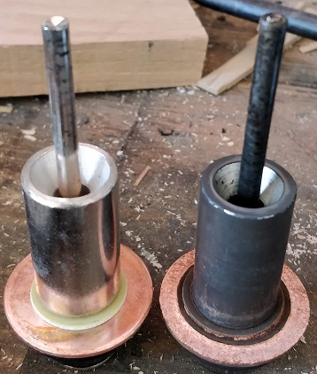

The Victory Lap ND-36SOL plunger has a larger diameter contact which is nice, it also has a bunch of different contacts in the box so I used one that was slightly bigger than the original. Pictures below.
EDIT:
I just took mine apart again because it wouldn't chooch. Turns out that the FSM has some instructions that fixed my problem. You're supposed to press the contacts into the starter using small wooden block and a hand press @ 981 N. Then, while they're pressed down, tighten the terminal nuts to 17 Nm. I used a vise and calculated the approximate force(neglected friction) I needed to apply to the end of the handle to get the right pressure on the contacts.
Side note:

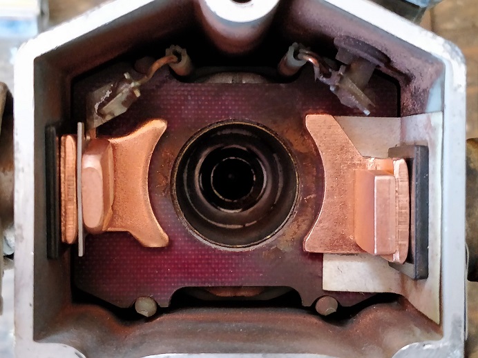

I took the whole starter apart to check for other mechanical or electrical issues. It all looked brand new; the brushes had less than a half mm of wear(over 18 years!). These beauties are built to last, so if you think your starting problems are caused by the starter motor, you're probably wrong.
