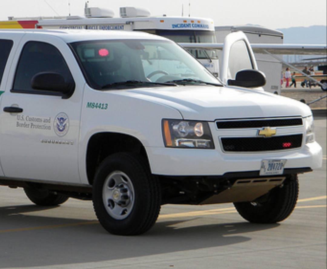

Did the tman chop on the front bumper today. I'd really like to cut everything from the light bar down and run a sleek prerunner style bumper/skidplate all the way back similar to what usbp does to all of their tahoe's. I still really want a relentless fab bumper but this is significantly cheaper and I can fab this up in my own garage and save lots of $$$$$
