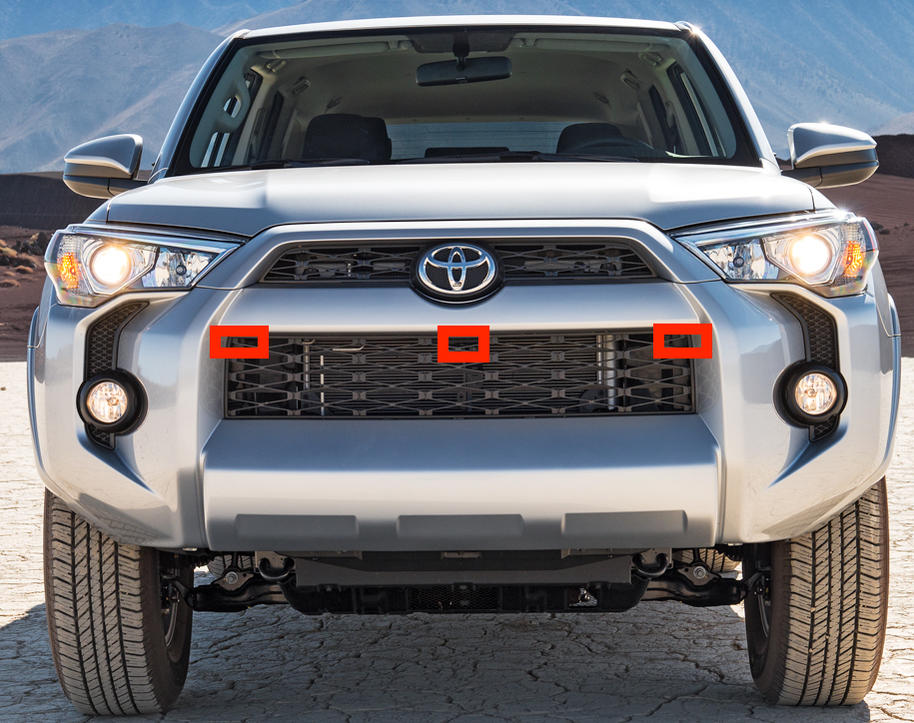

Haven't picked up my 4Runner yet but my first mod will be adding my ALP quad and blend mounted passport 9500. Has anyone done a laser jammer install on 4Runner? I realize it's probably not the first mod most people think of on a 4Runner. I seem to have lost my "need for speed" but I have the system and plan to install just for unexpected speed limit changes when traveling.
I'm looking for pics on jammer head placement? I'm thinking I will need 3 up front only leaving 1 for the rear and no protection against dragon eye lidar gun.

I just got a '21 TRD Pro 4R and will be installing 3 ALP heads in the front. I'll need to make a cutout on the lower part of the grill below the TSS sensor hardware but I think the ALP head will fit within the shape of the grill opening.

I installed my ALP 3 head system on my 19 4Runner, first thing i installed besides my V1. I'm no speed demon anymore but situational awareness is very important still. Mine is paired with my V1G2. I also specifically bought the 2019 because it doesn't have any of the nanny systems that can interfere with my countermeasures.
I don't need the RX for the dragon eye so i went with regular TX heads with that exact placement since that's really the best spacing. I should have something for the rear but its rare i get hit that way.
