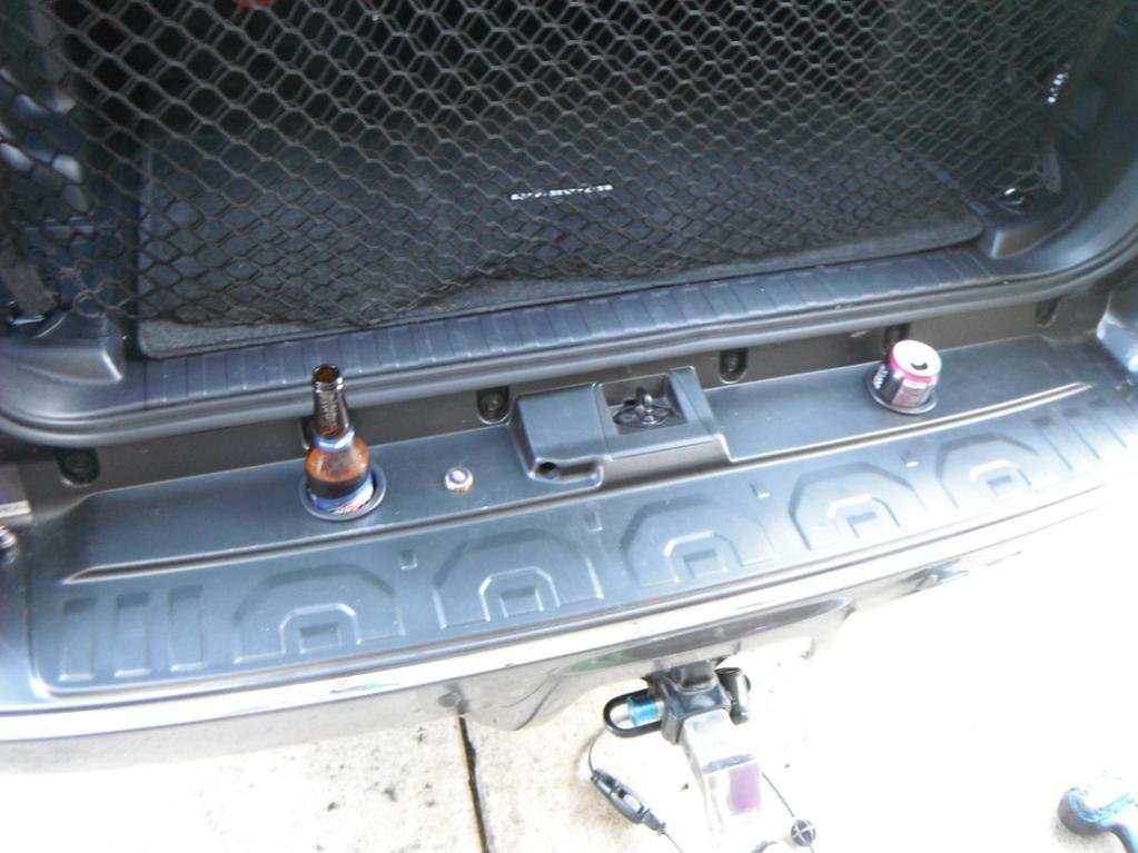

This is the edge you measure from for the hole (same on both sides)
Look how much room there is! And you thought you were going to drill into the spare tire didn't ya? Admit it...
TAILGATER CUPHOLDERS
Did the mod tonight and it came out great. Used the exact same cup holder. However, 1.25" from the edge would have been way too close so 1.75" worked for me. In the end my placement seems exactly as Antmans. 13.25 seemed right but on my Limited I was greeted by a metal bracket taunting at me through the passenger side hole. Upon inspection it was the bracket that held the Tire Pressure sensor and there was no way the cup holder would fit. The bracket is held to the truck by one bolt and the sensor is held in by two screws. I got rid of the bracket and wire tied the sensor up and out of the way. Hope it does not cause issues down the road.
I did use a 2.75" hole saw but still needed to dermal it out just a bit to make it fit snug.
