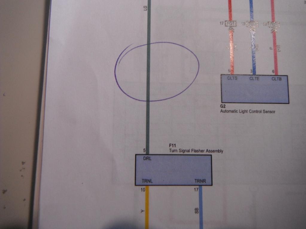

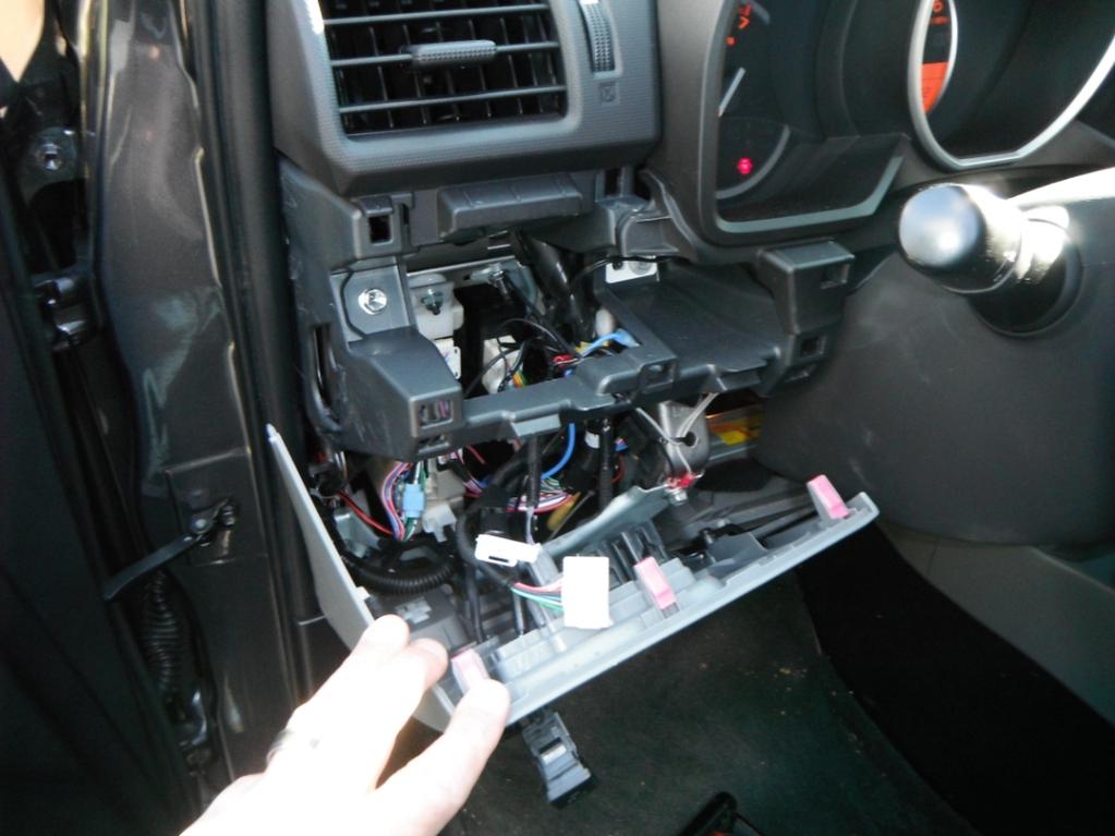

This is the wire you need to tap into and ground. Plug #F11-White, Pin #5. The wire color is light green.
Now would be the time to praise Nashman69g for posting the EWD...again! :)
Grab this panel and pull it towards you to access the plug - no tools needed.

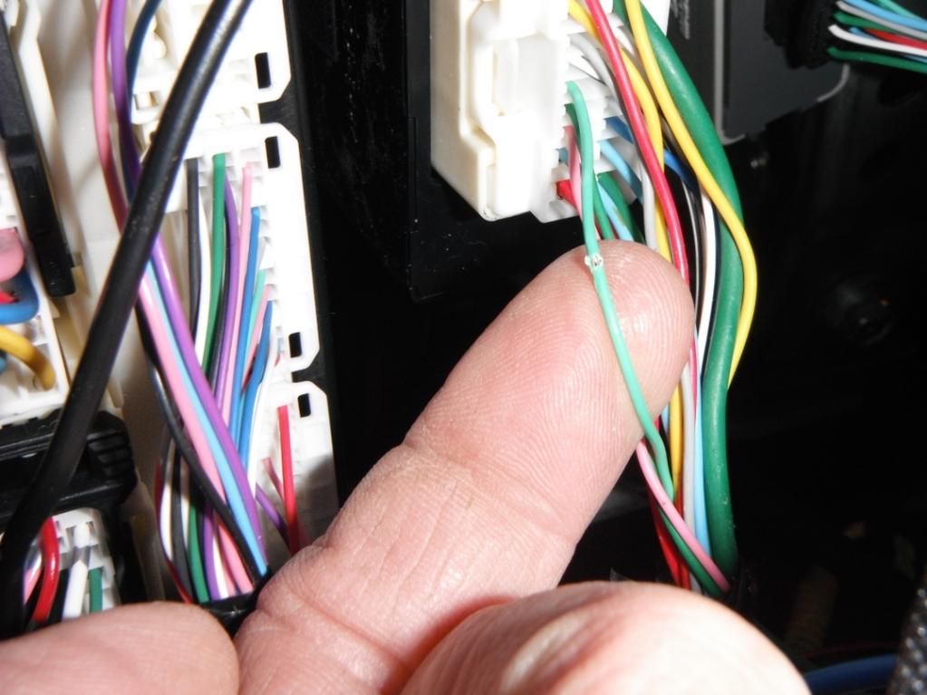

Here is the wire. You can see the hole in mine from the test probe...

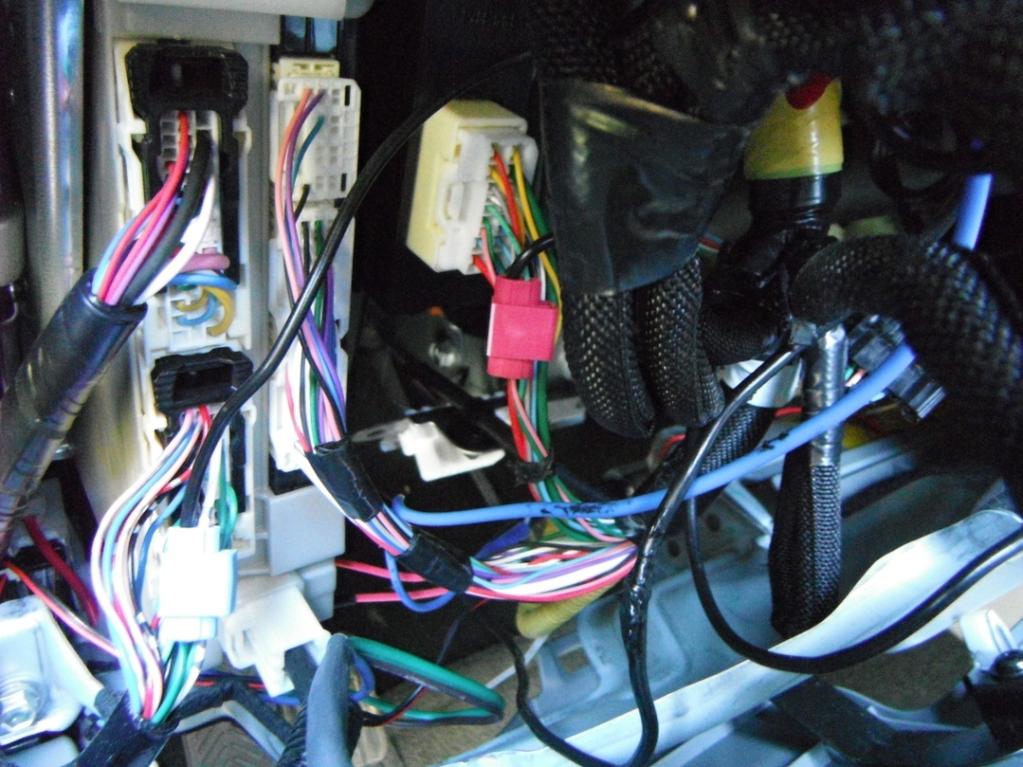

Use a pink 3M wire tap, or similar and tap into the wire to connect a wire lead for the ground.

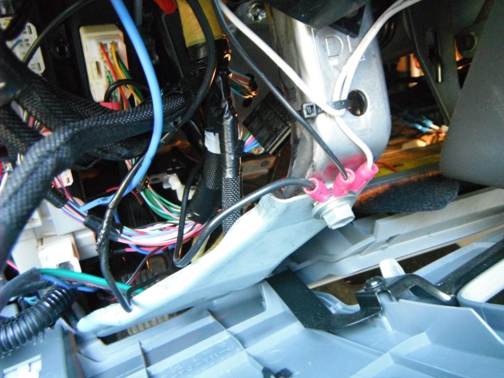

Here is a good ground that's close, same as used for my Fog MOD.

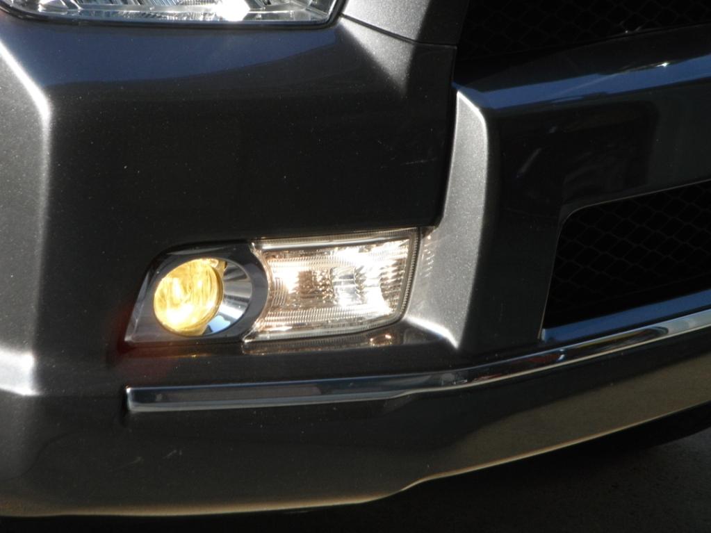

Taaaa Daaaaaa

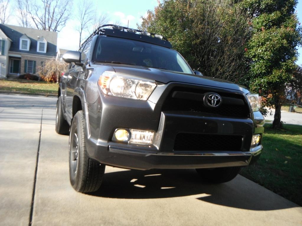

Fogs+DRL ( I have ultra white DRL bulbs, and yellow PIAA fogs)
EVERYTHING ON (Headlights, Hi beams, Fogs, DRL's) I know it's hard to see...
As I stated before, the DRL's will be on whenever the truck is running.
If you want to still be able to turn them off, simply run the tapped wire lead to a switch, and the other terminal on the switch will need to be grounded. I will do that next unless I can figure out how to turn them off with the stalk again...

ANTMAN MOD #9
Always on DRL's (Daytime Running Lights)
Some of you expressed that you would like your DRL to be on whenever you want. In stock form they automatically turn off whenever the headlights are on. This MOD is very easy! Took me 5 minutes (after the troubleshooting session.... ;): )
The DRL will be on anytime the truck is running, regardless of which lights are on or off. The stalk will not turn the DRL's off anymore (I may work on that one later ) :)
If you want to be able to turn the DRL's off, I'll explain that in a minute.
Oh yeah, your turn signals will still work as normal.
Let's get to it...:party:

Taaaa Daaaaaa
Taaaa Daaaaaa

Yet another question for you Antman; do you know of any 1156's or 1156A's which are close to the look of the PIAA fog's so that they were the same yellow color or is that why you opted to go with ultra whites on your DRL's? After seeing your Fog's I want to go that route and since they are different in color I am thinking unless someone knows of a 1156 bulb in the yellow color (rather than amber) I may go bright white or even slight blue tint on the DRL's now.
I don't know of any 1156 bulbs that will match the PIAA fogs- but I'm far from a lighting expert... If you really want to find out- ask the forum(start a thread on it). I'm sure someone on here has an answer for ya... :)
