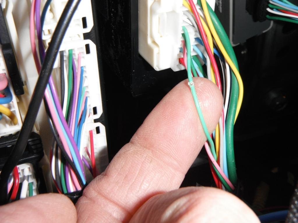

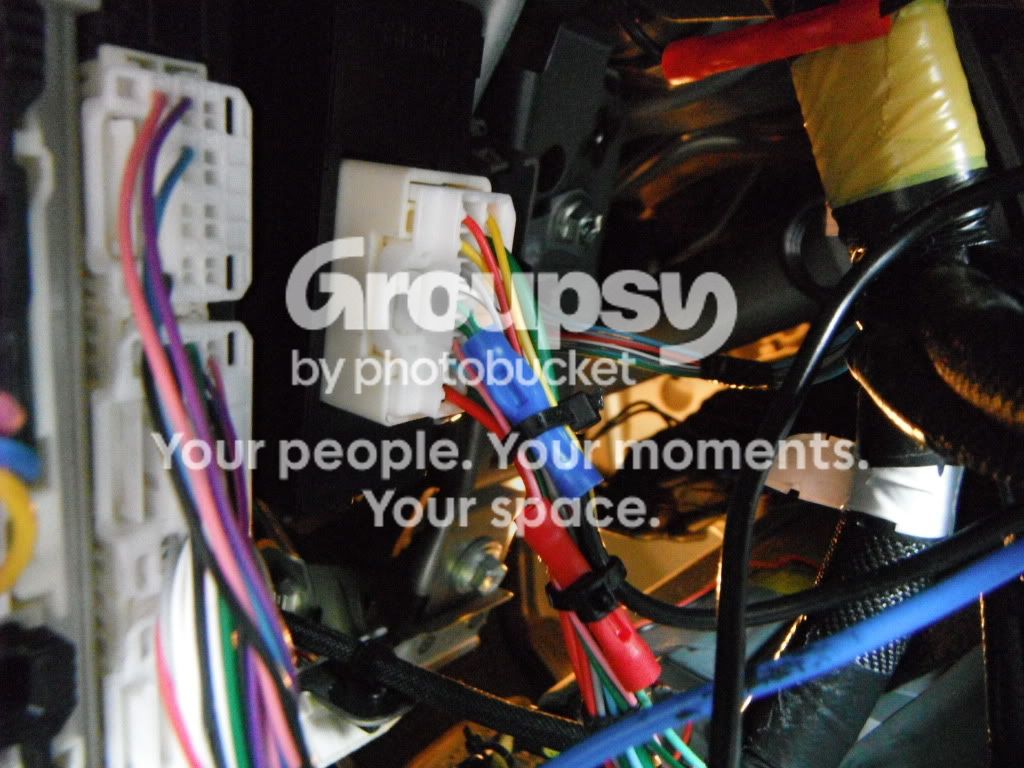

OK, so I need some help. I did the DRL mod last night, an everything has been fine... better than fine - the lights look(ed) awesome! That is until about an hour ago. My driver side DRL bulb blew. I knew something was up when I was driving and my left turn signal started blinking super fast. I pulled into a plaza and got out to see that indeed the driver's side DRL was out. I drove over to Auto Zone and picked up some new bulbs. I installed the new bulb (with the truck off), started it up and walked to the front. NO driver's side light. Turned off the truck and took out the bulb again to make sure it was seated correctly. Except the bulb looked foggy, so I took it out and saw that the bulb was instantly blown! My dilemma is now that the passenger side works just fine. Driver's side... another story apparently.
I assume I have a short? Any suggestions would be GREATLY appreciated!! :beer:
I just looked over the wire diagram, and it appears you blew the main computer. Just kidding. Sorry! :)
Ok- it looks to me like when you tapped into that light green wire on plug F11, you either cut the insulation, or nicked the yellow wire on that plug as well. Yellow is the hot feed for the drivers DRL bulb. Seems to be grounding out somewhere under there.
How did you tap into the wire? If you used the 3M tap, it's entirely possible you squeezed the yellow wire while terminating the connection.
Take a close look!
Take a close look!

Anyway, I took everything back apart (becoming a pro at this by now - both the dash and front bumper) and took a very close look at the wires. Yes, I did use a 3M tap but I didn't touch any other wire other than the light green wire. Anyway, I will mess around with it another time, but for now, just took off the ground wire - and reverted it back to factory stock. So now the DRL's come on with the stalk, and off when the headlights are on.
At this point I'm really unsure what could have went wrong...? :gun4:

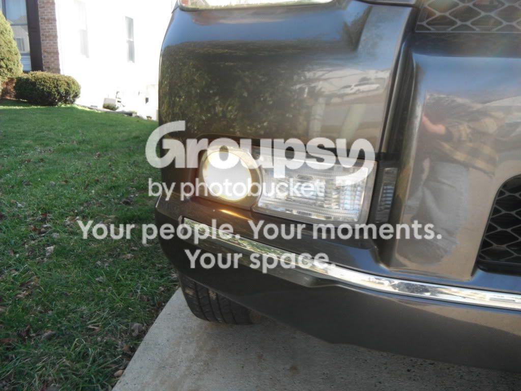

I am running Hyper white bulbs in the DRL's, and PIAA yellow fogs. I like the fact that the DRL's look like driving lights while they are on (albeit not extremely bright). The PIAA's are awesome as well, especially in the wet...
Problem is, when I switched the yellow PIAA's on, they look kinda dumb with the DRL bulbs on. Like this:

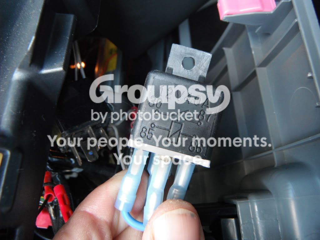

Basically, you will replace the standard relay you used for the Foglight MOD, with a 5 prong relay, and change the ground setup.
DSCF0904.jpg~original

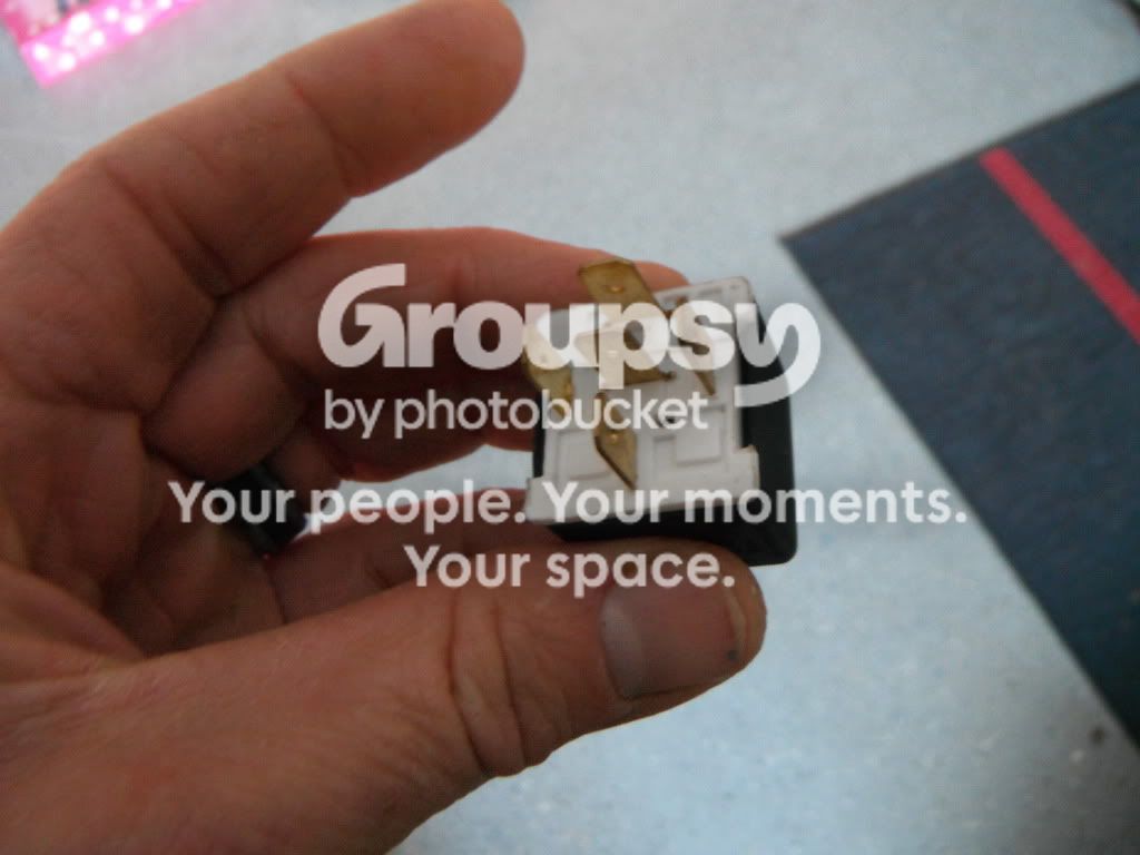

This relay will have a terminal marked "87a". What on earth will this do? I'll tell ya. This extra terminal is like the evil twin of terminal #87, which is grounded from the Fogmod. When 87 is grounded, 87a is open (not grounded), and visa versa.
SO.... replace the relay for the Fogmod. Plug everything in exactly the same, leaving 87a open, for now...

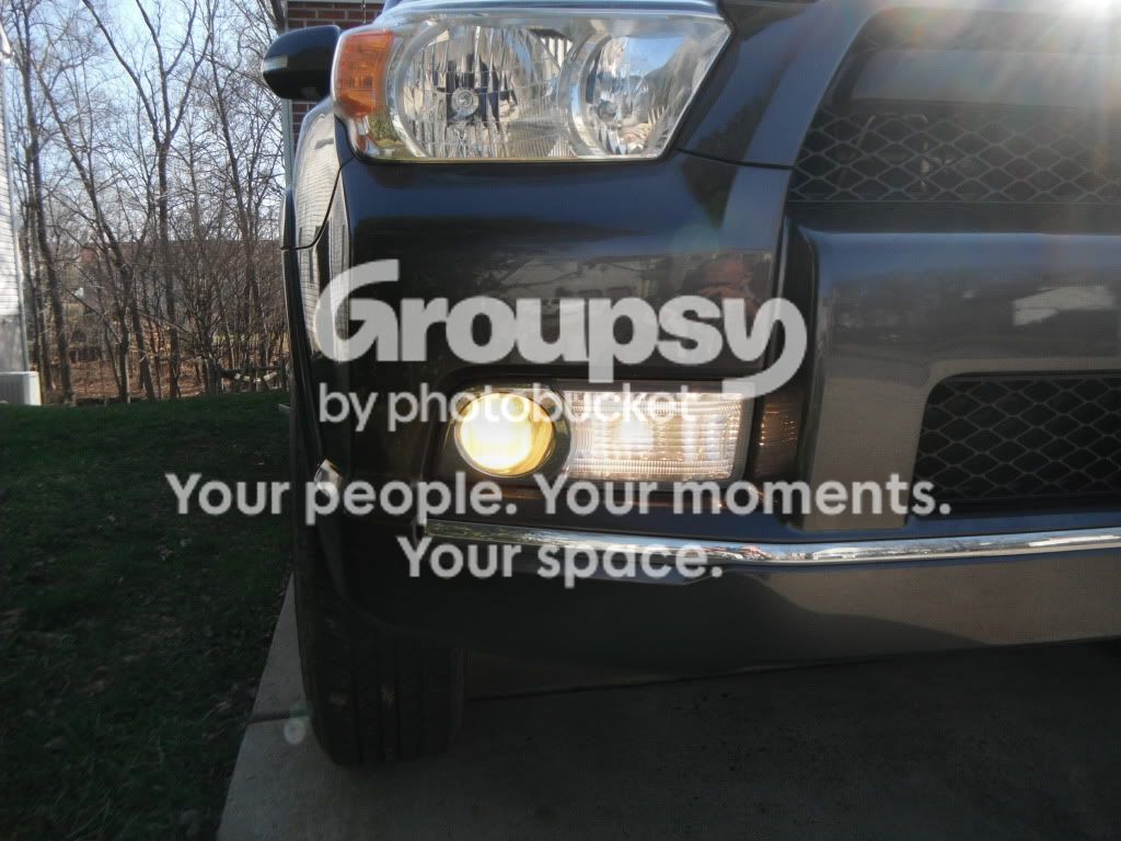

Everything works like it did before. Fogs are totally independent. Turn signals work perfectly. The DRL's are on whenever the truck is running : **BUT** When you turn the fogs on, the DRL's turn off ; when the DRL's are on, the fogs are off. And, it all happens automatically.
Yellow or white, can't have both!

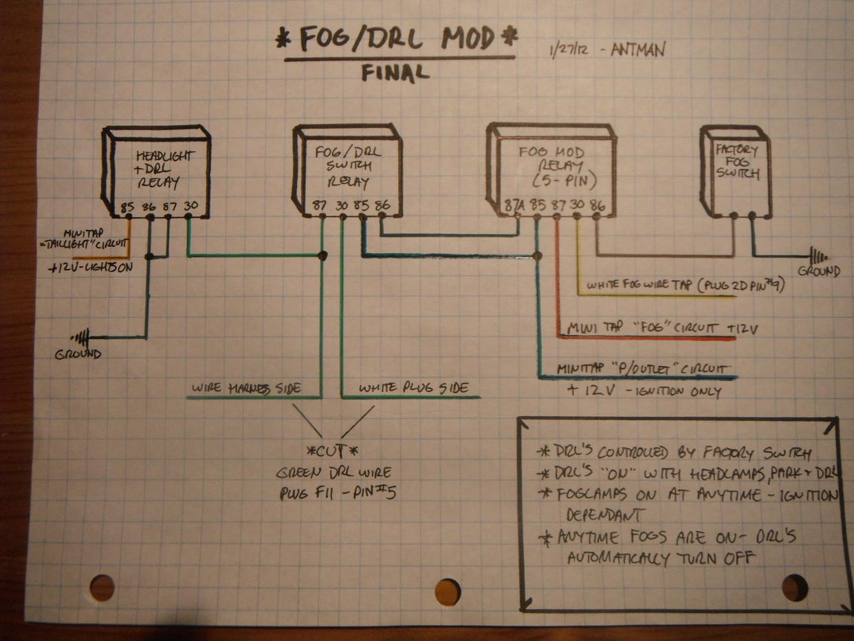

Basically, the DRL's are turned on by grounding this green wire.
The factory wiring provides this ground when the switch is set to "DRL", or "Parking Light" only. If you ground the green wire with a jumper, the DRL's can't be turned off with the factory switch. I got around that by only applying an extra ground (via relay) when the taillights are on(meaning the head, and or parking lights are on). To make the DRL's turn off when the fogs are on, the entire circuit is cut (again via relay). This same circuit is normally closed (via, um...relay) to allow the DRL's to function when the switch is set to "DRL". Now you know why it took me a few days. Yes, it is confusing!
To make all this stuff work (at once) requires 3 separate relays, 13(!) different connections, and alot of patience to make the wiring look neat and clean. But, it's done. It works perfectly, and I win... :flipoff: That said...

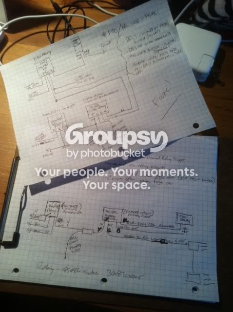

I am planning on drawing up a wiring diagram(no way you can figure out the one above- it's written in Antman :wow:) and posting it soon. I'll snap a few pics of the area where the relays are mounted up as well.
I'm a geek, I know. :nerd:
Happy Modding guys!
EDIT- Wiring diagram here, and a few posts down as well...
