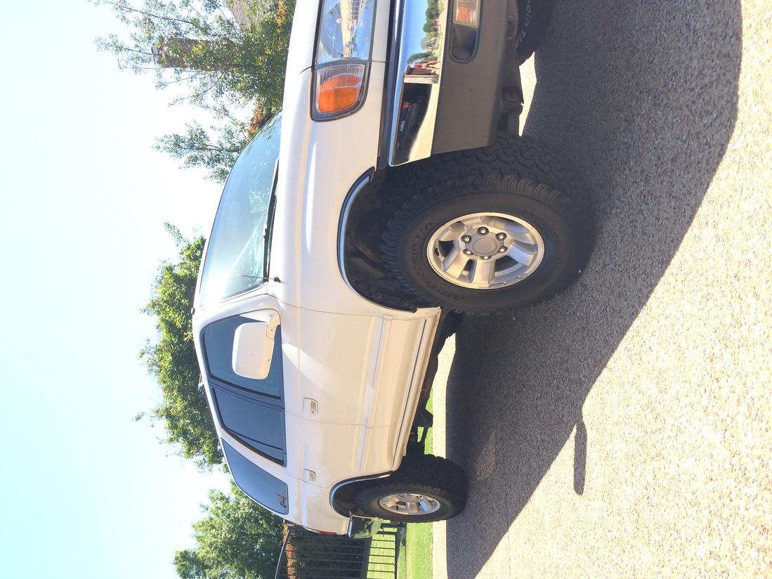

Hey y'all, just recently I put brand new 31 BFG A/T on my 4runner and removed the running boards which helped give it a more aggressive look, now I'm wondering what I should do next, I've debated getting new,brighter headlights and maybe even adding extra ones to my front end with an auxiliary switch, I have Also debated getting rear taillight cages, or maybe getting a 2 inch lift, basically i am asking for any opinions on improvements that would help advance the look or function of my 4runner.
Thanks for your help
-Eric

brighter headlights and maybe even adding extra ones to my front end with an auxiliary switch, I have Also debated getting rear taillight cages, or maybe getting a 2 inch lift.
You told yourself what you wanted. what do you want to do with it is the real question. Are you out in the dark a lot? get fog lights.
Rear taillight cages are based on opinion, I don't like them, I don't think they'll actually protect anything.
2 inch lift, would be bad timing because you JUST bought new tires and should of upgraded if you got a lift.
Don't get brighter headlights unless they're HID. I bought some ultra bright headlights and they didn't do a damn thing. Go buy some plastic dip and have fun. Bumpers, emblems, grill.
Or you can take your mod money, save it, then take your future mod money, save it, then buy sliders. or a front bumper. All based on what you want it to do.
1) trans cooler. 2) Fluids. 3) tundra brake upgrade.
A trans cooler is a great option, although not really needed. Now, if you're going to be towing something, then I would go this route. I know this is a much debated conversation, and others will have different opinions.
I agree with the maintenance side of things; fuel filter, air filter, plugs, wires, and so on. Check your LBJ's and TRE's to see how they look.
I say maintenance first. If you plan on lifting you'll have to do some suspension work anyways. Don't skimp on the HIDs.. either do it right or not at all. Putting HIDs in halogen housings is not cool.
Didn't like the white out on a white truck? I think that would have popped. Does your spare match now? Maintenance and fix your antennae.
If you are over 140K miles I would do lower ball joints, radiator, trans cooler, and a OEM timing belt kit if not done yet.
Then go lift it.

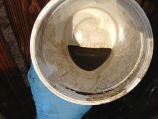

1) Speedbleeders Speed Bleeder Bleeding Brakes Bleeding Motorcycle Brakes Automotive Bleeder Screw Brake Bleeder. Makes brake flush a pleasure 2) Fluids 3) Grease 4) Trans cooler or new radiator 5) TBU (tundra/sequoia brake upgrade) 5) Lower front ball joints 6) Timing belt, mileage dependent 7) Steering rack and end link bushings 8) A Brazilian, i.e. Clay bar and synthetic wax. Ohhhh, so smooth.
