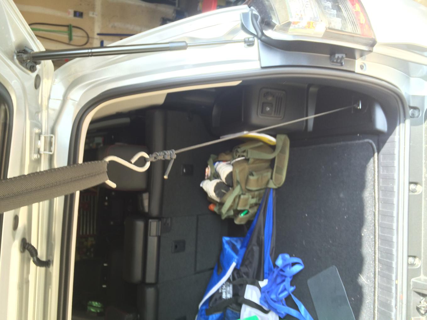

Did this for Wife's new 2014 Trail Premium with the same problem. Except I used a hook. I open, reach down and grab the hook and hook it on the hand pull loop. Problem solved. Might look around and see if I have an old weapons single point bungee sling I can butcher and make something I don't have to hook.

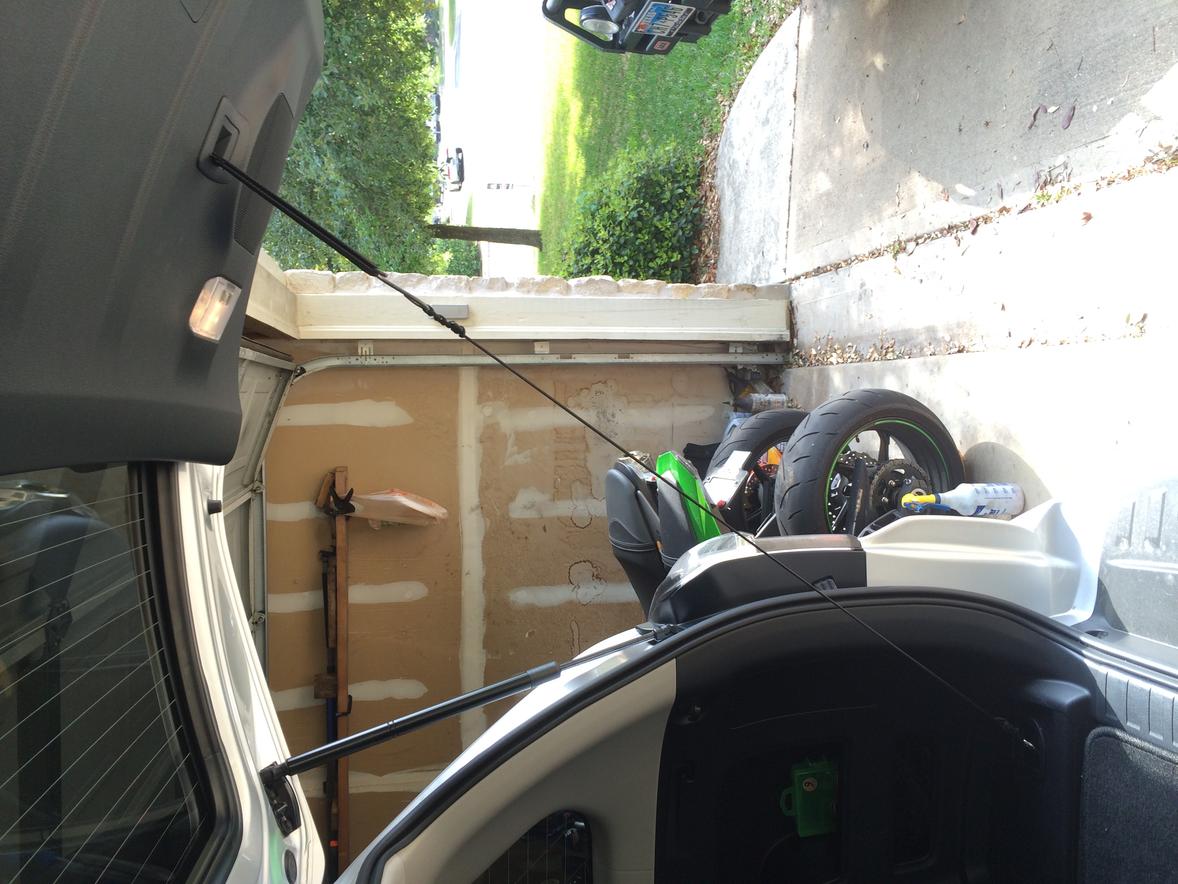

Couple pics if they come out right...
