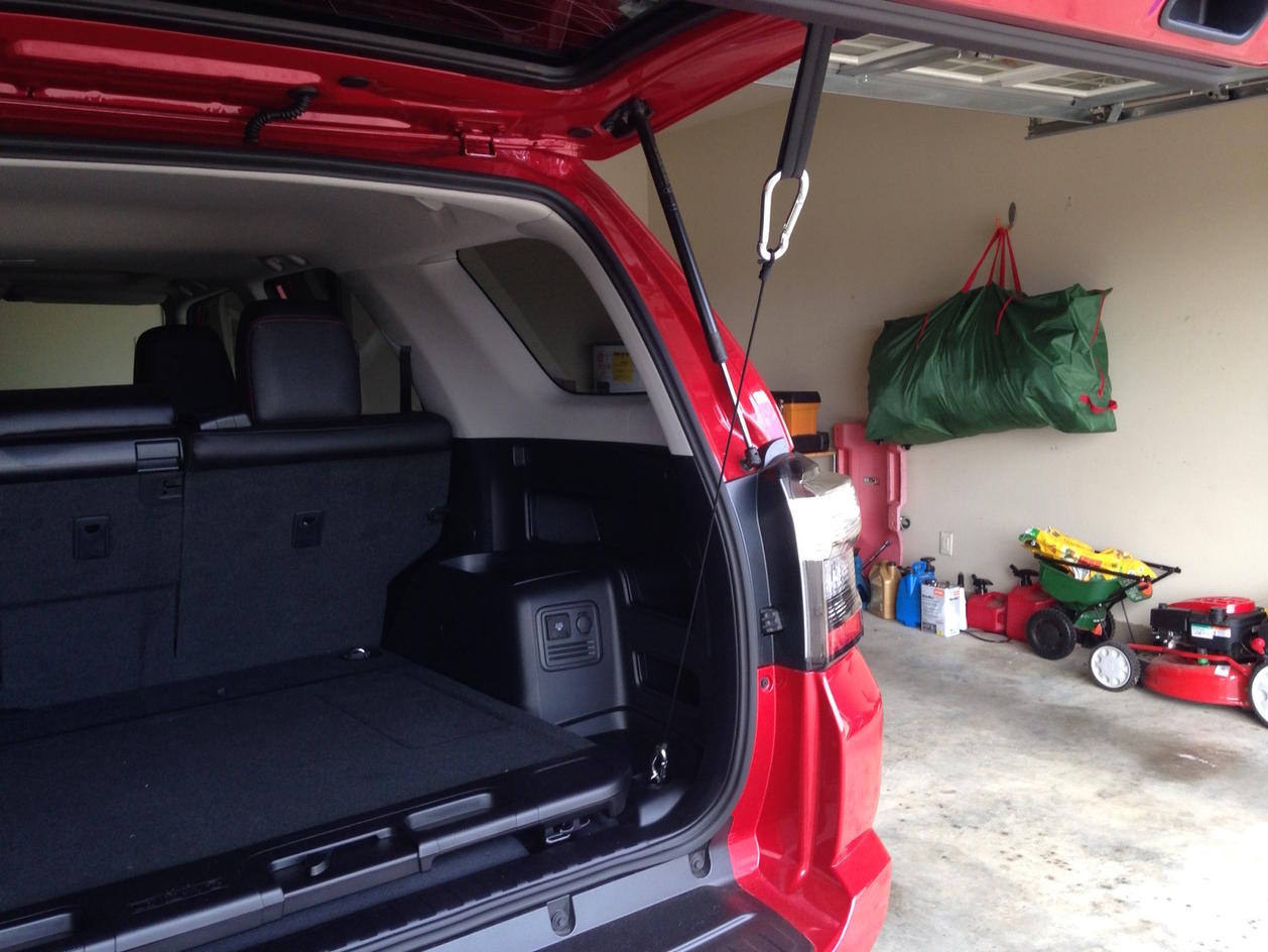

Solved problem with 2 bungee cords, one for each gas strut. Simply hook to gas strut at top attachment bolt and bottom attachment bolt on each side. May have to play with length of bungee but it will stretch out to it's max length and holds liftgate perfectly to your adjusted height and even reduces the force a little bit when pulling it back down. Great for a shorter elderly type person... Also, because it stretches back down in length when closing, it won't get caught in your rubber weather stripping. Just my 2 cents worth...
Thanks for the idea. 550 paracord at 11 cents/ft is hard to beat. Although I wish I was as good with the knots as [MENTION=77958]Zeusmotorworks[/MENTION].

I need to do this, my garage has pipes hanging down and the lift gate would hit one if I let it up. I have hardly ever opened my lift gate, when I do, I have my wife hold it from hitting the pipe.
For what it's worth, my right liftgate strut went out at 31k miles. I suspect it was due to this "mod" of having the paracord/carabiner arrangement to limit travel. I'm wondering if the struts aren't designed to stay suspended at reduced travel. Not a big deal, but just thought I'd add this info for future reference for anybody referring back to this thread. That there's at least a possibility of premature strut failure.
I doubt your paracord did it, there are a few threads here with people who've blown them at low mileages. They're probably just cheaper than they should be, considering Toyota has replaced quite a few under warranty.
