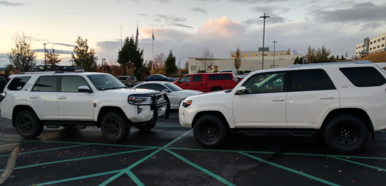

Parked next to another 5th Gen at work that was stock except for the new rims. Mine has a 2.5" lift and Cooper Evolution MT 285s which are listed at 32.9" tall.
