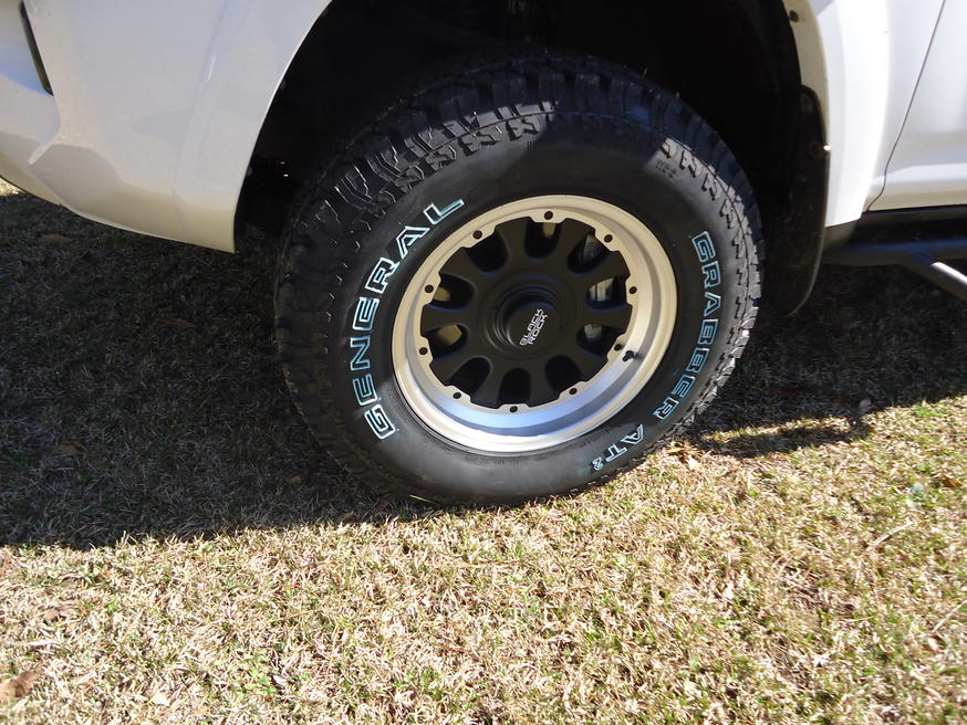

55,000 miles later I'm going to say no. I did have a concern with whether they would clear the brake calipers because of the way they are machined. Very close clearance, but they do fit. Hubcentric was not a problem. I opted for the titanium ring finish. I will admit that hasn't held up to off roading as well as I'd hoped. The black centers are holding up fine, but what looks like clear coat around the titanium finish is easily scratched and peeling.
