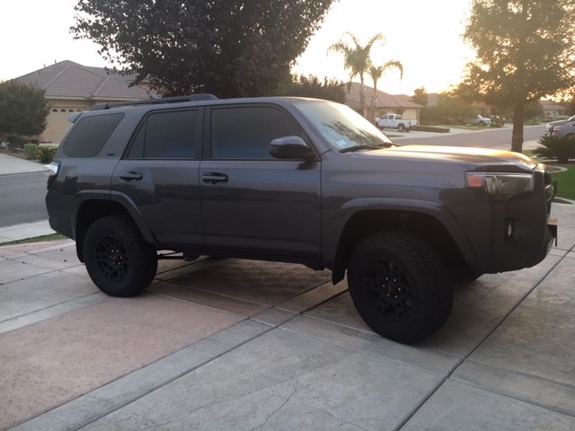

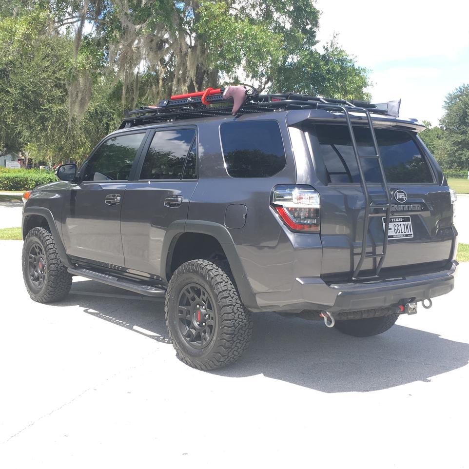

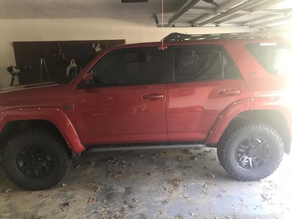

couple of quick pics after i installed 2" superflex rear springs last weekend (5100 rear shocks)
front is just 5100's set to 1.75" for now, I'll be installing the Toytec adjustable spring kit with JBA UCA's soon tho for a 3" front lift.

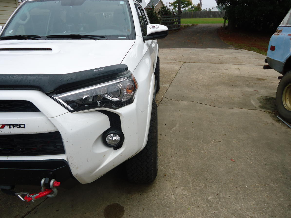

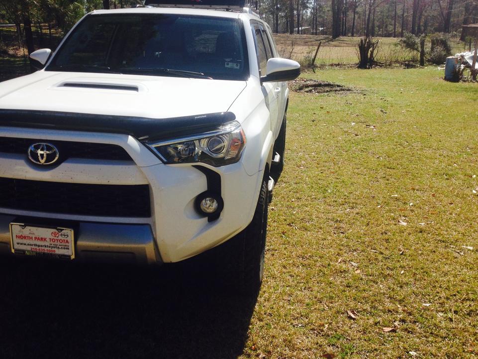

This may be better. These are pre-Bushwacker, but the flares only add about 1/2" of width. Before and after spacers.

Only 2" here but I do have the Spidertrax and 265/70 Grabber AT2's. The top picture is unloaded. The middle picture is after adding 140 pounds of CBI bumper and losing about 3/4" due to the weight. The bottom picture is a rear view showing what the spacers did with my 8" wide wheels.

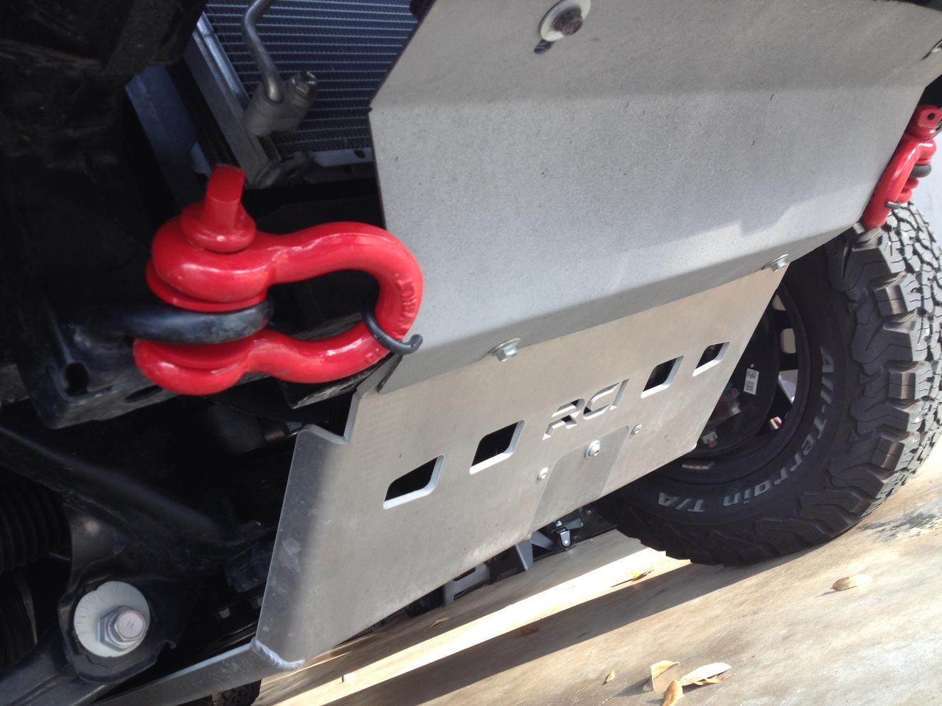

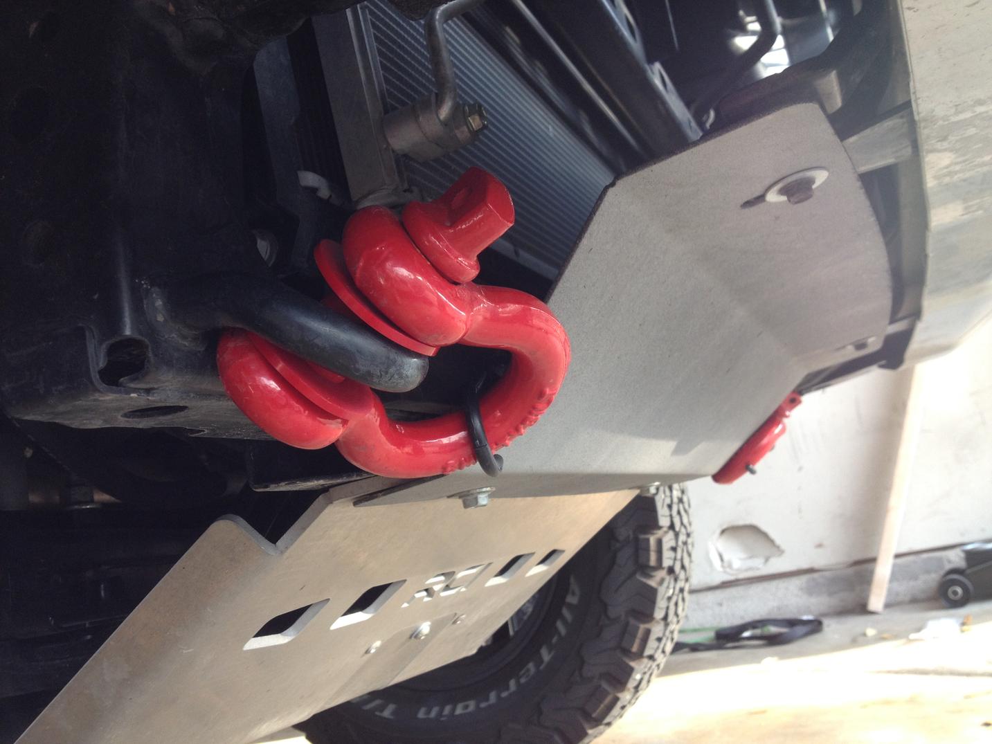

Can you take a pic of where you put your shackles?
I've since taken them off, but i did manage to find an old pic.
they're held up with a bungee cord behind the RCI filler plate.

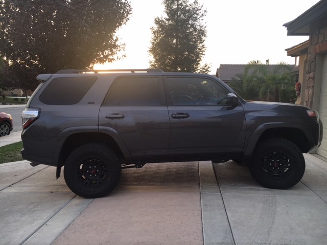

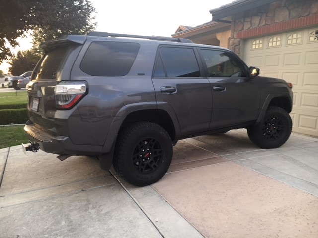

2016 5th gen SR5 265/70/17
Front Bilstein 5100 @1.75", 1" Cornfed rear coil spacers
TRD PRO Wheels, Toyo Open Country Tires

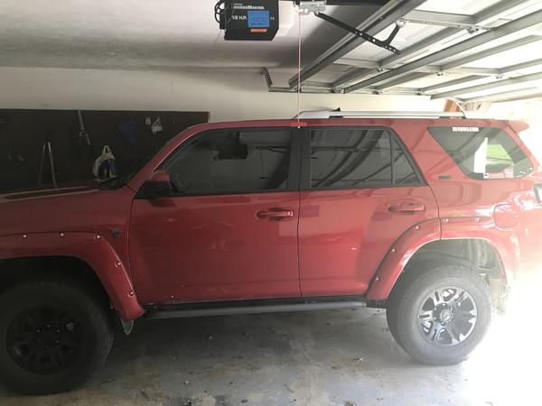

Top Pic - Before
Bottom - After 1.5" Revtek Front, stock rear
Leveled today with Revtek 1.5" Front. Went up a lot higher than expected as I thought it was going to be even to maybe a slight rake. Well, to me it went a tad bit too high on the front for my liking, so I think my next step is a Cornfed 1" rear which will go in likely next week or whenever it arrives.
Stock tires and I think Ill keep it this way until new tires are needed. But since its a LE, Ive got some big skinnies on (hate it, but oh well - I like the wheels, hate the tire size for now).

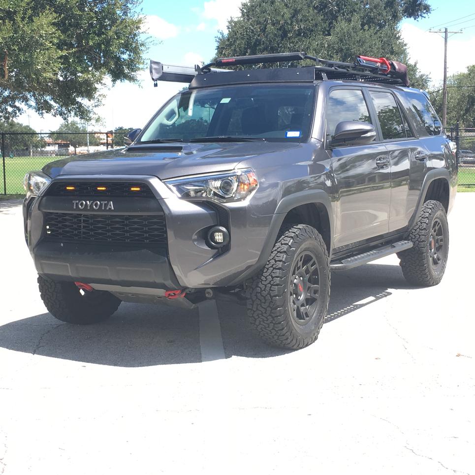

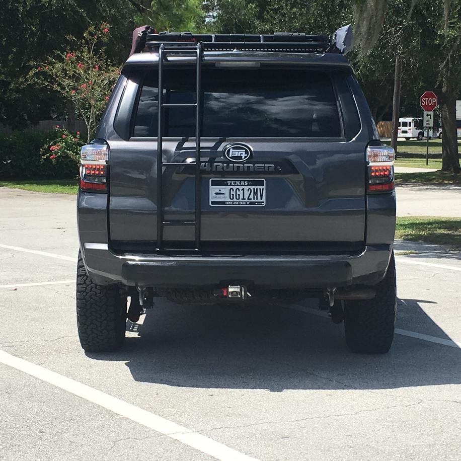

Here's lifted with OME springs and 5100s, front set to first lifted setting, with stock sized Nitto TG2s.
Here's same lift with 285/70/17 KO2s.

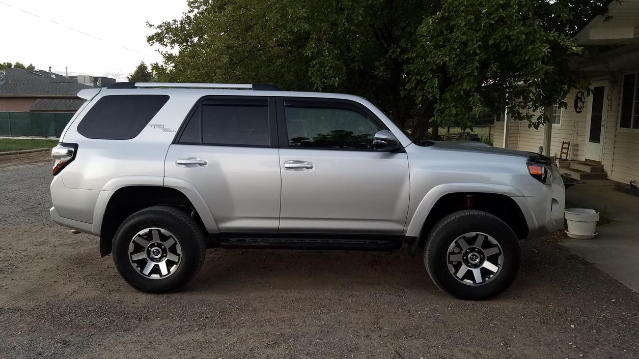

Lifted 2.5 with Toytec Ultimate. Stock size 265-70-17 tires. I like the look okay.
