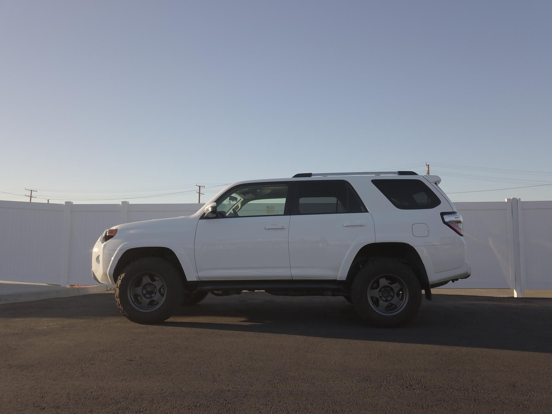

This is what my 4Runner looks like at the moment:
My friend and I installed a Toytec 3" lift kit on it with heavy duty spring so it's currently sitting about 5" higher than it used to. New wheels and tires are on the way as of today.

Wow thats a lot of lift! How long did it take you to install?
It’s artificially high. I bought my kit with heavier springs to accomodate future modifications. By the time I’m done adding weight to it the truck should end up sitting 3-3.5” higher than stock.
Initial installation took about 9 hours. I had the benefit of access to a lift (and the lift’s owner who was really the lead installer, I mostly did what he told me and took care of the ancillary stuff) which made things significantly easier. If we had to do it on just jack stands I’d estimate another 3-4 hours and getting the new springs into the rear would have really sucked. As it was we ended up employing spring compressors, jacked the opposite side of the suspension up and I applied downward pressure on the brake disc while my friend guided the spring home.
Post install i drove it straight to a tire shop for an alignment. Anyone considering a lift should plan this into the installation because the lift will definitely alter your front suspension geometry.
Finally after giving the new suspension a day or two to settle we adjusted the front coil springs to restore the ~1” factory rake which means that the truck won’t “squat” when loaded.

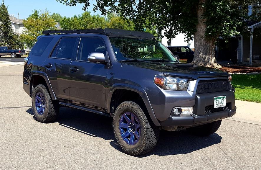

Bilstein 6112s (6th clip) and Dobinsons C59-599 rear springs with 5100s.
Rears I'm getting 1.5" instead of the 1"ish advertised. Working with Dobinsons to figure out the issue.
stock sized Falken wildpeaks
Did you ever get the 1.5” vs 1” figured out and settled? I’ve been reading in the Dobinsons forum about others netting greater lift in the back than advertised...

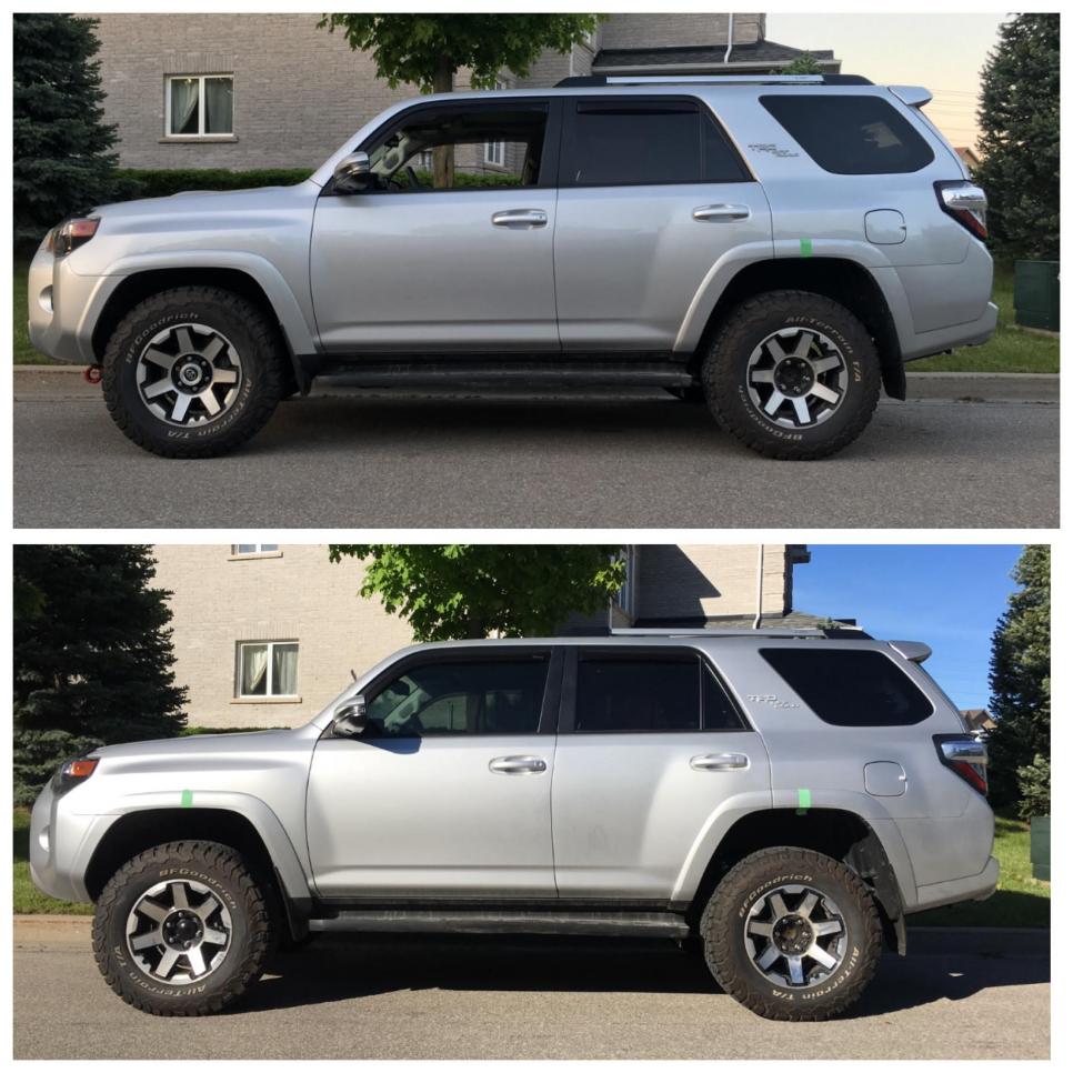

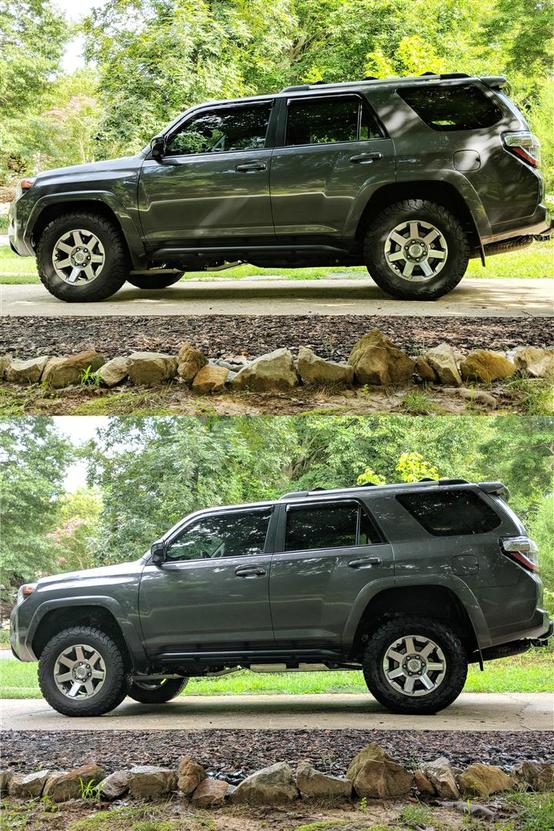

I had Toytec BOSS 3" front 2.5" rear installed. Am going to keep my stock sized KO2s.

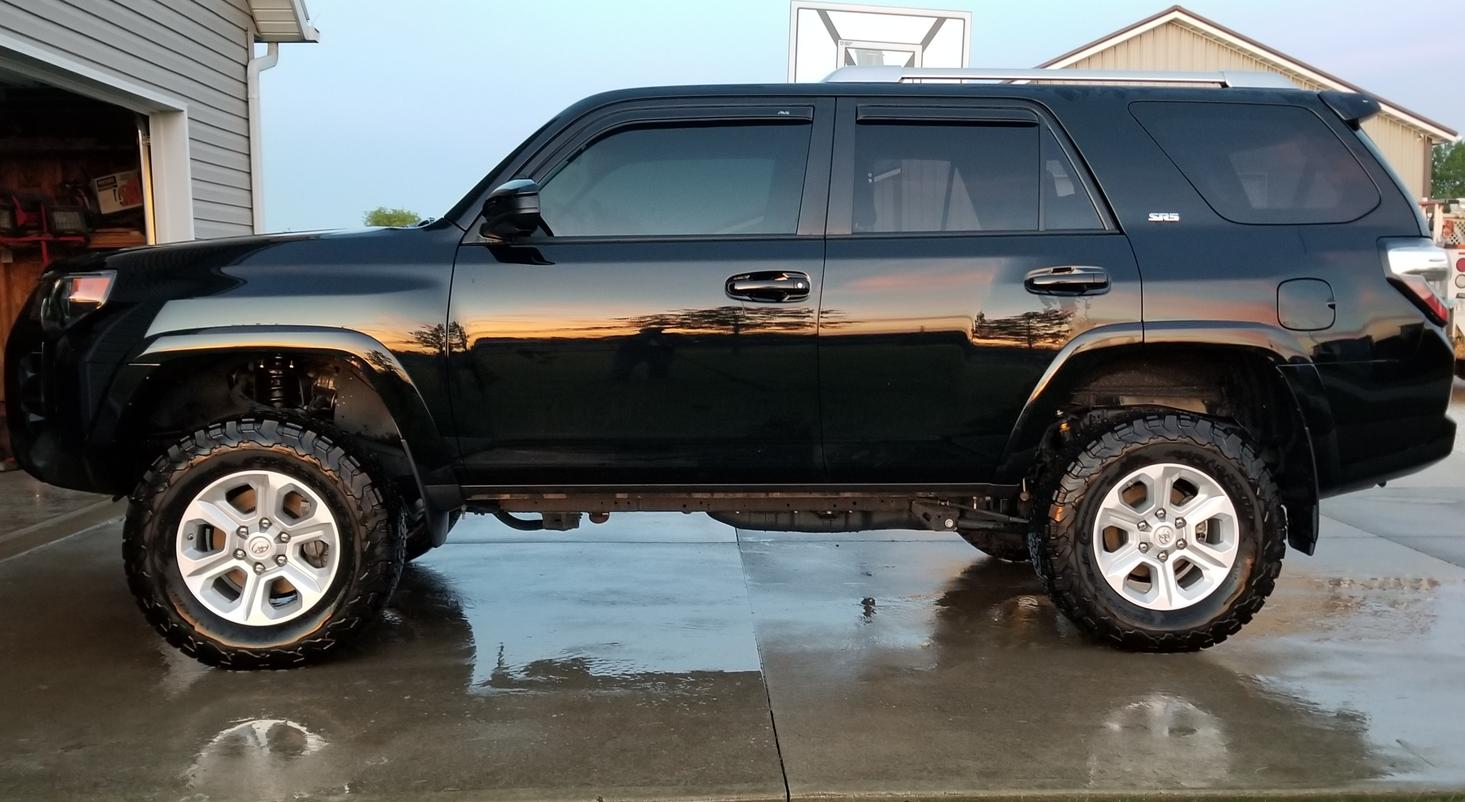

5100s 1.75 up front with wheelers top plate spacer for maybe 2.25? Lift. Wheelers T13 springs in rear. Stock size tires.

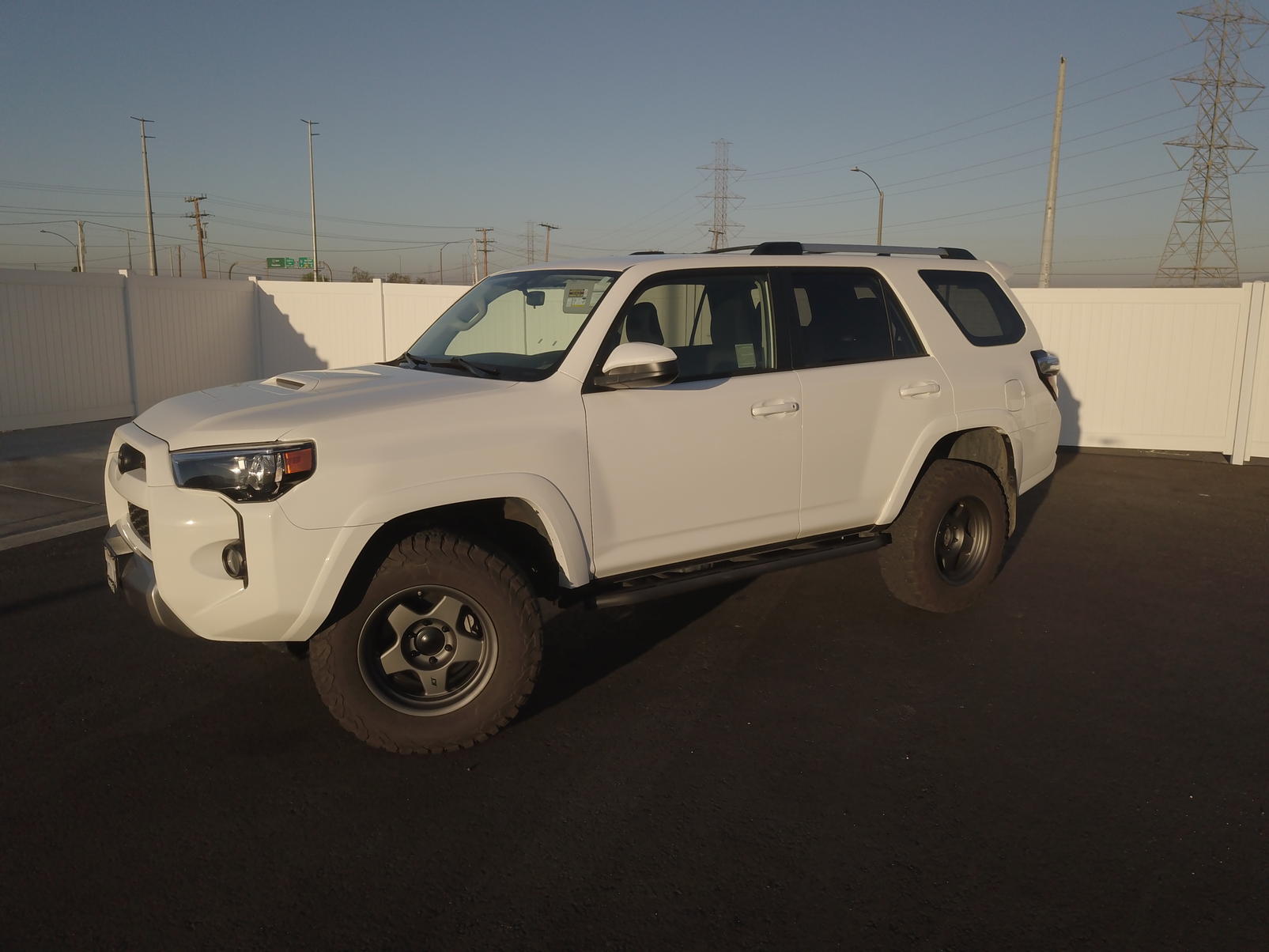

Bilstein 5100’s front and rear. Fronts set to 1.75”, Eibach 1” rear springs, SCS F5’s and 265/70r17 BFG KO2’s.

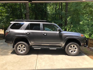

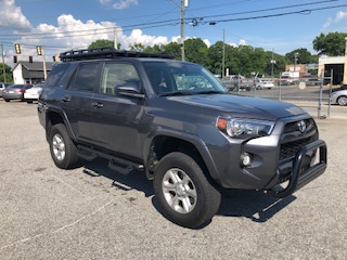

In case anyone is looking for more recent pics of a 3” lift with stock wheels and tires. 2019 SR5 4x4. I do plan to put bigger tires on once I get some good use out of the stock tires. 3” isn’t too drastic so the stock wheels and tires still look okay.
